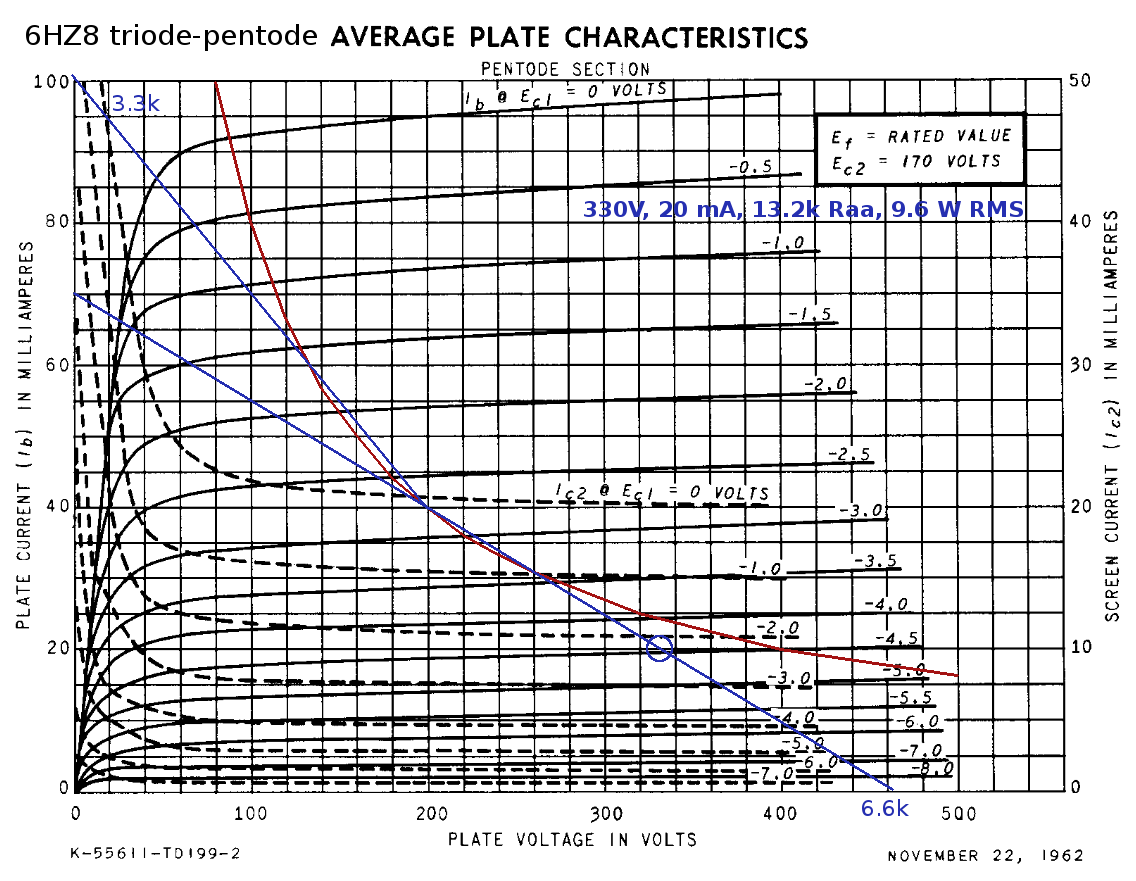

Having grown up with transistor electronics, it never entered my head until a year or so ago, that valve guitar amps have high output impedances....was surprised to find out that guitar amps were so much higher...
Once I realized that, it occurred to me that I could take the anode impedance of the output valves, step that down through the output transformer, and so get an idea of the amp's output impedance.
So I drew straight lines on a set of 6V6 characteristic curves, and from the slope, estimated 54 kilo-ohms anode resistance, with the valve operating at fairly typical guitar-amp conditions (350 - 400 volts, around 30 mA). Pic attached.
Taking an 8 k: 8 ohm push-pull output transformer as typical, that's a 1000:1 impedance stepdown ratio. But one valve sees only half the primary, so that's a 250:1 impedance ratio (impedance ratio is turns ratio squared, half the winding equals one-quarter the impedance.)
So if we now take 54k and divide by 250, we get an estimated output impedance of 216 ohms.
If we remember there is a second 6V6 on the other end of that OT primary, and both 6V6s are operating for small signal swings (class AB), that drops to 108 ohms. Still shockingly high.
It turns out that my quick-n-dirty calculation is still off by a factor of two, and the real output resistance is around half of what I calculated. Printer2 measured about 50 ohms on two smallish guitar amps, and so did you.
I don't know why there is a factor of two error (actual guitar amp screen voltage much higher than screen voltage on the characteristic curves I used?), but I'm happy the quick estimate at least got to the correct order of magnitude.
