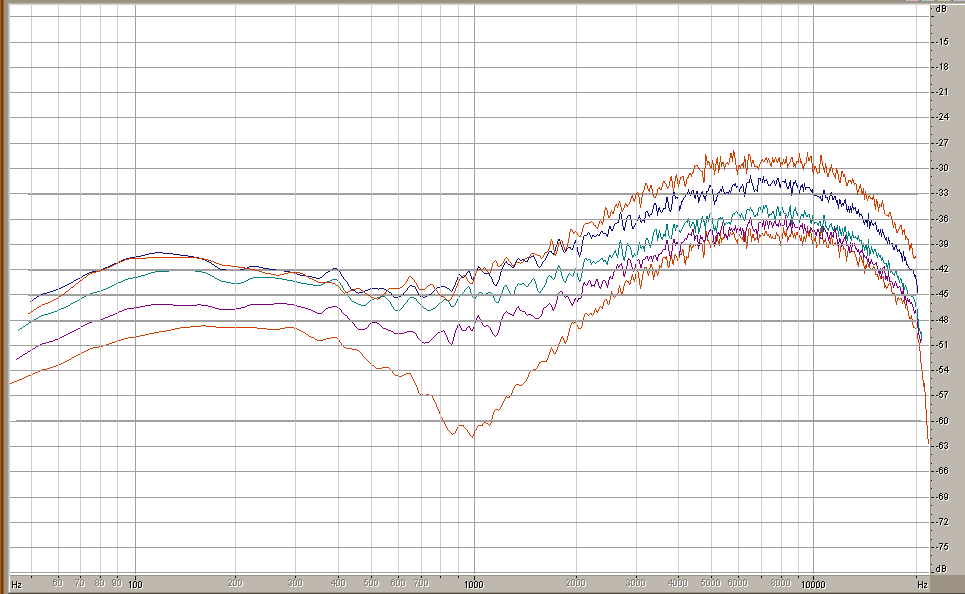

Next step is to check the frequency response of the tone controls and compare to the simulation. I tried to use RMAA but it will not let me record each new setting of the tone controls at the same volume setting. So I used Adobe Audition, recording a white noise sample through the preamp. I've used this program for this kind of analysis before and I believe it does a better job than RMAA.
Here is the combined response:
Gain at ~25%, volume set to ~50%, each of the tone controls advanced equally - 0%, 25%, 50%, 75%, and 100%. The same as I did in the simulation in post #9. The Bright switch is 'on'. One difference from the simulated response is that I'm using a 10K pot for the High tone control, when it is supposed to be 25K (I don't have a 25K pot on hand yet).
Overall, not a bad match. Some good variability in the tone settings, with more than 6db for each.

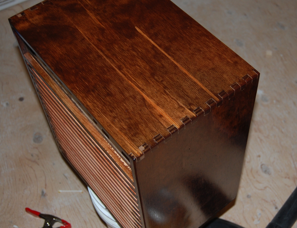

The cab it went into is G1S plywood, finger jointed at the corners:
Special walnut Minwax stain plus a few coats of tinted satin urethane.

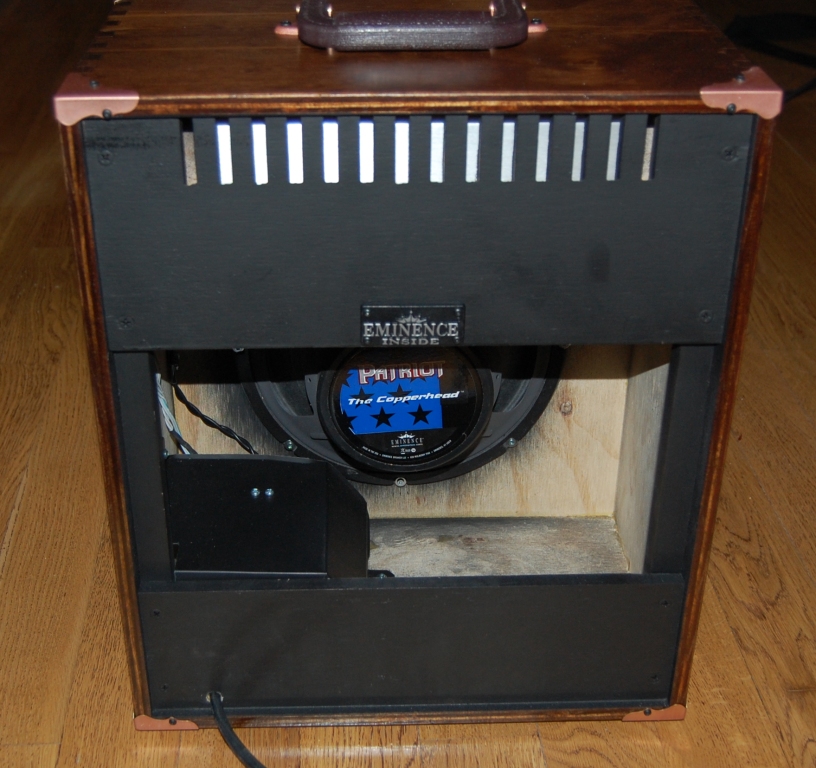

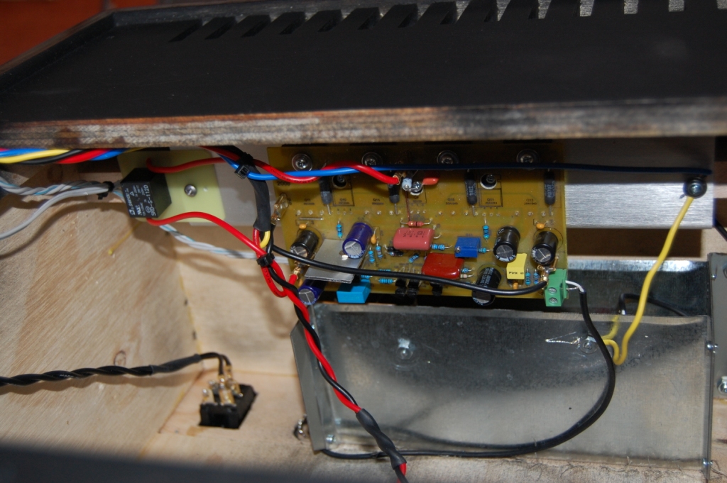

Peek at the power amp:
an older Patchwork module that I lowered the gain on and bumped up cdom to a wopping 220pF to make it run stable at the lower gain.
Also seen is the sheet metal preamp enclosure which seems to make a big difference to the amount of noise pickup.
Off to the left there is a relay that completes the circuit to the speaker. It is delayed by an RC timer on power up so the speaker is not 'popping' from the supplies coming up. It releases immediately when the power switch is turned off to cut the speaker out so it doesn't make those annoying noises when the supplies drain.
The power transformer and supply are under the black sheet metal cover:
neat and tidy.
neat and tidy.
