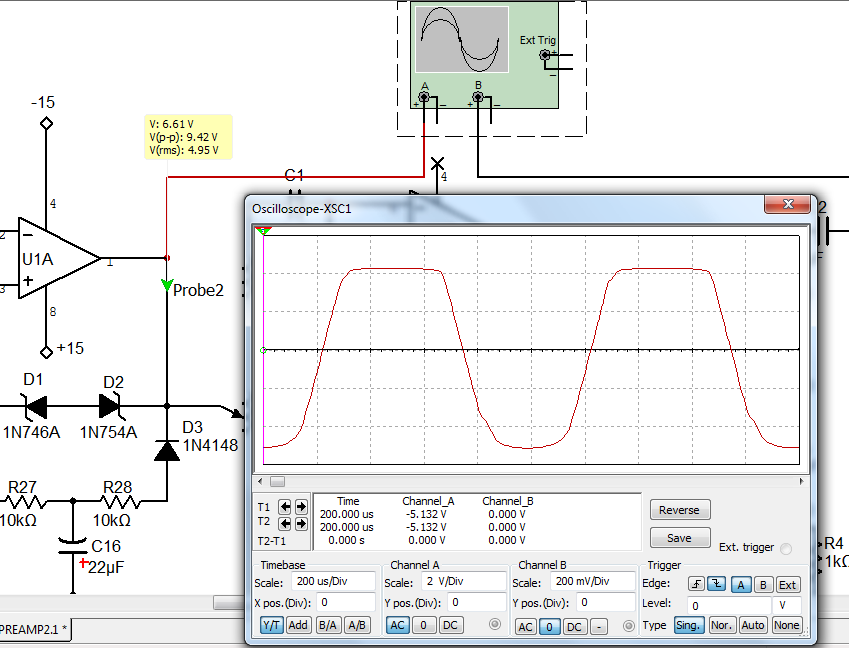

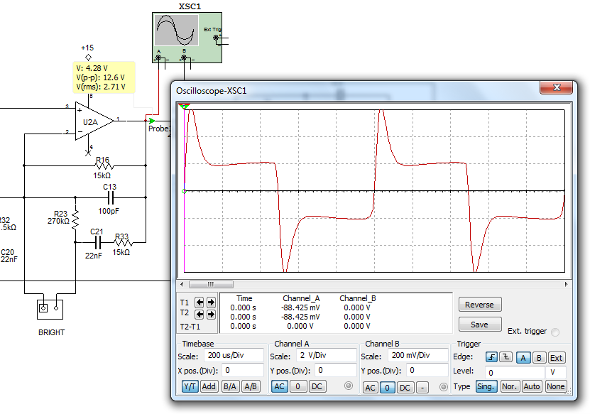

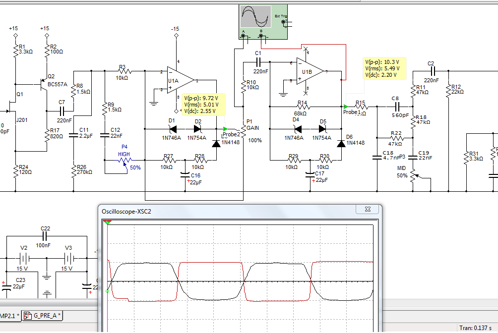

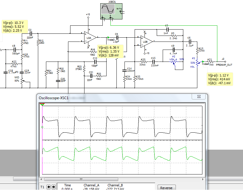

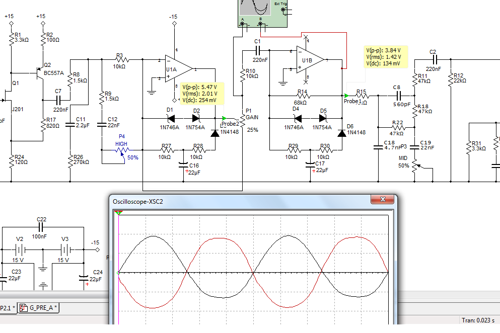

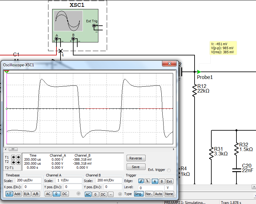

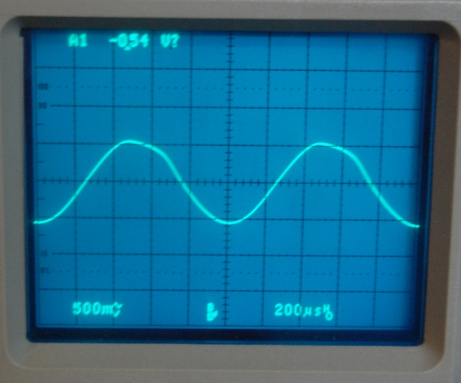

Next try ... an assessment: The power supply is perhaps too weak. The roofs of the rectangle is a break.
I think I understand now :)
The power supply I'm using is THIS one and believe me, it's not too weak. Set to +/-15VDC up to 2A current.

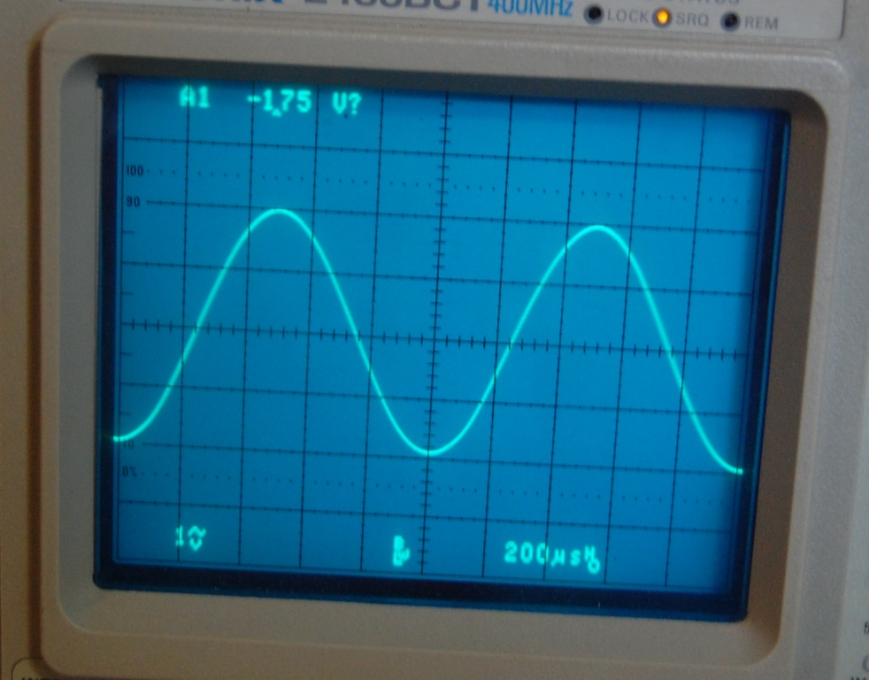

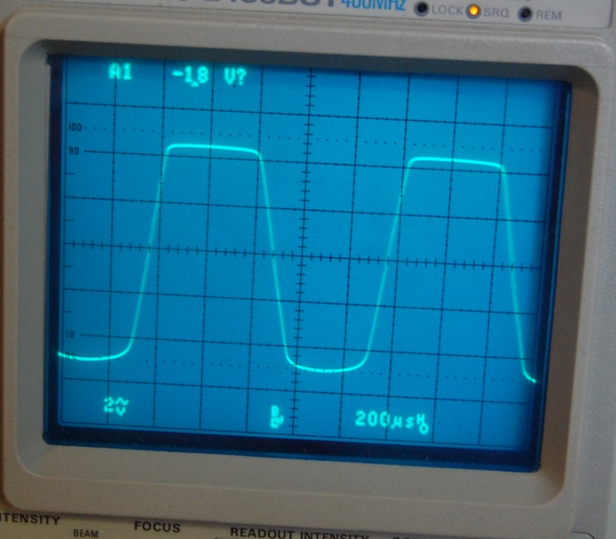

If you are looking at the clipping in post #13, it is supposed to do that. That is diode clipping, not power supply.
I believe you :)
And yes, I did realized that the diodes limiting the signal. ;)

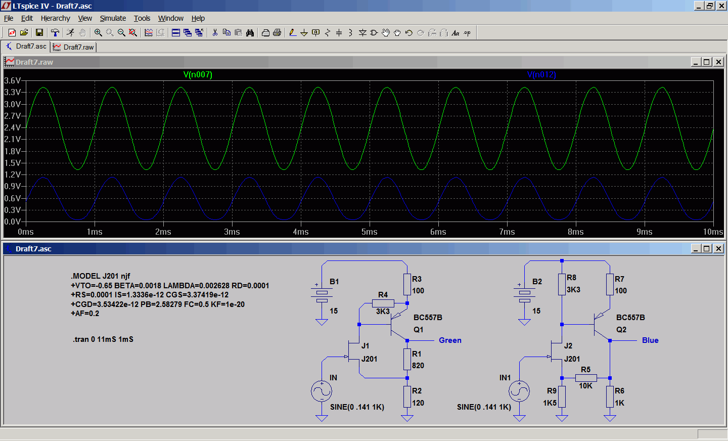

But have you ever tried to simulate the circuit with a weak power supply? It's amazing what happens to the signal when the circuit operates in the border range. I simulate the most of my circuits with LT-Spice (Linux and wine).

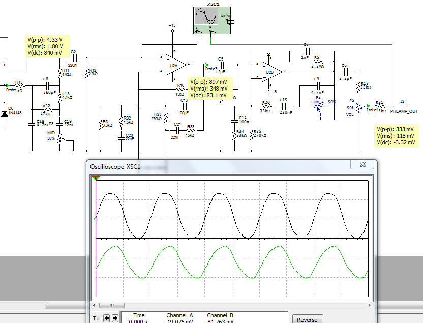

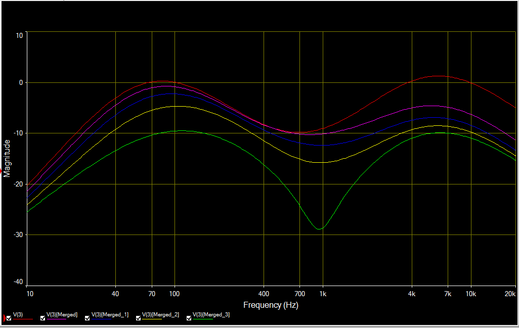

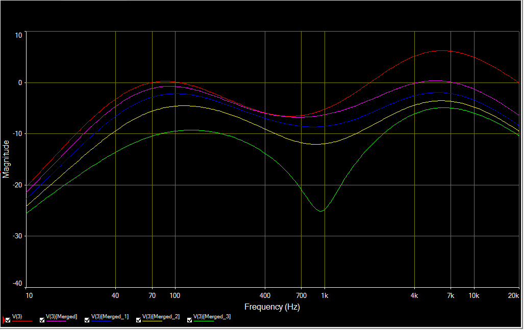

Next step is to check the frequency response of the tone controls and compare to the simulation. I tried to use RMAA but it will not let me record each new setting of the tone controls at the same volume setting. So I used Adobe Audition, recording a white noise sample through the preamp. I've used this program for this kind of analysis before and I believe it does a better job than RMAA.
Here is the combined response:
Gain at ~25%, volume set to ~50%, each of the tone controls advanced equally - 0%, 25%, 50%, 75%, and 100%. The same as I did in the simulation in post #9. The Bright switch is 'on'. One difference from the simulated response is that I'm using a 10K pot for the High tone control, when it is supposed to be 25K (I don't have a 25K pot on hand yet).
Overall, not a bad match. Some good variability in the tone settings, with more than 6db for each.

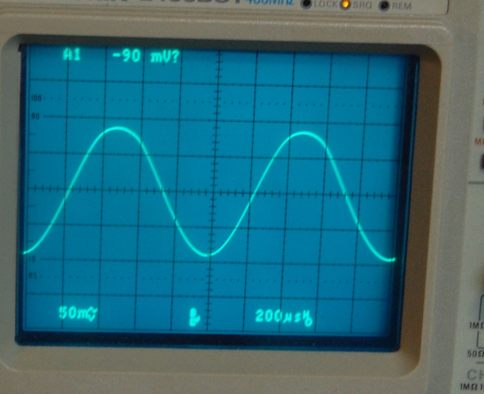

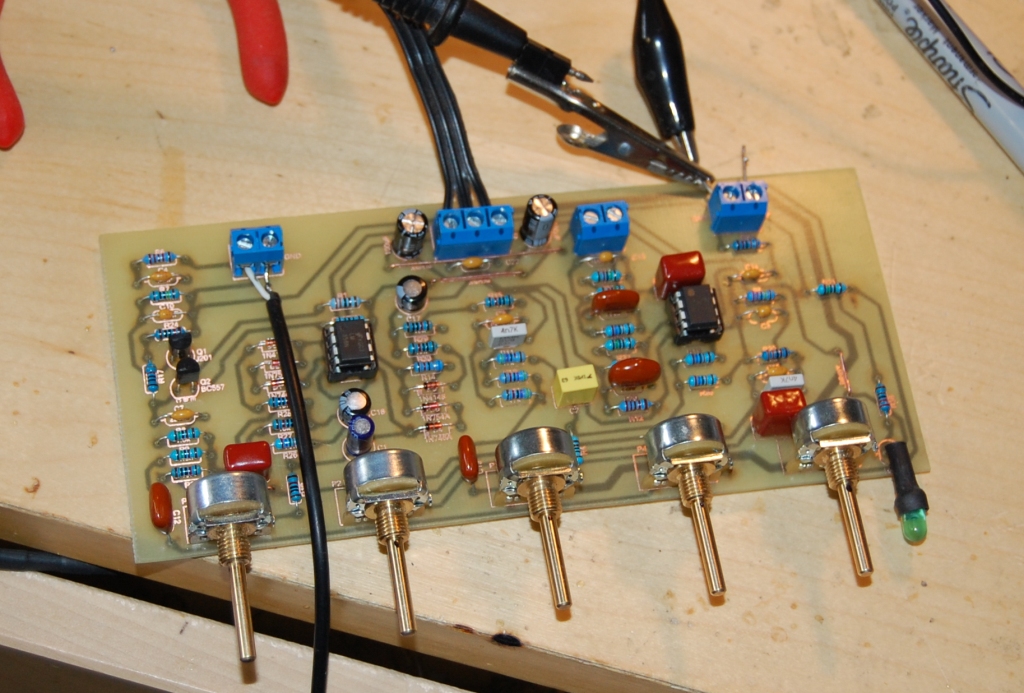

I spent most of the day yesterday either measuring and listening to this preamp. I'm now satisfied that it is performing the way I intended.
I made a few small changes:
Added a 47pF cap from the gate to the source on Q1.
Increased the gain of the input stage to ~10. I did this because I reduced the gain of the second stage by adding a 100K resistor from the wiper of the 'gain' pot to its low side. This effectively cuts the value of this pot in half (from 100K to 50K) and gives an approximation of reverse audio taper. My listening tests and measurements said that this was a worthy change, giving unclipped signal up to ~50% of the pots travel.
With an input signal of 100mVrms, the output with all controls maxed is ~1.8Vrms. At first I thought this might be too low, considering that the maximum gain setting for 'clean' is 50%, but having driven a power amp/speaker combo, I can say that I was mistaken. Still lots of volume on the clean setting.
The tones really have broad effect and tailor the sound very well. I was on the money concerning the midrange null - very good effect with high at max and the bright on.

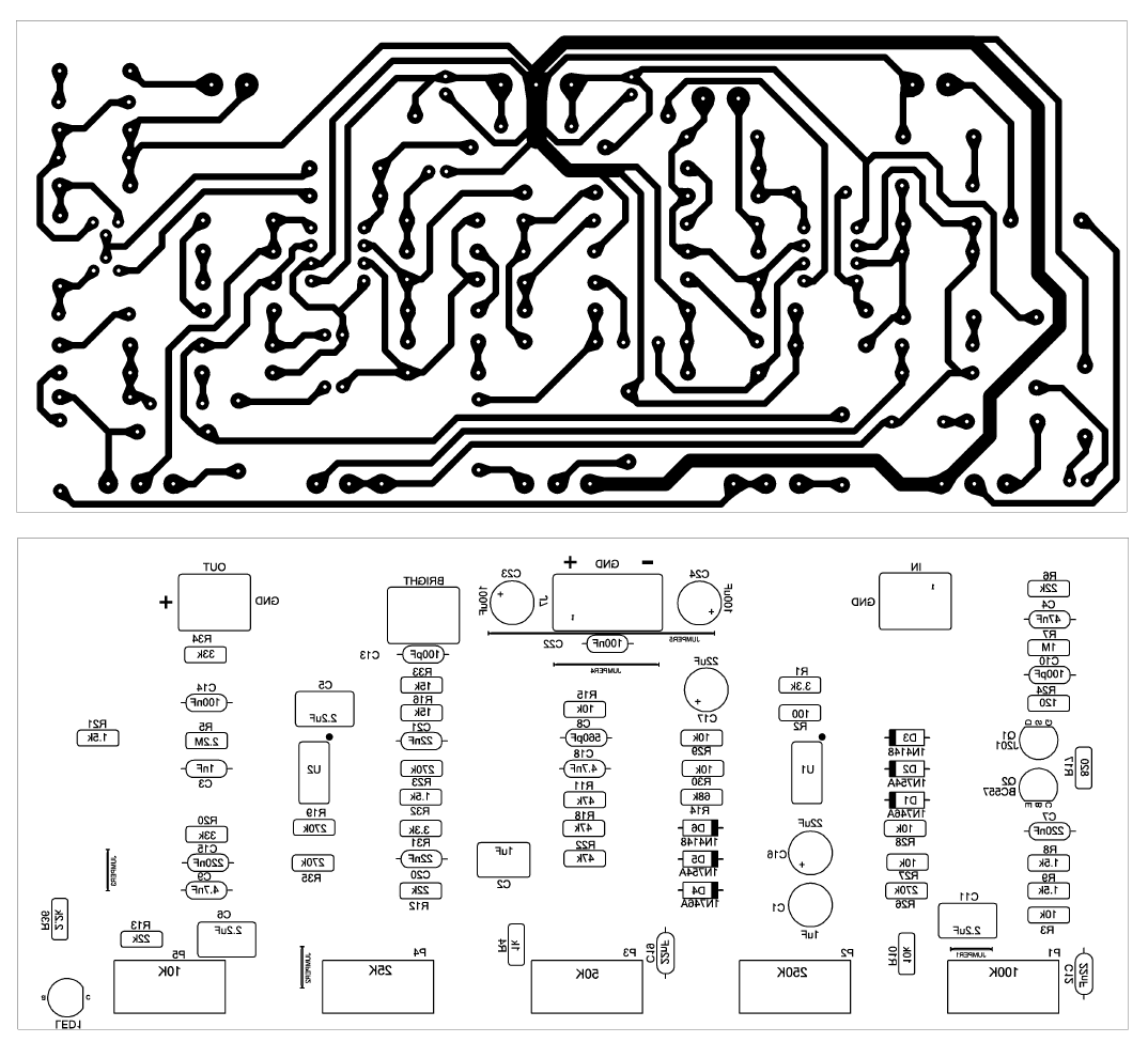

I'll post the final schematic shortly. I need to make a couple of changes to the board layout and then I'll post that too, for anyone out there in TV land in need of a very righteous preamp.

Do you have a PDF file to print? I need the dimensions of the circuit board.
Soon, it's not done yet. I need to include the changes I made when 'voicing' the preamp.
