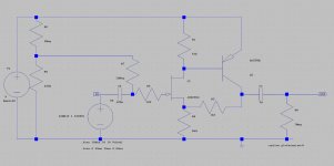

The BS170 circuit looks like it would work in a very similar way in principle. It is a different type of FET, a MosFet rather than a JFET, and I have not tried them. The input impedance is 500k, which is Ok, but if you change the 1M resistors to 2.2M it will work the same and have a better 1.1M impedance. C2 looks like it may take the edge off the treble. Id leave it out or reduce it.
I know it's a MOSFET, as I said the FETs are the ones almost impossible to get here. BS170/2N7000 are available and cheap...too bad they do not sound as, or are as useful as the J201, 2N5457/58/84, MPF102, NTE458, 2SK362, etc...

"I killed" 3 TL071 doing the MXR Headphone Amp (2 on breadboard!), so those, the BC54x and BC3xx type transistors have to be most delicate components I encountered so far (again died even on breadboard without even fiddling with them).
Hey, tell me how it went with this d... circuit. See if you have the same effect that I had (I described it in my last post)...

Well, I figured out what was wrong with my circuit. I included the optional Rp input resistor and I didn't pay proper attention to it's value. I can't read colour codes and putting it on the meter gave me what I thought was 1M - it wasn't 1M though, it was 100 ohms.
I bought the components from a local shop ( I live in Spain by the way ) - and I must have mistranslated the value into Spanish.
I am an idiot....

Well, I tested a lot of preamps designs and I still have many to test, my findings are:
-Noise: opamps are the best, and still not good enough, next are Fets (I have a K362 which is an NTE458/J201 equivalent, but can't get them anymore..any JFET), and then, are the normal general purpose transistors and MOSFETS of which I tested 2n3904 BC546to549, 2N7000 and BS170, I forgot to test the low noise BC550C but I will. All those transistor have so much noise that are just useless, especially for amp modelling. (I test the noise with GuitarRig5 with a Van51 in rhythm channel, "HI GAIN" ON, "Crunch" and "Bright" ON, "Pre Gain" at maximum, "Post Gain" at 2.83 and before the amp, a "Skreamer" all at "noon". In Win and GR5 I use the minimun input gain that's still useable. For what I've seen in videos the noise I get with opamps is much lower than with an USB Guitar Link 1 and 2. My measure would be of how much negative decibels I have to put the GATE to get it to work, this is: no noise get through until I play louder than that value. Less negative value the more noisy is the preamp so -70 is less noisy than -50. And I get with opamps (TL071-72-NE5532) around -64 to -57 db, with MOSFET and common transistors -47 to -35... disastrous. All in breadboard)
-Sound quality: from better to worse: MOSFETS; FET; OPAMP; normal transistors.
-That damn bass slapping effect I have would be from less to more: mosfets; transistors (if I remember correctly) fets; opamps.
-Flexibility (potencial to be used in other configurations-other uses, in the easiest and less complex way) : OPAMPS; the rest. In fact one of the best I tested is a super simple TL071 based tone control (of many similar yet to test) that when decreasing the bass to minimun makes that slapping effect almost dissapear (and works very well attaching to it the selectable/optional cabsim circuit), but still a mosfet based is still much much better at that, but with such a horrible quantity of noise that makes it useless.
So...everything sucks.
And for what I saw in internet until now nobody is coming with a useful solution for this, in fact I saw a lot of "experts" telling you that the way to connect a guitar to the PC, besides a proper "pro" and expensive interface, is just straight to the mic input with a 6,3 to 3,5mm adaptor(!!!!), which I heard so much that I tested it....horrible, as I expected it to be, in every sense. They also say that preamps should not be used and that the line in is inappropriate...somehow...
My question for the audio experts here, is: Is it that hard to get done this proper home made high imedance to low impedance (or exclusively guitar to line in) device with no sound artifacts or high quality and with very low noise, that is good for recording (and that don't use jFETs if possible)?
