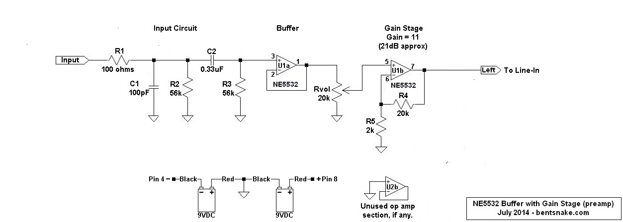

I happen to have a schematic on hand, so I'm posting it.

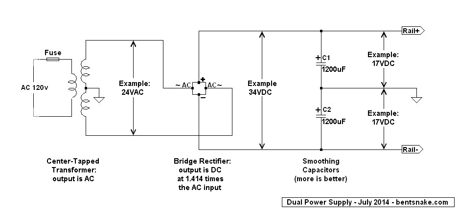

I'm also posting a representative (only that) dual power supply schematic. Please give serious thought to using a dual power supply, as opposed to a single supply, because dual power supplies make amp circuits simpler. The NE5532 runs happily at around +/- 16 volts, which you get from a 24 volt center tapped transformer.
Some circuit notes follow. Especially notice at the end for guitar pickups.
Hope this might be of some help.
Circuit notes:
R1 is overcurrent protection for the NE5532, and also guards against oscillation.
C1 shunts radio frequency energy to ground. Both stage and studio environments can be expected to have high levels of radio frequencies.
R2 is a load resistor, put there because you usually don't know what the input signal is going to come from. By providing a current path to ground R2 ensures that there will be voltage at the input side of C1. R2 in parallel with R3 sets the input impedance, which here is about 20k.
(If R2 is not present, then the value of R3 is the input impedance.)
C2 and R3: C2 blocks DC, and with R3 forms a high-pass filter, also called a bass rolloff filter. Here the rolloff starts at just over 20 Hz.
U1a (1/2 of a NE5532) is a buffer. It's characteristic of op amps that connected this way they have unity gain, extremely high input impedance, and extremely low output impedance, all of which is ideal for audio inputs.
Rvol is the volume control. The value can actually be anything from 2k (no lower) on up.
U2b (the other half of an NE5532) is the gain stage, which here is arbitrarily set at a gain of 11 (21 dB). Gain can be anything theoretically, but keep it to 20 or so in the real world. The formula is simply R4 divided by R5, and add 1. That is:
Gain = R4/R5 + 1
For preference, leave R5 at about 2k and adjust R4. Higher resistance for R4 = more gain. R5 no lower than 1k, if you must.
The output is low impedance, and should be suitable for the line-in input of a mixer, preamp, or amp.
NOTE: The 20k input impedance shown here is much too low for instrument pickups, such as on a guitar or bass. It will work, but not really well. To be strictly correct with an instrument pickup, change both R2 and R3 to 1meg, for a 0.5meg input impedance. Change C2 to 0.068uF
Caution: 1meg is a very high value in audio terms, and noise problems can multiply. Keep leads short, use shielded wire, and ground everything, including the body of pots (Rvol).

To be honest, I suggest the first schematic using TL071 is much better as guitar buffer. NE5534 is a superior choice when driven by lo impedance source - but they are a no-go as input stage of hi-impedance sources like magnetic guitar pickup. Due to the high noise current, the TL071 will by far outperform the NE5534 in this application.
Furthermore it is no good idea to load the PU with an input impedance of about 23kOhm, which kills any overtones yielding a muffling sound.
All in all, there is absolutely nothing bad with that simple TL071 input stage.

Well...wait...hold everything.
I have to semi-agree with voltwide. The TL071 circuit shown would certainly work. Bolt it together just as shown, don't change a thing, and it will do the job for you. Just be sure to keep connecting leads as short as possible, those resistors are waaay up into funny-noises territory.
Those should have been the first words out of my mouth...keyboard. Then I should have said something like, "But you might not have the audio quality you want for a studio setup, and if not here's an alternative," or to that effect.
So questions of impedance (not a problem) aside, maybe I did overreact and make things complicated. My bad.

voltwide, you didn't read the circuit notes, did you? Nooo, you didn't. They might be of interest.
<< I suggest the first schematic using TL071 is much better as guitar buffer >>
The TL071 circuit shown is not a buffer, it's an amp. Two different animals entirely.
Whether you run the input amp at V=1 or V=3 does not really make the difference, g=3 is a good starter for a guitar input amp when powered by 9V.
I am in that business for decades. And your circuitry is much more complicated compared to the TL071 version, including the split supply, all that to no advantage, but with totally wrong input impedance and sub-optimal noise performance.

<< The last question I had regarding that is why can't you just use resistors instead of the buffer to raise the impedance? >>
Whoops, I missed that one. Very good question.
The answer is that you do set input impedance with resistors. Noting that you wouldn't speak of raising or lowering impedance with resistors, you speak of setting it, that is, you create it.
Somebody needs to study up on how op amp circuits work, emphasis on input circuits. But speaking very broadly, the resistor closest to an op amp sets the input impedance. Or if there are several resistors, then their parallel value is the circuit's input impedance.
VERY IMPORTANT: This "speaking very broadly" is so broad as to be almost meaningless. Consider that we're speaking only of this circuit.
Along with that, don't mix apples and oranges. Amplifiers are one thing, input circuits are another thing. Importantly, realize that buffers are amplifiers. They're a special case of amplifiers with a gain of unity, and you'd never say amp, you'd always say buffer, but still buffers are amplifiers.
All of which evolves into the following, which is critical, it's the nexus, the very heart of the matter:
The impedance of an input circuit is one thing, the impedance of an op amp is another thing. They have nothing to do with each other.
The factory sets the input impedance of the op amp, you set the impedance of your input circuit. And now it falls to you to make your circuit work with their op amp.
Happily, you don't have to get an engineering degree to deal with this. Around here we let somebody else do the math. What we do is reach into our bag of tricks and pull out a rule of thumb.
We take it as a given that we need 1meg or higher input impedance for a guitar pickup (rule of thumb). So we set the impedance of our input circuit to that value simply by choosing that value of resistor(s). So now we need to feed the op amp.
But we have to follow the "times 10" rule of thumb. That is, whatever a circuit's impedance might be (in this case 1meg), the following circuit must have an input impedance of 10 times that or better. In this case the "following circuit" is an op amp, so that op amp must have at least 10meg input impedance.
The TL071 does. In fact, it has an input impedance of about ten million meg. And this very high input impedance is why it's so often chosen for use in guitar amps (the only reason, as far as I know).
But what about the NE5532? Fail. It has a worst-case input impedance of about 30k, which is far too low. Low resistance means high current flow, in this case too high, so the preceding circuits will be overloaded and distort.
That is, unless I have something else in my bag of tricks? It just so happens I do. I reach in and pull out, tada, a buffer, and this deceptively simple little circuit changes everything. The NE5532 now has a multi-meg input impedance too. How many megs, exactly? I don't know. At one time I tried to calculate it, but my dime store calculator ran out of zeros.
All of this applies equally to any circuit. But CD players, iPods, whatever always have low impedance outputs (including headphone outputs), so generally an input circuit of around 20k impedance is fine.

Build the first (TL071) preamp/buffer, which has the proper gain and impedance.
If gain is not enough for your pickups (say single coil instead of humbuckers) you can lower R1 to 47K to double the gain.
The second (NE5532) schematic has a useless "buffer".
Why?
Because as shown it has unity gain (duh!) *and* totally inadequate 23K input impedance.
FWIW you might connect the guitar straight to the 20K input pot.
