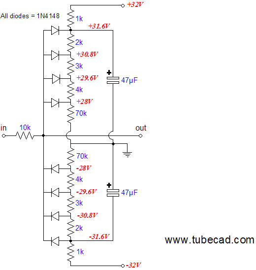

Also as your power amp is low powered - 30W / 8 Ohms, power amp should soft-clip. Do you have soft-clipping circuit? (I attach one)

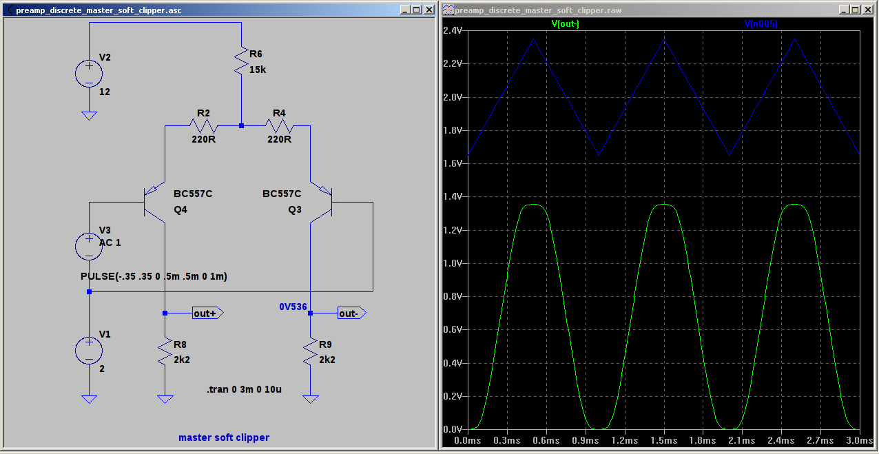

I use the differential pair as a soft clipper. The symmetric output directly drives both inputs of TPA3118 and the level follows operating voltage - thus soft clippling adopts to a wide range of supply voltage.
You connect it to the input of poweramp.
+ / - 32V voltages should be your poweramp voltage rails.
As Teemuk also noticed, your soft clipper needs 64Vpp to work.
Sure, in simulation it will round peaks beautifully, but such signal level is not realistic if coming from a preamp.
And even if you got it, it would be way too much for a power amp, which usually have gain around 20X .
Not a bad design, that's not the point, but you should recalculate values for, say, 5 or 10Vpp signals so it can realistically work and then it will have to be padded down (master control) to power amp friendly values.

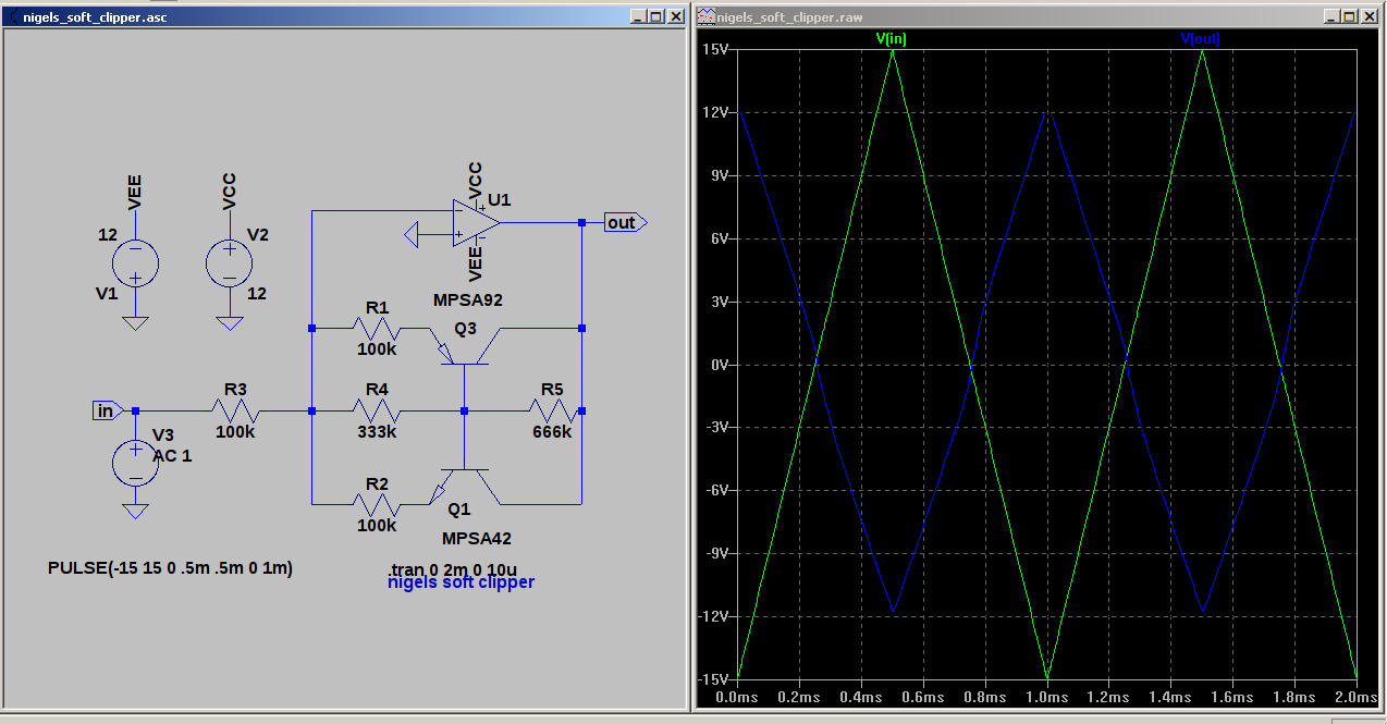

I simulated your circuit with LTspice.
And cannot find the proposed valve characterics.
It does some distortion at medium levels and clips abruptly when output voltage reaches supply.

Beware of ltspice, I have used it a lot and often it doesn't give true results. I simulated some valve circuits and it was miles out from the final real circuit.
This may work within a small level range. But if you increase the level further, this acts as a gain -1x amp. Until output level limit is reached - ending in harsh clipping.
No, this is not a limiter.

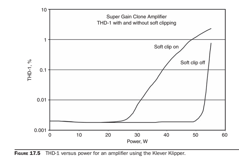

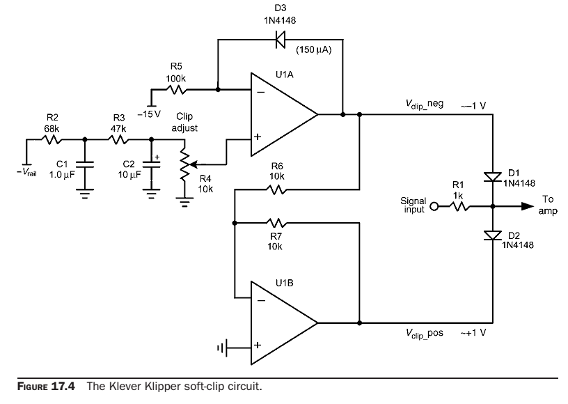

Klever Klipper circuit
Here is soft-clipping circuit from book "Designing Audio Power Amplifiers" by Bob Cordel.
Circuit should go before poweramp.
Mind you, that soft-clipping increases THD.
