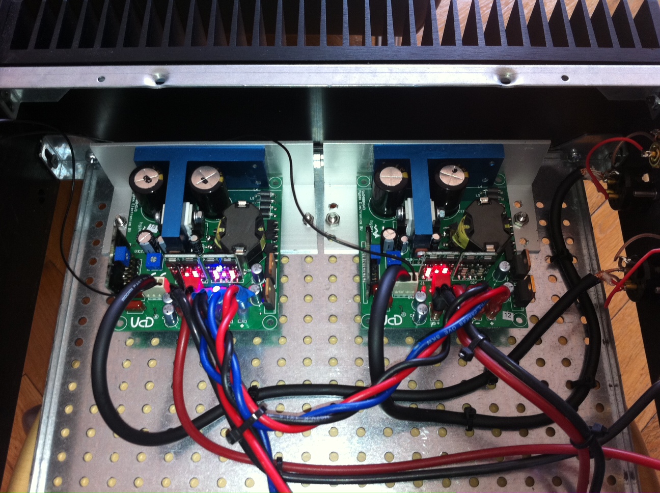

hello together
After a prolonged stay abroad, I have finally time for my project.
I have finally done it ... it runs. With your help I did it. Thank you for that;). Now I have a little problem. One of the 12 HxR regulator (on the right UCD module - HPR12) does not work, has no light. Here you can hear a small click and the blue LED flashes ... and I think something tastes like burnt. I immediately turned off. Does anyone know what could be the problem?
Thank you for your help :eek:
...Nobody an idea?:confused:
Is this HxR Modul gone or do i have to check/try something else?
Thanks for an answer
Nope, no idea. There is either a short circuit, an open circuit (bad solder?), or the regulator is toast.
If you bought the UcD with HxR's pre-installed, I suggest you email Hypex and possibly arrange a return for repair. (maybe a charge for repair though)
If you installed the HxR's yourself, I suggest rechecking solder joints and such. Maybe check with an ohmmeter all the power rails. And of course you can always arrange a return to Hypex for repair. (I had to have a UcD repaired by them myself. Aside from expensive shipping they were good about it)
good luck.
