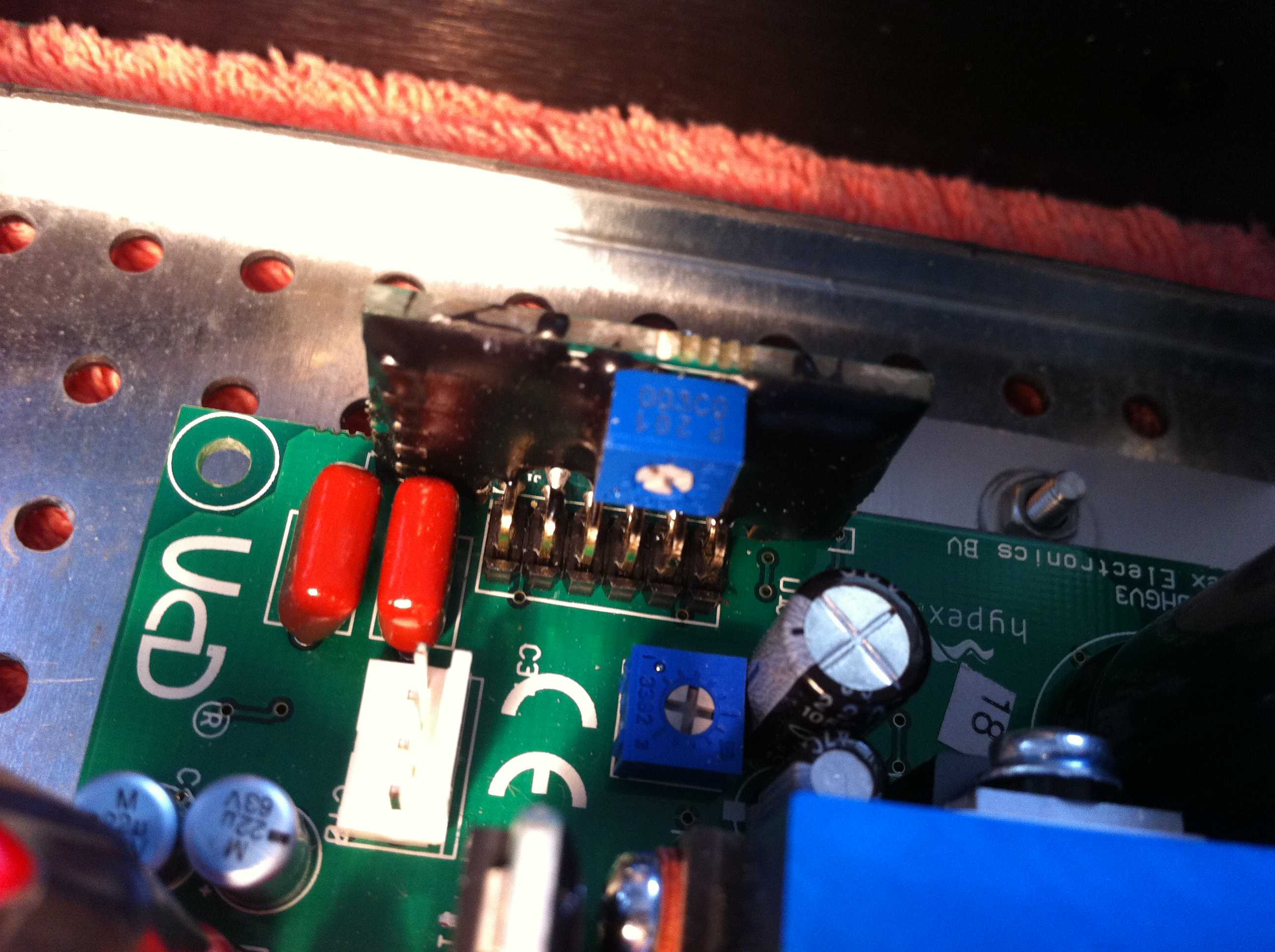

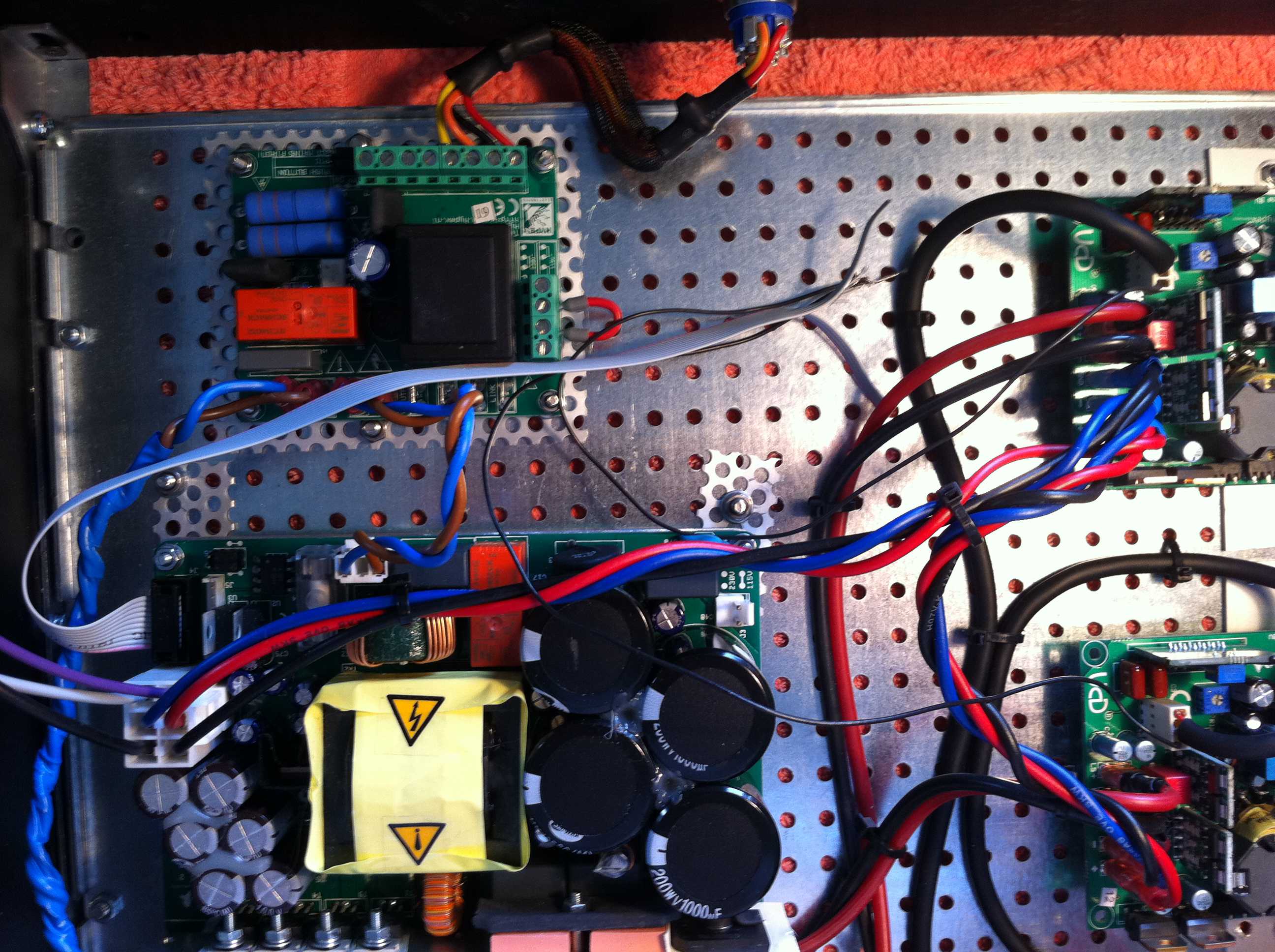

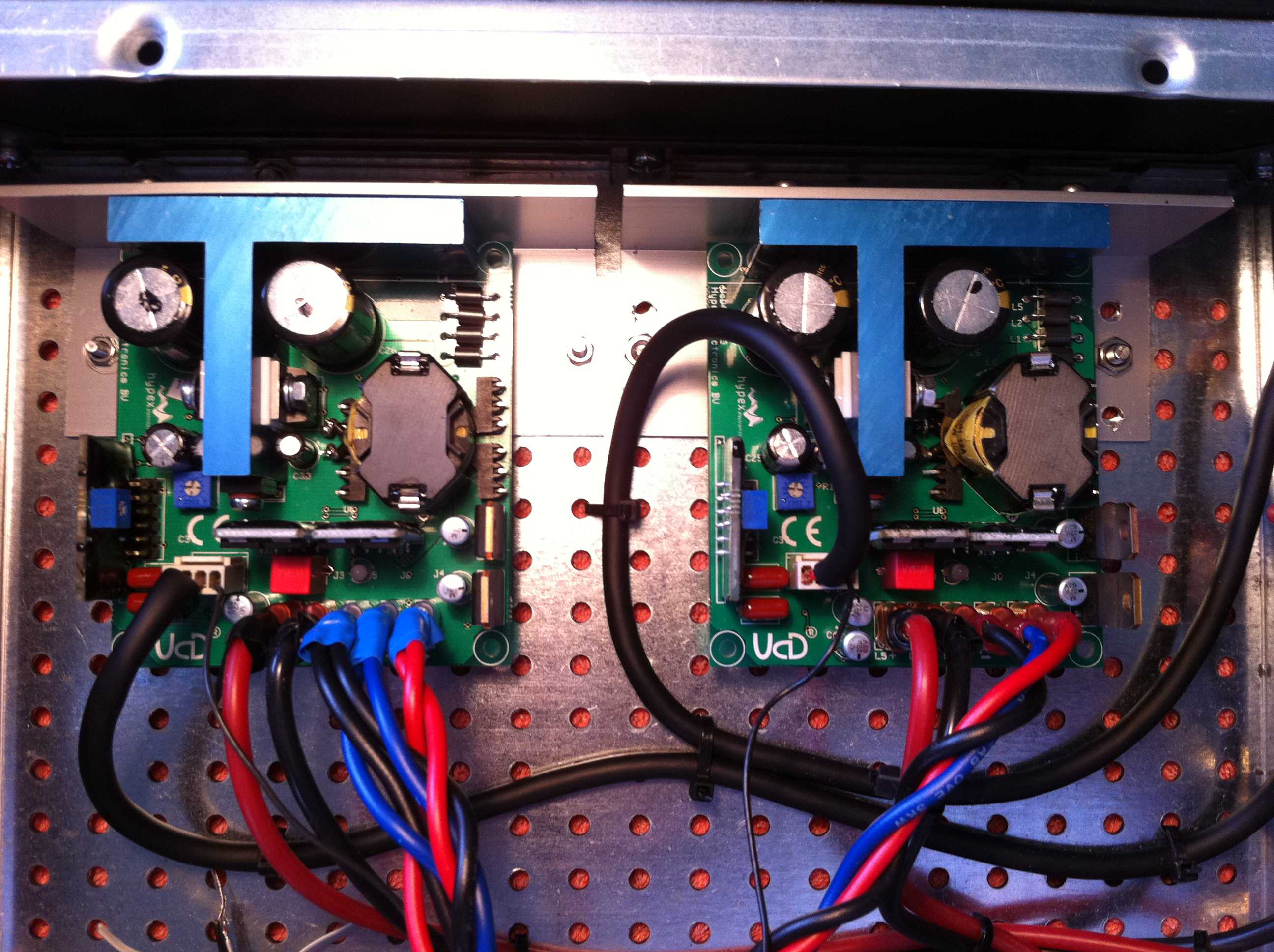

i don't know what i have to do now..I even put the ucds on more stable support for better cooling (see pictures) but this is for nothing when they are not even illuminated...i also put the Pin 5 (and 6) to the pin 4 ( J1 on Ucds is the Molex plug isn't it? it is not writen and there is nothing otherwise!)

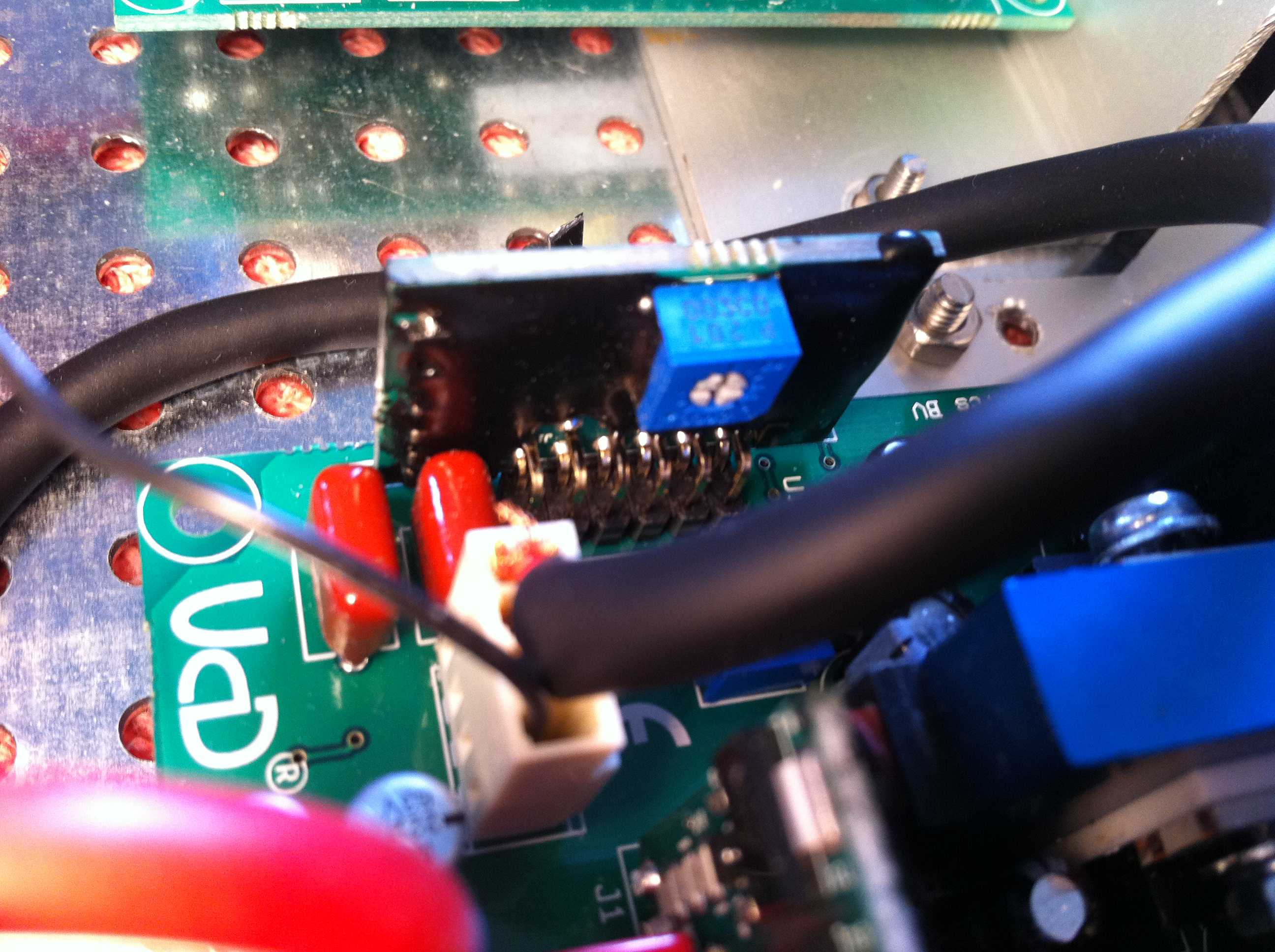

I found something strange with this kind of little screws on the ucd's to adjust what else....but they are not in the same position (see pictures). Is this normal?
Otherwise i don't know what have to do. I thought i would be easier...

Do you have a Multimeter? If so have you tested that there is power at the all points before the modules?
You may have already done this but just in case.
You should test all of the power supply line points, start at the incoming AC & work your way to the outputs of the PSU, (be careful) check that the DC volts coming off the PSU, are you getting the volts of the PSU you are suppose to get, is it too low, is it too high?
The little knobs are some sort of trim pots and they are probably set in the factory, the reason they are there is for fine adjustment & its unlikely there is anything wrong there.
Have you double checked that the power Connector J1 is wired correctly, did the cables come ready made with the connector or did you have to put it together?

So, now i have two wire plugs:
- on the first picture is J4
- the second picture is J6
But i have no idea how i have to connect these wire plugs. There is no other possibility to put these plugs on the UCD or i am wrong?
How do i have to connect Smps with the UCD's to enable them and where is this pin?:eek:

I tried to measure with a multimeter the voltage.
- power plug gives me 230 which is perfect
- softstart in, still 230, softstart out 1.5!!!!!
- smps also 1.4
and now....still badly news....softstart do not work anymore either...:mad:
i guess is shorted out...gone!:mad::mad:
i will contact a friend to check everything and then i will see if i lost a lot of money or not.

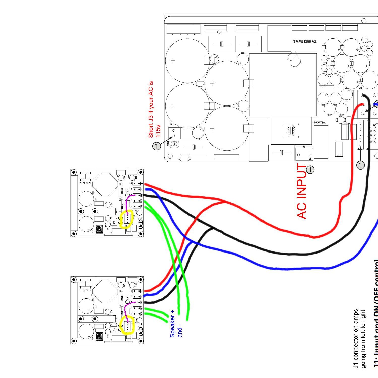

you still have the output of the sofstart on the wrong pins. see the diagram in my other post #38
the AC out should be on the middle two pins of the second four connectors (F7 & F5 in that diagram). If you don't understand this let me know and I can draw a different diagram on your picture. the fact that you measure 1.4/1.5 is not unexpected. You are really measuring zero Volts, but that's below the basic accuracy of the meter. (and there is likely some noise)

because the softstart went to the softstart-heaven i need to connect the smps directly to the power. this should not be a big thing and some of you told me that there is no problem to doing that. the only thing is how do i have to connect the illuminated push-button to the smps?

bummer, sorry to hear the softstart is broken. Maybe witha little help you can still fix it...
yes, connecting AC directly to SMPS is fine. And is the "expected" method I think.
Without the softstart, I'm not sure there is a way to use that illuminated button. I don't believe the SMPS has facilities for that. (I didn't use the SMPS myself) I would suggest, at least temporarily to use a simple switch on the AC.
Though the softstart is not required, it does have nice features for handling the switch.

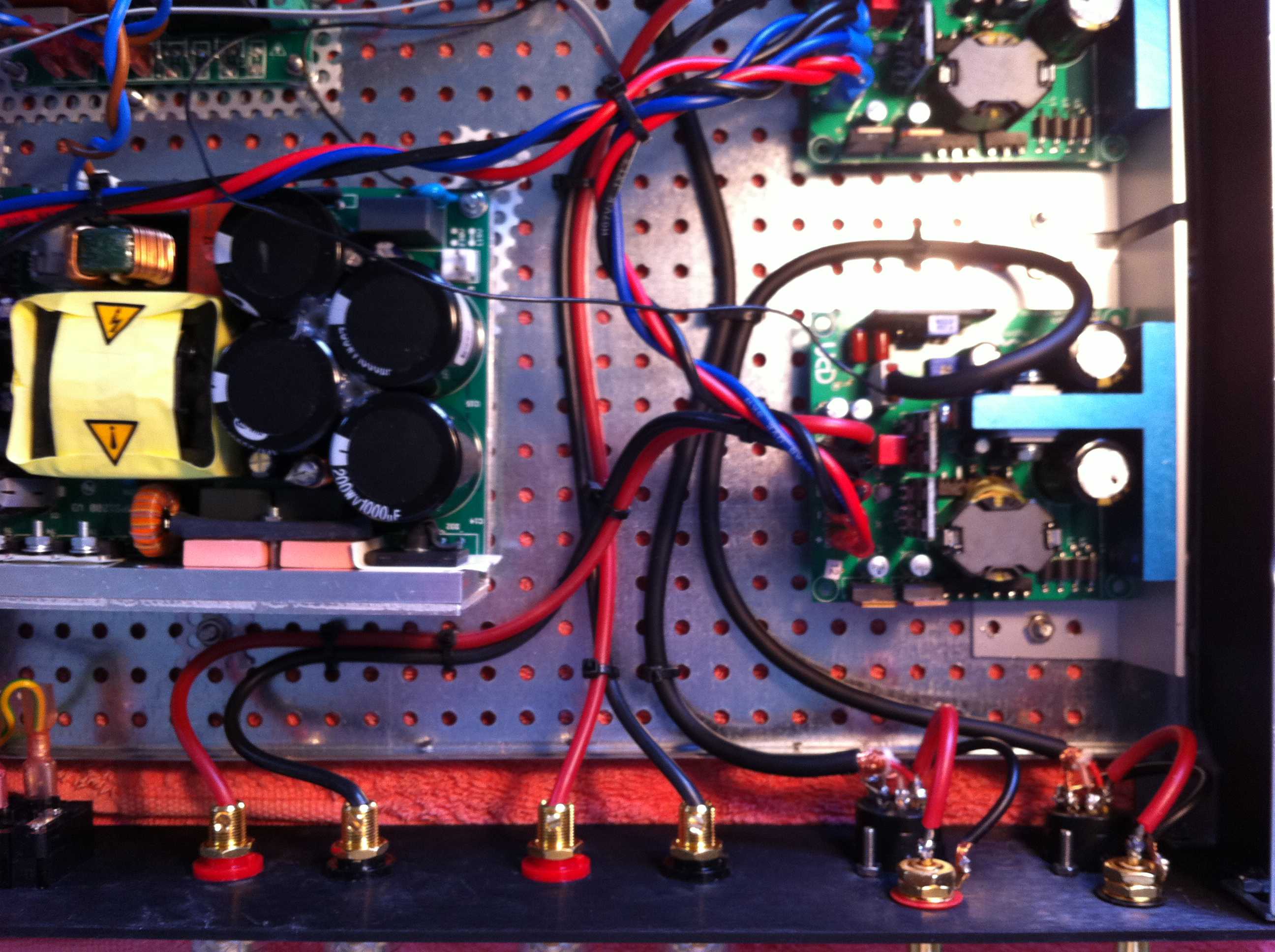

Ok, now i am ready to try this once again...i got a new softstart from Hypex (i would like to work the pushbutton).
Now, for the ucds i am still not sure about the on/off wire (4 pin Molex) where i have to connect them. Is it enough to just connect them to the ground (see picture, the pink wire) on the ucds or should i connect them to J4 (5th or 6th pin) from the smps?
either is fine.
- direct to GND is functional and will do the job... simple is often better.
- connect to J4, is a little more "elegant" and may reduce chances of any transient noises at power on or off. (if it was not of at least some use, hypex would not have provided the option - I would think...)

I have some problems with my UcD400STs. One is a v6 and the other a v8. I am using 48V Meanwell SMPSs to power them. The v6 powers up fine, the v8 doesn't and I don't know why - they are wired up the same way. I even sent the v8 back but it tested fine. The Meanwells have no ground output, so I just connected the enable pin on the Molex to the GND Faston spade. This works on the v6 but not the v8. Is the ground the problem? Should I connect the GND Faston and enable pin to mains earth, or will this blow something?
Help would be appreciated.

I connected it to power ground as recommended by Hypex. I don't use the idle feature and a trigger switch; I just do the on/off switching directly at the 230 VAC primary. Works very well for me; absolutely silent when I switch on or off. I have only an UcD180, not so much power, so I don't use a soft start. And I also use a linear power supply (supply HG from Hypex); so I'm not sure if my experience is of any help to you.
