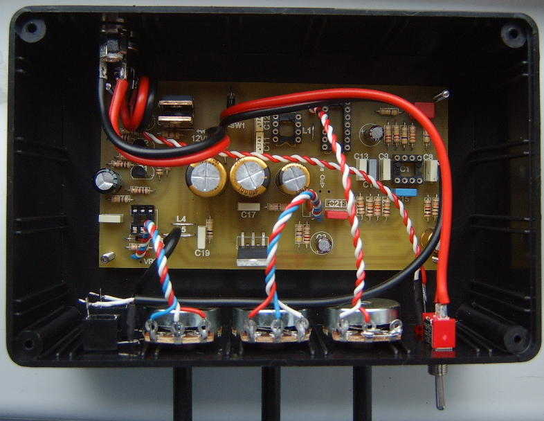

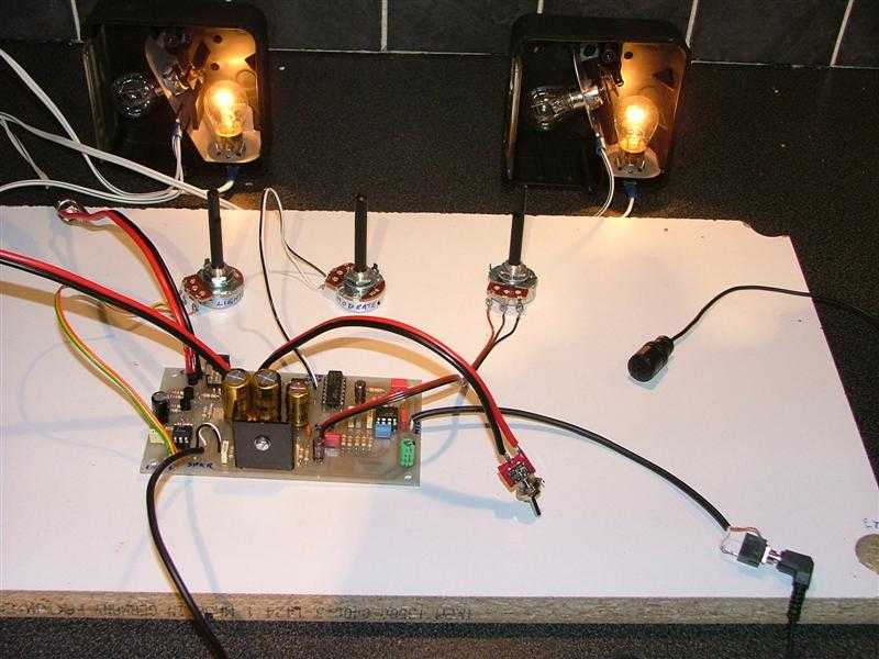

Heres a picture of my baby. This was my re-entry into electronics. Starting from a poorly photo copied schematic of a circuit known as the 'Vader Mod'. This was a Dick King Smith Kit now no longer available. I built it on breadboard to start then transfered it to vero board. The original circuit used a LM386 chip as a power amp so lacked the 'punch' it really needed for the specific use it is popular for. So I found the TDA2003 Data sheet complete with a PCB pattern. Thanks to the original illustrator I could see in the schematic of the vader mod where the power amp started and finished so I was able to dismantle that part of the circuit and simply slip the TDA amp in it's place. The vader mod is based on the original PCB pattern but has been edited to 'improve' it's layout with the rest of the circuit. The only part of the pattern I can take any real credit for is the sound to light part. But again this is down to who ever drew the schematic it was based on as it translated into a PCB pattern really well and I only had to worry about remembering to thicken the power in traces and the power to light traces. No audio design concerns here . During it's final testing an Australian member of the forum contacted DKS about the defunct kit and she secured 'permission' to use the design. So under the GPL type licence there is a 20 page manual of building instructions for the unit freely available to forum members. It covers everything from part selection/sources, pictorial assembly instructions, component identification and special notes therein. Also included is the PCB pattern and component silkscreen image for those who can etch their own (instructions on this are also in the manual) I have sold 30 kits/part builds/full house units. Other than it's simplicity it is a lot cheaper than any other ready built units. The idea was to have a freely available design that the 'common' man/woman could have ago at with a high chance of success. It took 18months to get it all sorted and I am now working on the MKIIIa which has a bridged amp for increased output over the 4W design. Heres one I built.

Tut shame on you! Give up? OK...........
It's a voice modulator with sound to light and a TDA2003 amplifier.
Basically you speak into the Mic and something akin to a Dalek
voice comes out the other end and the lights flash in sympathy
to the vocal output as per the BBC prop The pots control the
light sensitivity, volume and modulation rate. Theres a few full
size home built props with my unit in them

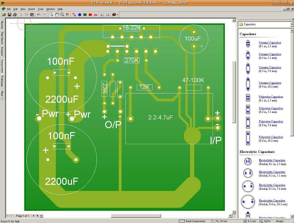

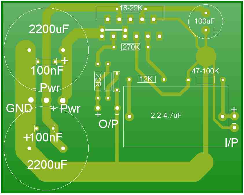

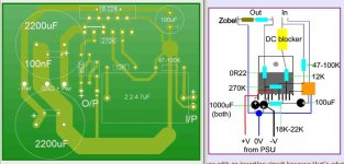

Any hoo I have been fiddling with my PCB software practicing making PCB patterns. This one is based on Nuuk's 3886GC circuit, as a mono only. I have tried to do it based on the 'rules' about signal earth's, power earth's and trying to keep distances down soooo here it is and feel free to laugh or kick my behind. Basically will the layout work? The 2 unmarked components in the middle are the resistor and cap that form the Zobel network the large rectangle is the DC blocker (a polystyrene cap) and the 2200uF caps are as per carlosFM's PSU suggestion including the 100nF caps which will be fitted on the track side of the pattern. If it is correct I can see it can be compressed vertically.

Edit I missed the last post
Nice work on the Dalek front! Is that the collective noun then? a trundle of Daleks. It fits nicely.
As far as the PCB goes I would say the lower 2200 cap is wrong, in that there is no power supplied to the negative rail.
You need a positive rail, a negative rail and a power ground (usually between the "non rail" pins of the capacitors) The 100nf capacitor only gives a path to ground for stray AC (and maybe RF). It will allow AC to pass through it but block DC in it's tracks. (An inductor does the opposite as I understand it, allowing DC to pass but blocking AC)
If you look at the board for a Chipamp.com amp,
http://www.chipamp.com/lm3886.shtml
The amp pcb is divided into 3 sections. One end is V+, the other end is V- and the area between the caps is power ground and speaker return.
If you took your speaker return and power grounds to the point you have marked as -PWR and fed your V- to the negative pin of the lower cap I think it would be nearer. There may be things I haven't spotted in the rest, I'm not familiar with the 3886 layout.
I'm struggling to describe this so hopefully someone can give a more concise description.

It still doesn't look right to my untrained eye.
Draw yourself 2 caps with + and - opposed. Draw a line from + on one to - on the other. The centre of that line is your power ground and speaker return point.
Draw a line from the unconnected positive pin to the + chip supply. Do the same with the unconnected negative to the - chip supply.
These lines are your V+ in and V- in points.
With a split supply your rectifier DC outs are tied together, the negative of one being tied to the positive of the other at the power ground between the caps. This means when referenced to your power ground you have "X" volts positive to ground, and "X" volts negative to ground rather than just a positive and ground single supply.
Got to dive out now for a couple of hours and sorry if I'm teaching my Granny to suck eggs. If not, I hope it helps.
