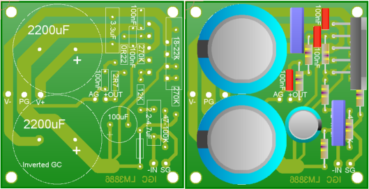

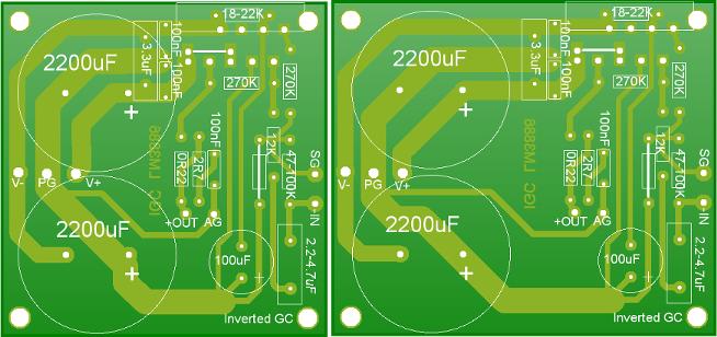

Tweaked the layout to allow the fitting of the 100nF and 3.3uF Caps on the component side. I think if I am careful I may be able to rotate and place the components to the right of the zobel trio and shrink the PCB without degrading the 'audio' requirements of the layout. What do you think so far?
regards
Fooboo

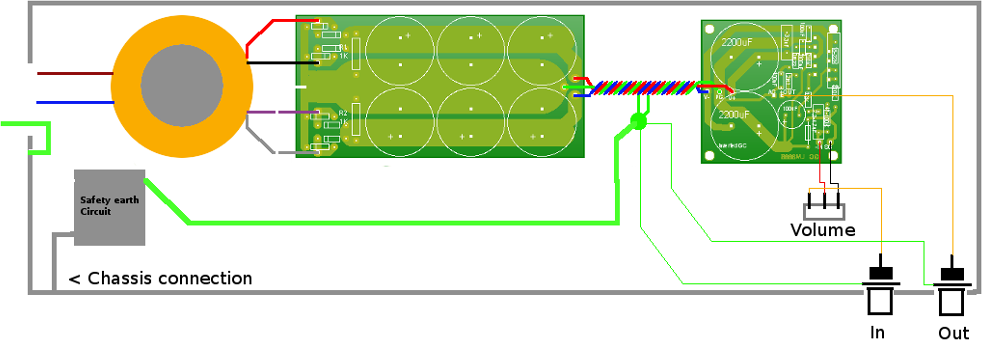

Well here's a pic of the full wire up including the volume control. I believe this is referred to as a monoblock? I intend to build 2 in a single case and use a ganged pot for volume control. I also fiddled with the layout a bit so everything is on the top side of the PCB the board is around 2" square. The PSU will be built on perf board and single core mains copper wire used as the linkage for everything. Fingers crossed I have understood everything so far (Thanks for the considerable help) and I can build, test, and run the Amp with minimal problems.
Regards
Fooboo
