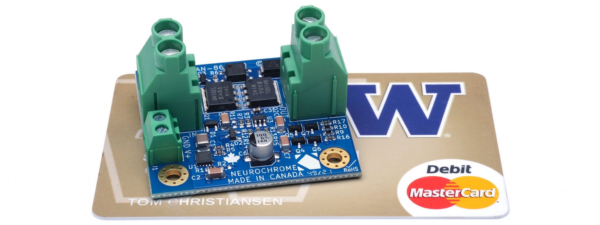

Now this... The Guardian-86 Rev. 2.0 just launched.
Major improvements over Rev. 1.0:
  • Works without modifications on any amp power by ±15 to ±90 V (or single-ended amps powered by +15 to +90 V).
  • Works with all amplifier types: Single-ended and bridged/BTL.
  • Smaller footprint (40 x 45 x 27 mm; W x D x H).
  • Automatic sensing of the power supply and automatic disabling of the output once the power supply voltage drops to 2/3 of its nominal value. This eliminates clicks and pops on power-down.
The Guardian-86 is $99/each and is only available as a fully assembled module. This allows me to provide a better product at a lower cost to a broader market. The Guardian-86 is a mono board. Two are needed for stereo.
The Guardian-686 will be discontinued once the current stock has sold. I have six fully assembled Guardian-686 in stock and on sale at $169/each (reg. $199/each). I also have a good handful of the bare boards in stock. Shop the sale here: https://neurochrome.com/products/guardian-686
You can read more about the Guardian-86 here: https://neurochrome.com/products/guardian-86

The new guardian-86 boards look good. For the old ones, does it do the autosensing and autodisabling of the power? What is the older ones voltage range?
The Guardian-86 Rev. 1.0 and Guardian-686 do not have the auto-sensing of the supply voltage. You set the trip point with a zener diode, but it's not super precise. Basically the Guardian browns out and turns off. In the Guardian-86 Rev. 2.0 there's a comparator that compares the supply voltage with 2/3 of the sensed nominal voltage. Once the power supply crosses that 2/3 threshold, the MOSFETs are turned off and the speaker is disconnected.
The Guardian-86 Rev. 1.0 and Guardian-686 will work without modifications up to 45 V. If you want to go higher than that you need to swap a zener diode.
Tom
