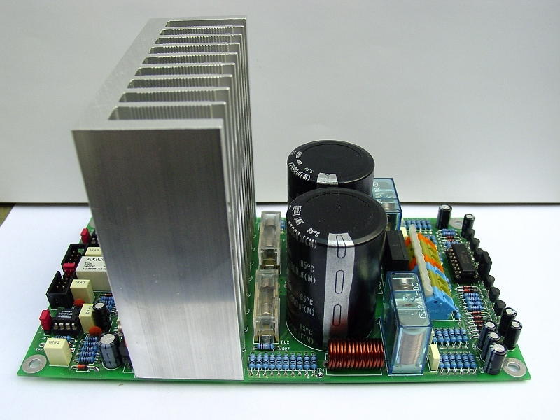

A member, who is modest enough (to pass Fred's scrutinity) sent me those pics, giving me permission to post them (in case I liked them). Well, it's a total opposite to what we try to achieve here, yet I find the layout and design quite interesting and carried out very well. It is a full implementation of LM4780, without any shortcuts taken.
Very nice work indeed, Upupa Epops.
You have used my "industrial" approach, using "normal" parts.
I especially like those Wago 256 connectors which creates the necessary pain (sharp springs into the wire) to the music, a real blues connector! I also like the nice looking coils, nice craftmanship.
Hey Peter-
In your post you stated the following:
"Well, it's a total opposite to what we try to achieve here"
May I ask you to throw out a few reasons for that statement?
Is it size, component type/brand, circuit layout....?
It does look stunningly meticulous, but also somewhat complicated. There are a lot of components on the board for a "chip amp".

"Circuit is quite universal, you can connect it in all modes ( stereo, bridge, parallel and two modules as parallel / bridge for output power 200 W ). It has DC protection, delayed output and on input connector is taked + / - 15 V for prewiew stages ( electronic crossover, preamp etc. )"
The design that we try to finalise in this thread is aimed at minimalistic approach. That means only 1000u caps are used (as to me they sound better than 5,600 I tried already, and I wouldn't even dare to go with 22,000). Also, we concentrate on basic implementation, so no stereo or bridged mode, just parallel. Stereo can be still achieved, but components have to be raised from the board.
We use separate board for rectifiers, and we will provide the option to mount it piggy back style, directly attached to the amp's board. This reduces the size and allows more creativity with chassis design and most any style and chassis box can be used.
We also prefer to use more exotic components (as regretably over the months, they still prove to provide better sound than your military grade stuff) and direct connection of wires to the board. Although those fancy connectors look nice, direct solder joint certainly isn't any worse.
We not concentrate on fuses and output protection, leaving this option to end user. I also don't want to be limited by a heatsink choice as with this amps I prefer to use the chassis wall as heat disipating surface.
So basically the design philosophy is completely different, and I can't say that one is necessary better than other, it just brings different results
