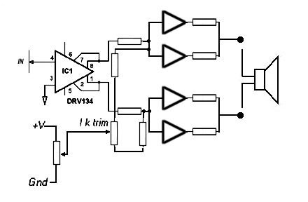

Heres a quick drawing of an idea for "fake class A" using this kit in bridged mode. it does not waste power all the time or need an output capacitor.
I did not calculate the values of the resistors yet, because i was too lazy too look up the gain of the amp, and it may take some experimentation to get it "just right".
I am sure stuff like this has been done before, but i thought i should post my idea anyways.
if the exact same offset is applied to both the non inverted and inverted inputs then both amp outputs should have the same potential relative to each other, so there will be no DC on the speaker. That means no output capacitor. and no current passing.
of course it will have to be very carefully adjusted with the trim to get zero DC on output relative to each other.
I am not an EE , i just make things for DSP, which will not let the smoke go if you make a mistake:) so if there is any bad flaws in this design (besides failure modes, which i believe can be looked after in non obtrusive manner)
if the offset is half of the voltage that would give maximum output, (depending on gain) then you would have "pure class a" but at half of the maximum power of the amp.
I was thinking as a "failsafe" in case of failure of an amp or other bad thing . DC detector , but it just disconnects the +v on the offset circuit and it reverts to"normal" function.
another bonus of this is that there should be good power noise rejection, because the offset voltage will both change at the same time if there is any noise, so the relative difference will be almost nothing. that is why i did not go for a voltage reference rather than just the +v (also if the output power drops on loud passage the offset voltage will drop correspondingly so it is still half)
you might be better off with a EI type transformer If you try this, because the bottom half of the rail will hardly be used, and apparently if you load toroids asymmetrically it can lead to some problem (magnetizing of the core, something bad i forgot)
i could be comletely wrong on this though now i think about it, the rectifier supplies both halves of the power to both rails if it is center tapped, so if you have dual out transformer it might be better to set it up as center tapped, and use 1 bridge.
