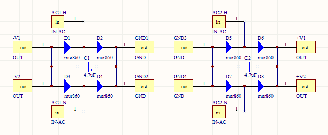

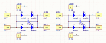

Peter Daniel said:
C1 and C2 should be the other way around.
I was initially planning on using non-polar BG N caps, so I overlooked this. There also is currently no polarity marked on the pcb for the capacitors..
Here is a revised schematic, and I will update the pcb as well with polarity markings in the correct way.
Brian

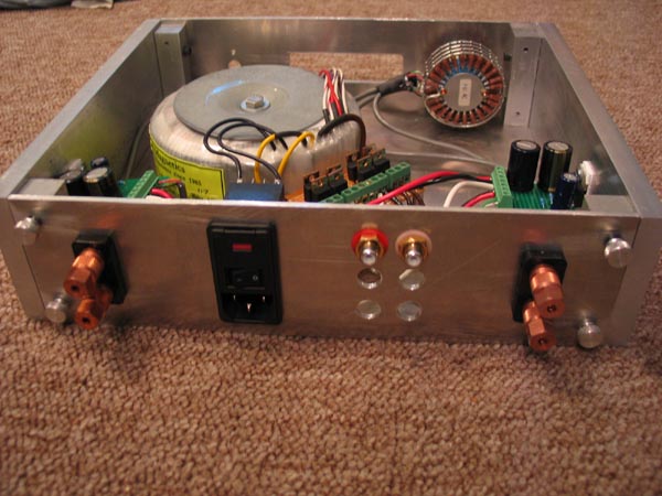

Listen to Rodd, if you want great chassis connectors, get in on the Cardas order while you can. You will not find a lower price for these connectors. Here is a picture of my chassis, running the same circuitry that these pcbs contain. I used Cardas copper binding posts and RCAs. I also used a stepped attenuator, which is offered in another thread on this forum.
(this is the amp that I helped my friend Eric build last week http://www.diyaudio.com/forums/showthread.php?s=&threadid=28048 )
