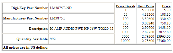

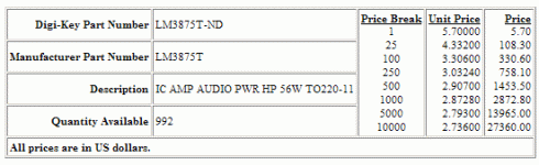

I will give it a few more days to generate interest, then I will work on getting some definate prices. One more addition to the above price list above, is the LM3875, which will add another $8-10 to the order if you don't already have some of these chips.
Brian

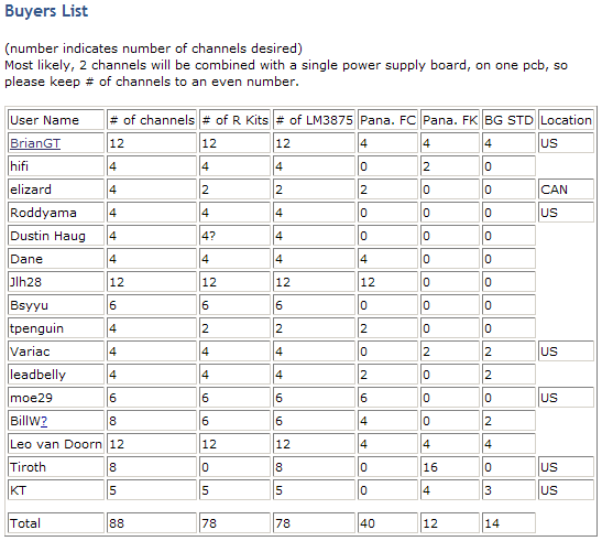

Information on Wiki
Here is the link to the Wiki, for those missed it:
http://www.diyaudio.com/wiki/index.php?page=NI+GC+PCB+Group+Order
Please fill out the table. I attached the current view of the table.
Most likely, 2 channels will be combined with a single power supply board, on one pcb, so please keep # of channels to an even number.
Also, please fill in your geographical location, and verify the numbers listed in the sheet.
Brian

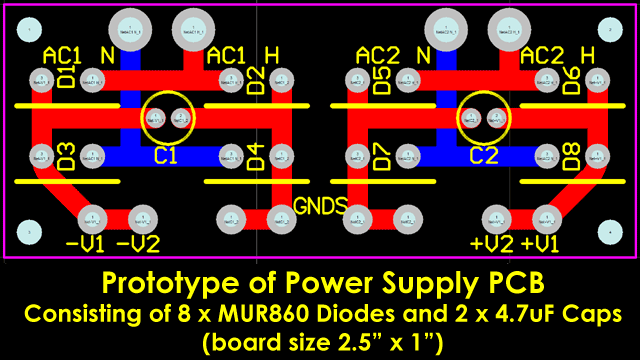

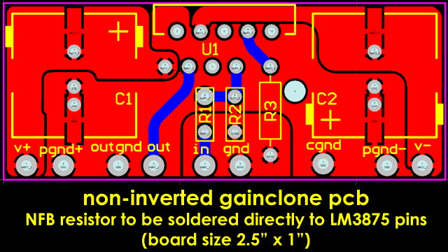

BrianGT said:
What about a single hole in the middle of the board, to relieve stress on the solder joints? With the current positioning of the capacitors, and board dimensions, there is no easy way to put holes on the sides of the boards.
Brian
A single hole is OK but when the board would be slightly wider there is room fo a 3 mm hole at the left and at the right.
Never mind, a single mounting hole is better than none at all....
What about placing the single hole here:
If not.. where would would you recommend placing it, with it not interfering with the layout.
The blue traces are the traces on the bottom of the pcb.
Brian
