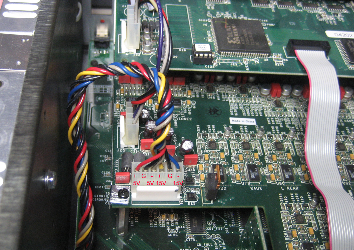

Hi, the Lexicon MC12HD uses an industry SMPS see EOS Power - Standard Modified Customized Power Solution with +/-5V and +/-15(16)V
The audioboard in the Lex gets with this mod +/-15V for all analog circuits from the external power supply and the SMPS remains for for the digital circuits.
The first power supply is for a good friend for his Lexicon MC-12 (non HD Version). Now i'am building a second power supply for my own SDP-40HD (same as your unit).
Now after several hours i can say that soundquality of the Lexicon is much more improved that i thought is possible.

Thanks Andreas,
Much appreciated, as I have 2 spare SSR03 boards sitting in my workshop I'll give this a try.

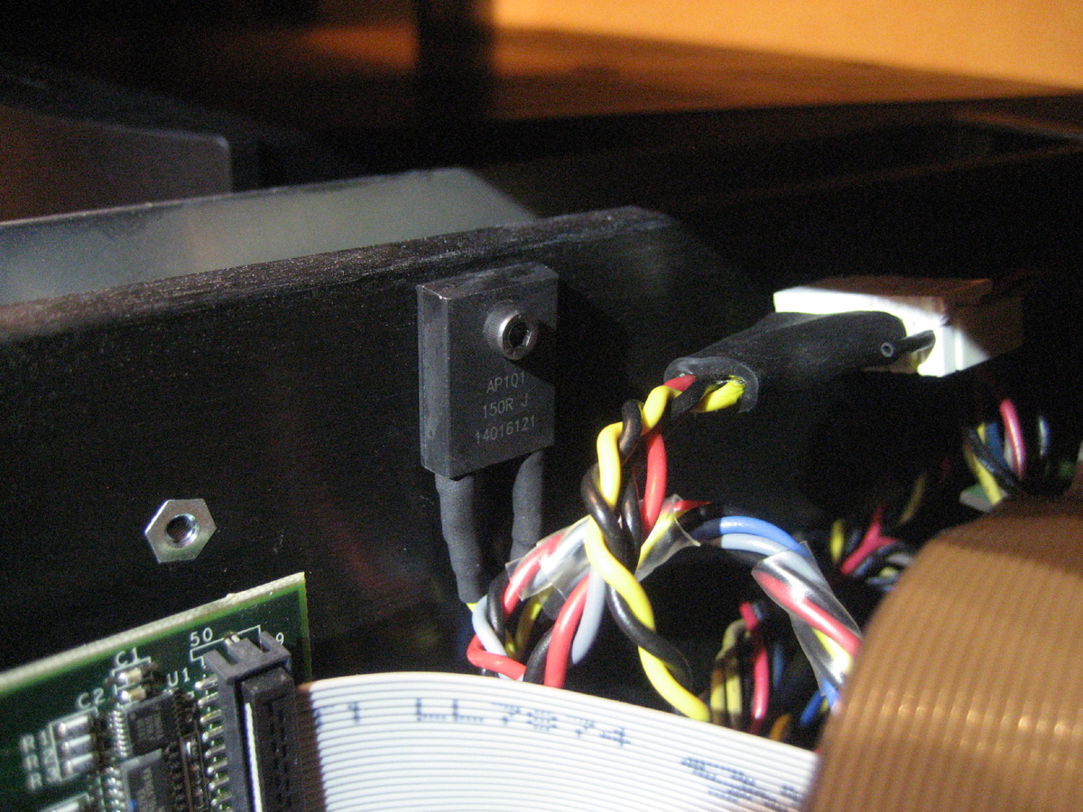

I forgot to say that you have to put a 150 Ohm loadresitor across the unused +15V rail to ground in order to simulate a minimal load for the SMPS (appr. 0,1A). I made this with a TO247 power resistor, there is an unused hole in the side panel

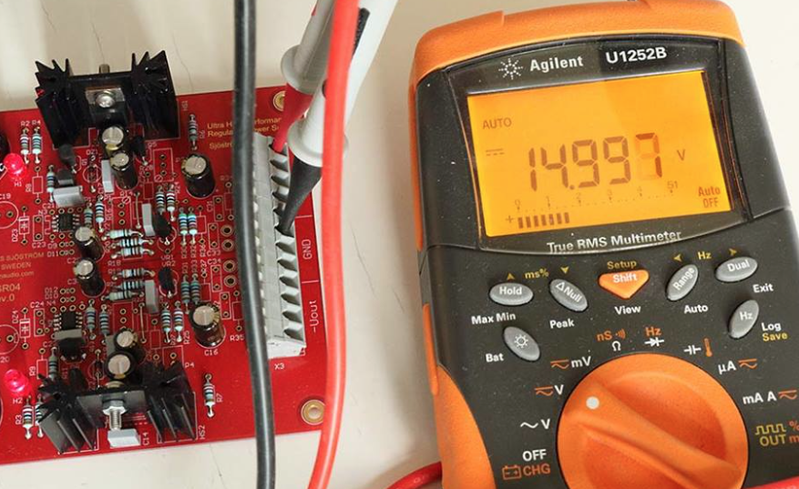

A question on the best way to trim the voltages. I built 2 15 volt versions and the voltages were perfect. I have just completed a 12 volt version and the positive and negative voltages are 11.85 and -11.75 respectively.
What is the best way to trim these up to 12 volts? Which resistors should I change and in which direction, increased impedance or reduced impedance>
Dear perander,
I have some problem with ssro3 (12v).
Before loading pos 11.96 v and neg 11.88 V and after loading pos is drop at 11.55 v and neg is stable 11.88( not drop) .
Also Led (pos) no light when loading .
A clear case of a too low input voltage. You can adjust the series resistors in the smoothing section and also remove the LM317/337 in order to gain some volts.
Hi Peranders,
The values of the resistors you listed are as per the BOM for the 12v 431 version. I did a check on those around both of the LM431's and I found that R39 and R40 were below the supposed value. I trimmed them and the voltages came to 12.002 positive and 11.950 negative, unloaded.
However when I loaded the supply, about 250ma, the negative rail collapsed to 4.5 volts, the positive rail stayed rock solid. With just a light load, about 20ma everything is fine. Obviously something wrong in the negative regulator.
The circuit that is being powered is fine, I checked with a bench supply and the current draws were both the same at 250ma on both the positive and negative rails. and the circuit behaves as it should, a pre-amp.
I'm going to go over all components in the negative side but any thoughts or directions would be welcomed. The transformer is a 100VA 18-0-18 so should be fine, its the same transformer I used for my 15 volt supplies which worked perfectly.
