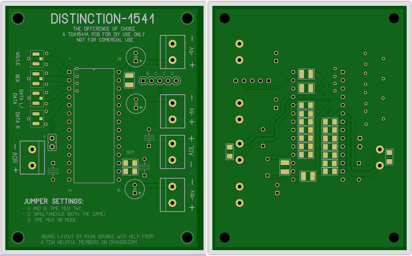

Update:
I've ordered the boards. At the moment it looks like about a 3 week wait to receive them. Shortly I will invoice the members on the list.
It will look something like this:
Mmmmm, jumper for simultaneous data mode, gllarlalalll (drool)
Should make it easier to compare the differences.

At the moment ill stick with the CEN with the mosfet 2mA current injection, im keen to up the current to lower the impedance because at the moment im sitting right on the +-25mV compliance. Wouldn't mind trying it as low as 6 ohms or so (~12 ohms at the moment)
Im open to trying different output stages.
andrea_mori might be on to something with a circuit hes working on, cant remember the details but it simulates with very low input impedance (around 1 ohm) and low distortion (less than 0.01%). It uses valves... wouldn't mind a bit more valve flavor.
You keen on staying with your current output stage?
Yeah mate, I ran with OPA861 for over two years… nulled for 0V at 1541A output, then tried nulling for 0V at the OPA output to DC couple to TVC.
Tried next (with same current 2mADC offset injection) with WE396A parafeed into S&B TX102mk3 , OPA was better. This was all with about what you'd expect as good A and B supplies.
Tried Thorstens method zero bias - near enough, concept. Removed the 2mA CCS on the AYA PCB. Cut the ****** in half actually (PCB). T was right. His 6922 stage, really - is very very good. His 6072A was good but 3mA doesn't drive the IP trannies on my amps so well. His suggestion of a 10mA, 2kRp tube with super low noise (~70ohm resistor - don't ask, I dunno) with old school jap tant I/V and its unreal. I've worked live sound for years, studio for some.
Anyway, OPA861 aint bad and probably better than most. Esp. coz you can null offset to 0V which can help - but IMO not with inductive loads.
