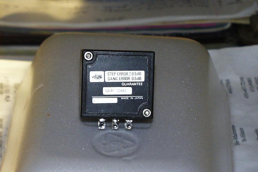

moving_electron said:
Keep in mind I am wanting a 100k linear stereo pot. I am definitely in.
moving_electron, is that even one of the options?
There are basically two shipping prices quoted, one in this thread ($11 flat rate US) and one in the wiki ($4 packing -- is this even a shipping rate?). Which is closer to the real one?
