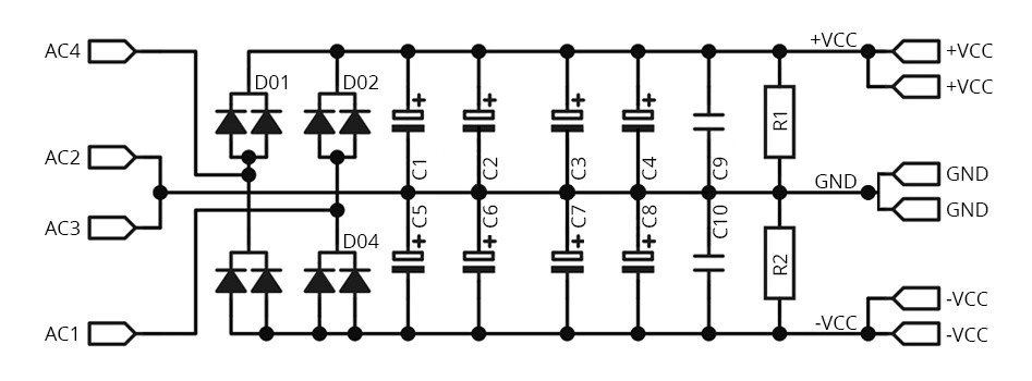

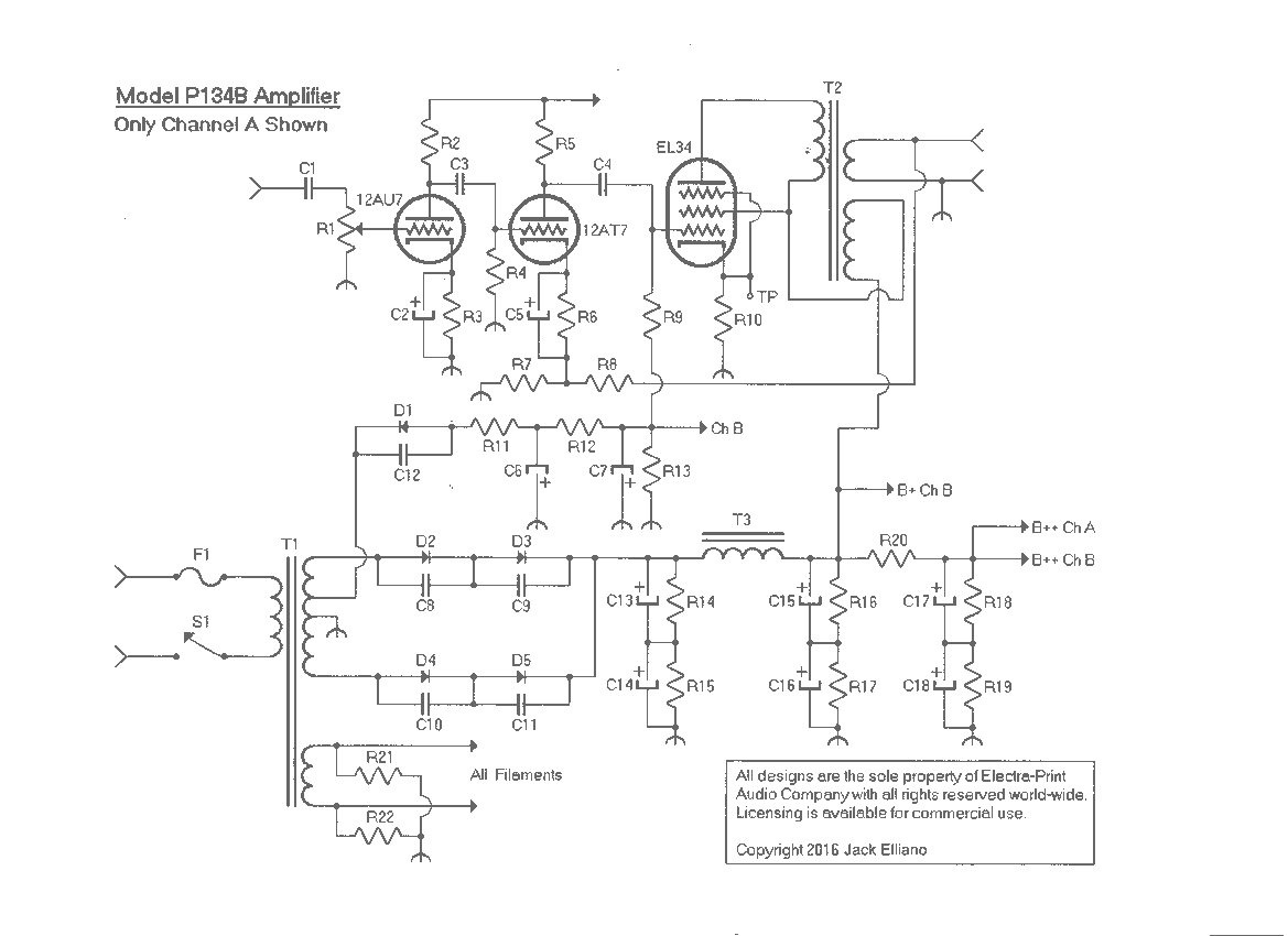

I would at the least like to see the power transformer winding arrangement, but as shown it provides a pos and a neg voltage.
It looks like a bipolar supply for a high power transistor amplifier.
To use a T-reg for the L and R channels you would need a pos voltage for each T-reg, no?
Jan

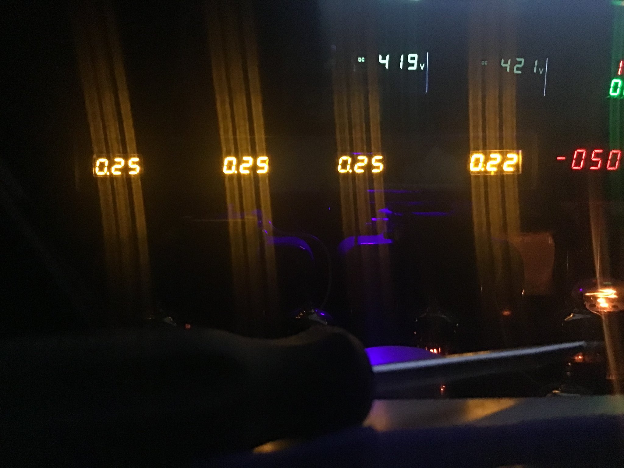

Update. I've been running two T-reg 5s on my dual-mono modified HH Scott tube amp since early last December and they have stayed within a volt or two of the 420V plate voltage ever since I'd set them back then.
The meters in measuring those voltages are generic Ebay Chinese 0-500V DC ones that I've included in a meter bridge behind the amp. It also monitors line voltage, bias supply and individual bias settings for the 7189 output tubes. Makes a nifty light show in the dark.
