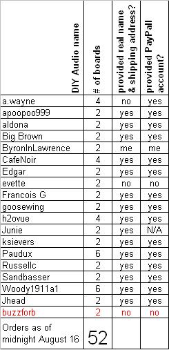

latest list of buyers
People have been sending in info, so here is the latest list.

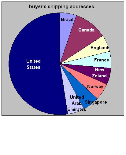

I also thought the plethora of countries represented by buyers was interesting and unexpected so I included this pie chart just for fun.

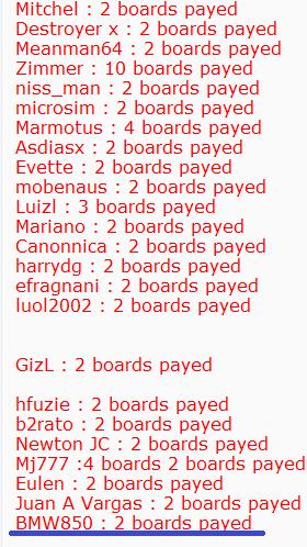

No Russellc, you are not a dead-beat. Or . . . at least you don't owe me any money. :p I haven't sent out any invoices because I have not yet received the boards and deemed them acceptable. Boards are expected to be shipped August 18, which means I'll probably get them Aug 22 or 23. If I decide they are what I ordered, I will send out invoices.

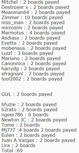

You should really contact Patrick (Meanman) to confirm your presence.
Because your names are not in this list..this is the last list before he ordered the manufacturer to go producing boards..Meanman have already had green light about the board gerbers...it is possible he may be running a separate list for diyaudio forum orders...as this list started and was populated by guys that belongs to other forum.
Maybe he has another list...you should try contact with him....he is busy but he may appear soon.
You see.... Russel was confirmed and he is not in this list...this seems he has another list...but...just in case..check this.
regards,
Carlos

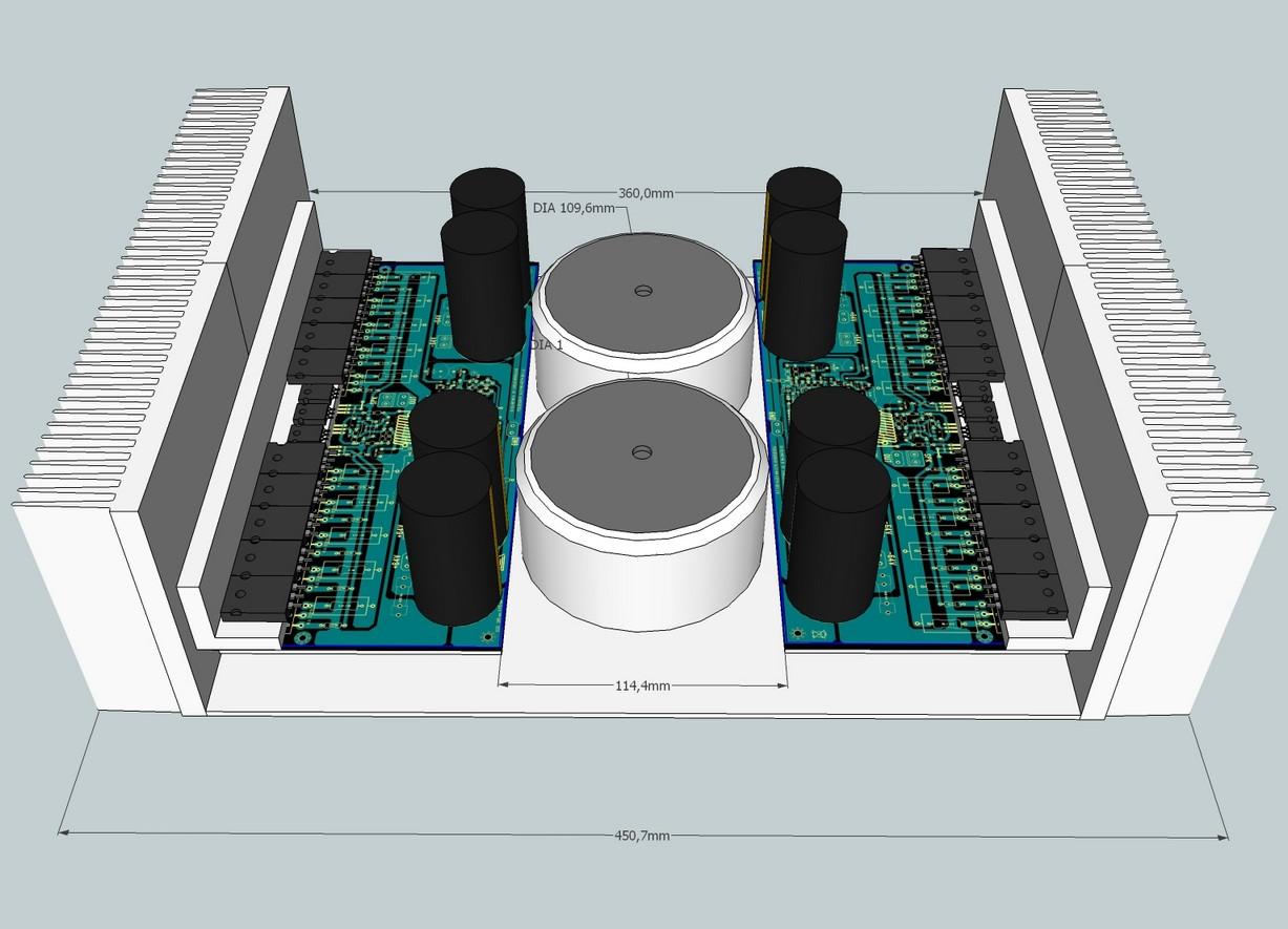

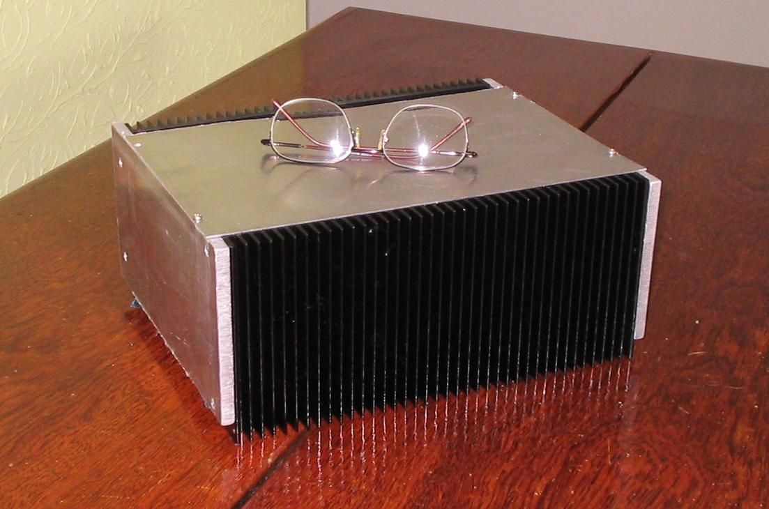

You are welcome BMW850
You may have 60 volts..and this is fine.
2000 watts each one?..... beautifull.... so, please, do not use 1 ohm.... the amplifier will burn..the output will melt...all them will melt.
With your transformer you may reach 1 Kilowatt each channel..... so, you need huge heatsinks.... install transistors with good insulators (Mica) and use thermal grease.... install transistors directly into the heatsink and avoid the "L" shape adaptor to guarantee your power amplifier survival.
For audio...music signal reaching 1 Kilowatt... with some distortion...peaks going to 1 kilowatt...then you will dissipate a lot of heat, and you will need something very big... i do think to both channels you may need to surround your enclosure with heatsinks...almost all sides covered with heatsinks and ... and heatsinks will be even bigger than this one in the attached imaged.... enclosure should be all aluminium to help dissipation.... heatsink show in the image will work for 300 watts each channel...... try to imagine what you gonna need for 1 kilowatt each channel..... 5 times more to a single channel...so... this enclosure show will never work fine, full power, having two channels inside.
7 heatsinks alike the one shown will be good for two channels... one at left, other at right side, other in the amplifier back panel, other in the amplifier frontal panel and three installed in the top cover..use aluminium enclosure...you may think i am exagerated...you will see i am not.
This amplifier is really strong... you gonna be surprised...also your speakers will be surprised....they may melt...better to limit your power using a couple of ohms resistors in series with your power supply rails...or speakers will go.
If you take a resistor made of thick wire (1 to 2 milimeters diameter) and produce a 2 ohms load.... if you install this load in this amplifier and put the load inside a glass of water, the watter will boil in a matter of seconds.... it is really strong...be aware of that.
Do not use the way you see in the 3D image.... this "L" adaptor may create problems.....if your board have the excess to be mounted this way, then saw the excess of in order to assemble transistors directly into the heatsink...without "L" adaptor.
Adjust your power amplifier reading 1 milivolt over each power emitter resistor, to avoid too much heat.
These heatsinks show.. my enclosure over a wooden table, was not very good for a single channel pumping out 500 watts RMS.... so, imagine yours producing 1 plus 1 kilowatt.
regards,
Carlos

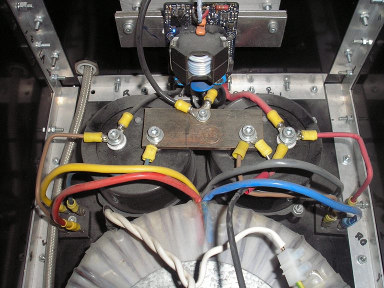

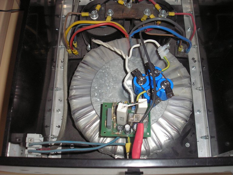

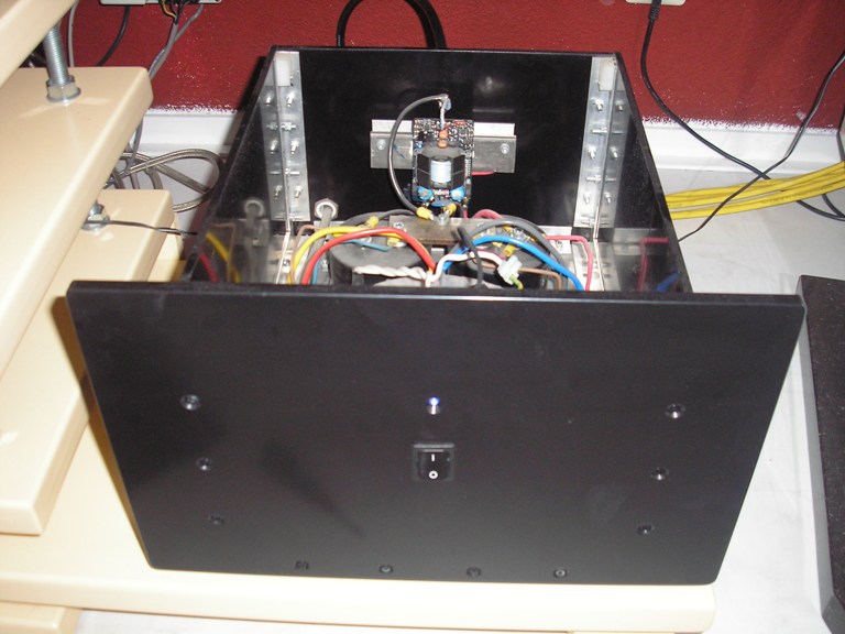

This is my Zappulse 2.3 amplifier monoblock, not to watch the dust

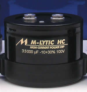

The 2 elco's are Mundorf 47000uF 80V MLytic High Current I hope that this is enough.
This is a homemade Cabinet, front is 10 mm thick and side panels and bottom 6 mm thick.
Hopefully I can build everything in here, only the Mundorf 47000uF 80V MLytic must be moved.
Rudy
