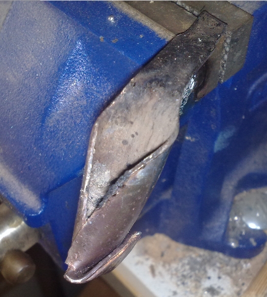

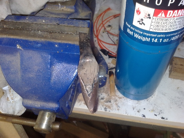

This recent activity reminded me to post about my trials with the Litz wire. So far I've found no solvents (acetone, alcohol) that work to remove the lacquer coating. Dipping it in a homemade solder pot (per Alex's suggestion) didn't work either. Solder "pot" was heated with a propane torch, then loop dipped in, but nothing happened.
I was able to burn off the enamel with a torch, but it tended to make a mess of carbonized material that I had to wire brush off (not all came off this way) and I still couldn't get the silver solder that I normally use to take. Loop ends would come out solder-free.
I'll keep trying.

The solder pot has to be really hot. Just melting the solder is not enough.
I heat my solder pot to the point where it begins to glow orange.
I also dip the tail in isopropyl alcohol, give it a quick shake and then dip it into the solder. Seems to allow the solder to flow more easily.
Please make sure you use safety glasses for this! (I know you do Carl )
No point giving your ears a treat if it costs an eye!
Alex

Just as Alex notes, very hot indeed. We run out commercial pots at 580 F for 60/40 lead tin and 640 F for silver solder. We use a kester liquid flux, one that can be cut with alcohol and mix it with the alcohol to a weak tea color. This allows the alcohol to ablate the wire insulation and the remaining light flux to insure complete solder contact with the brite clean copper/ For Litz this is the only sane way to progress. May I suggest that you check around in your local area for either transformer companies or motor rewind shops. Both will have commercial solder pots available and can tin your wires in a few seconds.
If you can fins no one PM me and you can send me your wires and I will tin them for you.
