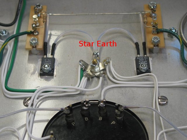

Hello Michael,
I couldn't agree more about star grounding. It works, period.
I built my RH84 as a sort of multi-faceted experiment. First, I wanted to see what all the fuss was about regarding this design. Now I know. Second, after seeing Pete Millet's amp I wanted to see for myself if the ground plane thing really works.
Honestly, I'm not sure if it's the little ground plane itself that makes this amp so quiet. All I know is that it's certainly possible to employ the concept intelligently and still end up with a quiet amp.
When I rebuild this amp to its final configuration I'll probably employ a separate ground plane for each tube socket, then run a separate wire from each plane to the ground of the second filter cap.

I'm not sure exactly what your claim is but I would suggest that a "large low resistance area" is not equivalent to a single point.
I claim that by it's very nature a ground plane creates multiple ground paths for each connection and by definiton creates "ground loops". A finite element model of a ground plane looks like a grid of low resistance elements between the nodes where connections may be made. It's the job of a good layout to minimize the overlapping signal return loops and thus minimize crosstalk.
By contrast a single point return is by definition at the signal zero or neutral point. No overlapping current loops are possible.
I guess if you make the ground plane thick enough, the distributed resistance is low enough to act like a single point and there will be negligible crosstalk. In practice this may need to be impractically thick to completely ignore the resistance and relax the layout constraints.
Michael

If it's a true star point there is no potential difference. All the return currents go through a point, so no current can pass from one circuit to another.
I believe the common area in this example to be about a 1/4" diameter cross section of copper and aluminum about 1/8" thick. sure a finite element model of this pea-sized chunk contains multiple ground paths but at this point I let quantum mechanics take care of it
Anyway if one can see the multiple paths in a short star connection like this then certainly the multiple paths in a ground plane becomes apparent.
Michael

If I understand correctly, I don't see how that would happen in any normal situation. Electrical codes and product safety practices practically guarantee no current flow in what is called over here the "equipment grounding conductor" i.e. the green wire, which is what I believe you refer to as the consumer unit ground. Can you be more specific about which two points you would measure a voltage difference?
In the example photo above, the green wire also connects to the star point along with the other signal returns, so there is really no current between any 2 circuits passed through this connection. This connection is the ground, hence no potential difference between this point and any relevant "ground".
Sorry for seeming dense, but I'm not following how a star ground can have a voltage offset... to where?
Michael
Star ground can have a voltage offset to a star ground in another box that has common connection through the power outlet.
