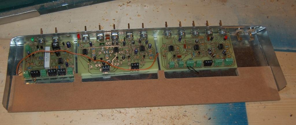

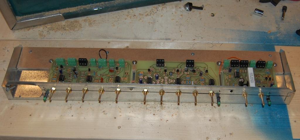

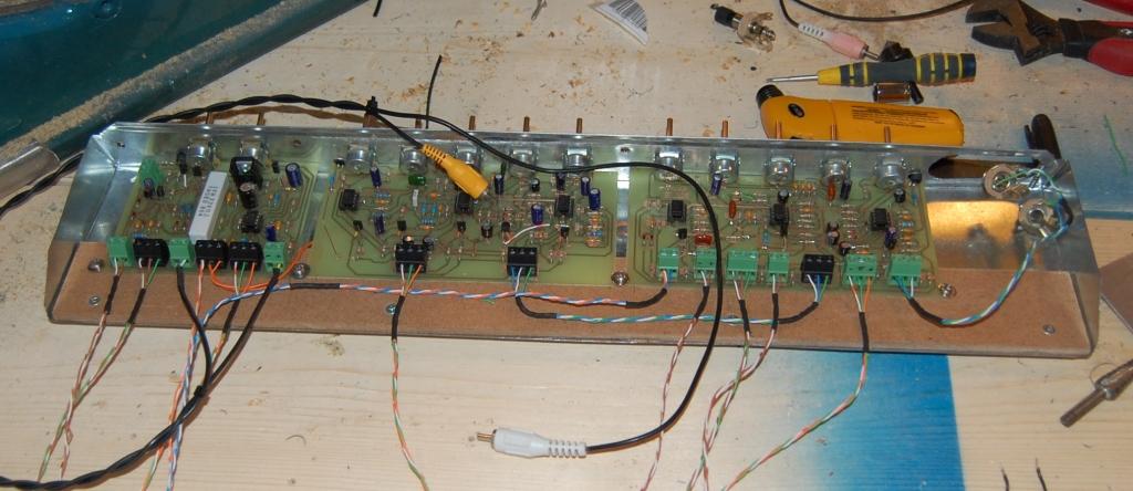

I briefly powered everything up last night, after I finished the preamp tray wiring. It's all good except I have a hum coming from the reverb board. Further investigation is warranted.
I'll say this: building a combo amp like this is tough! I've built some detailed and involved projects but this outstrips them by a wide margin. All of the parts, controls, switches, wires, wires and more wires. Circuit boards, metal work, wood work, 1/4' jacks with switches, transformers, reverb tank...all crammed in. It's a marathon project, for sure.

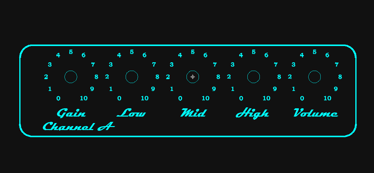

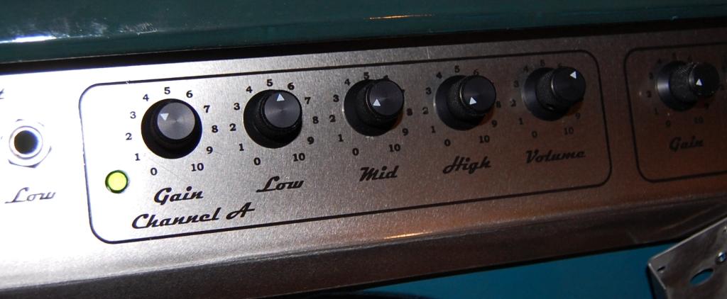

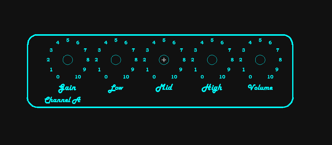

Did a little layout for the front panel:
This gets printed in reverse and ironed onto the stainless steel faceplate. I'm on the fence about the font, I might change it.

Agreed about the fonts, and an old-school split panel design would look really good.

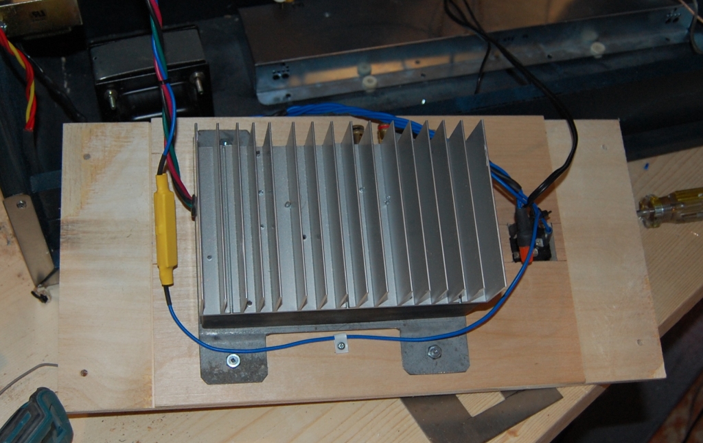

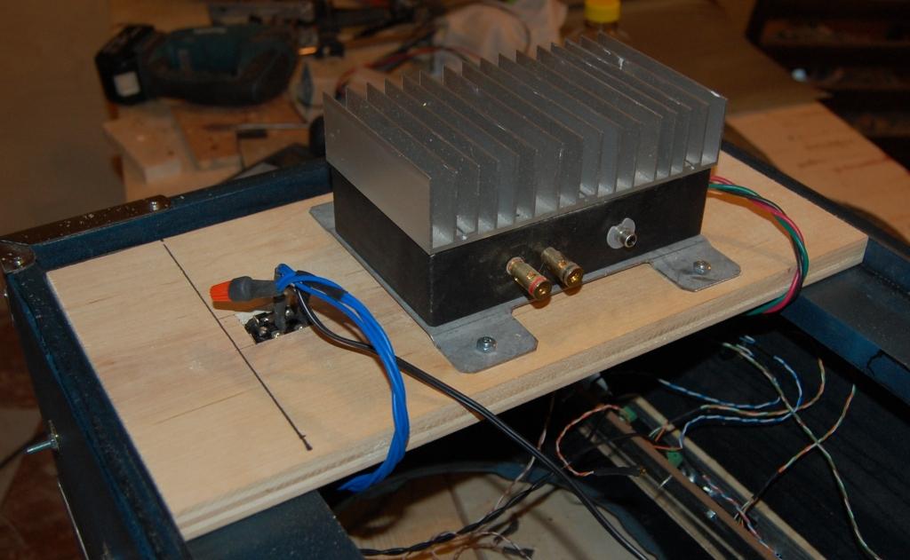

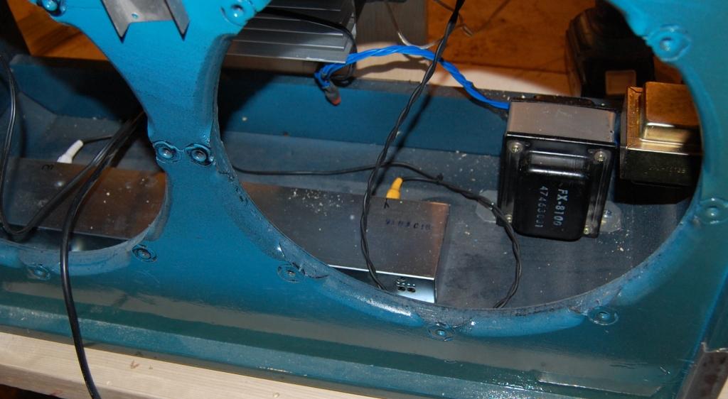

Mounted the power amp on a board that will partially cover the back:
It will be in the middle of the open back and provide some support for the cab as well. I figured this is the best place to put the amp (mainly because there wasn't anywhere else to put it).

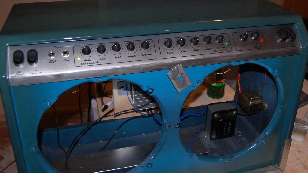

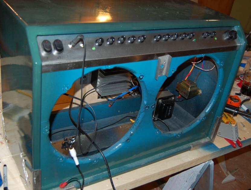

Wired up and mounted the power transformers and the reverb:
Reverb pan is too close to the big transformer and that is the source of the hum I mentioned earlier. I'll need to either move the tank or try to shield it somehow. PITA.
Put the switches in the front panel:
and turned it on and tried it out. A couple of snags (as usual) - the reverb pots are reversed. Actually they aren't but the preamps are. I put B first then A - B is clean, A is distorted. I want to redo the reverb board anyway, so I'll switch the pots then.
The switches have red LEDs in them. These were nice and cheap from Digikey so I bought 10 of the same to get the better price. I figured I would use them without powering the LEDs - no problem but 2 need to be upside down, with the LED on the bottom. "Bright" is defeated with the switch on, "reverb" is off with the switch on. Not a big deal - nice to have the LEDs all on the top but I can live with 2 on one side of the amp down.
Works really well. I have a line on a loner guitar that I can plug in and make a racket with soon.

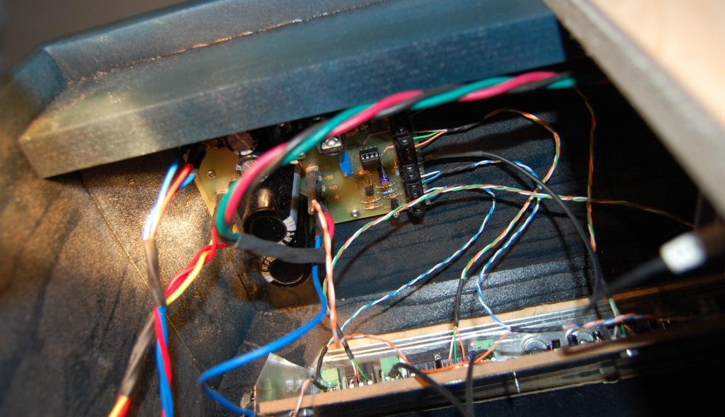

Getting some more details cleaned up today. In my pursuit of the cause of the reverb hum, I tried a couple of things - process of elimination. One was to regulate the 36V supply for the reverb drive circuit. That made zero difference to the hum. Next I redid the ground connection, adding a 'disconnect' to the safety earth. This, again, made no difference. Of course, I have since found the reason for the hum (proximity to the main transformer) and rectified the problem.
Having fixed the hum, I tried the regulated supply again and found that it made absolutely no detectable difference. Based on this, I removed it from the circuit (air-wired in place, roughly).
The disconnect was another story though. This did make a notable difference to the amount of audible hum with the gain at max and volume at max. I kept this improvement and wired it in permanently. For those who don't know what a 'disconnect' is, it is a low value resistor (<100 ohms) bypassed by opposing diodes. I used a 36 ohm 10 watt resistor bypassed by two 1n4004 diodes.

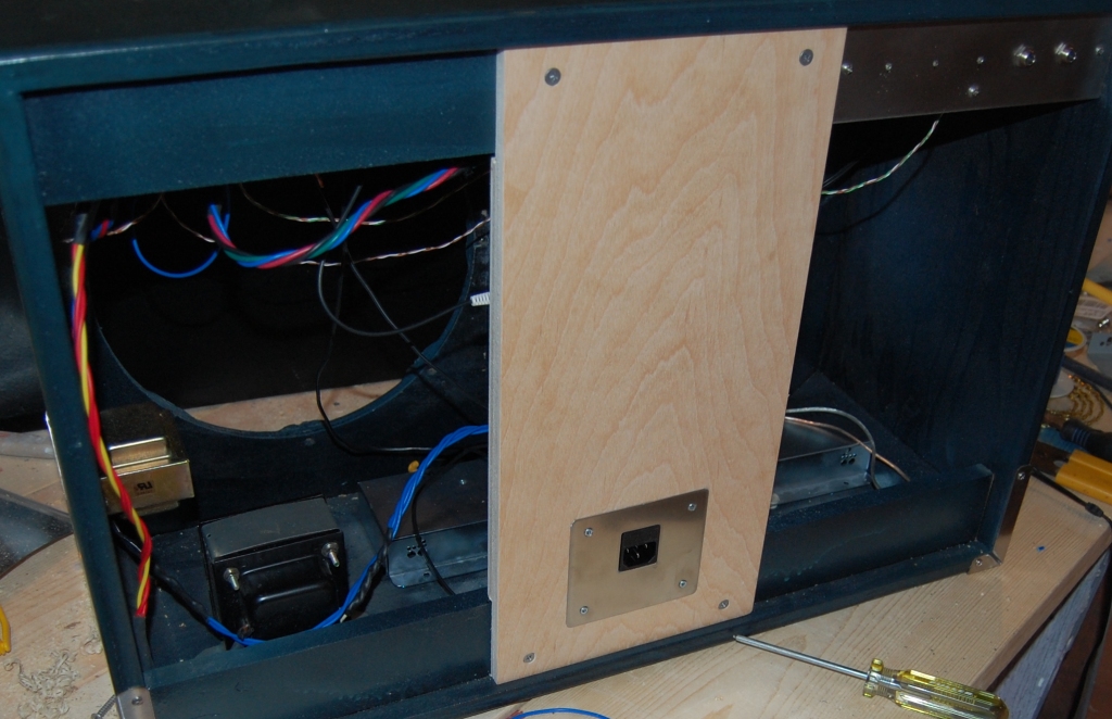

I shaped the back mounting panel and reattached the power amp. Seen in this pic is the ground disconnect (in yellow heatshrink):

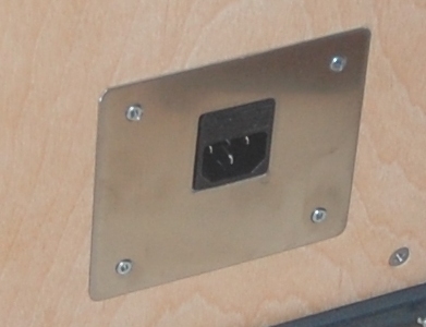

also seen is the fused power entry module, mounted in the panel. Notice the use of heatshrink on all of the faston connectors and even the marette that splices the neutrals. I like to reduce the chance of accidentally touching mains voltage if I can avoid it. Before I'm done, I'll cover the back of the power entry with a grounded metal box to completely enclose all exposed connections.
Here's the back panel mounted:
it's 3/4" birch veneer plywood and I rabbeted the top and bottom to fit around the horizontal rails of the cabinet. This sets the panel in a bit and looks better.
The power entry is held in place with a jam plate I made from stainless:

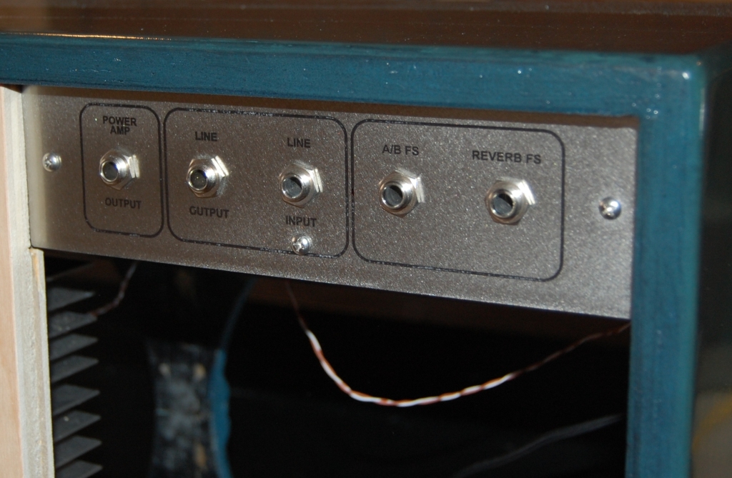

20 or so of the 1001 details reside here:
The back plate. Stainless steel again with the lettering toner transfered on and coated with 2 layers of clear spray lacquer.
Originally, I was going to have the effects loop on the front panel but there isn't enough space. Adding the power amp out was a last minute decision. Nice to have the ability to make use of the amp on its own. Plugging in defeats the cabinet speakers.
