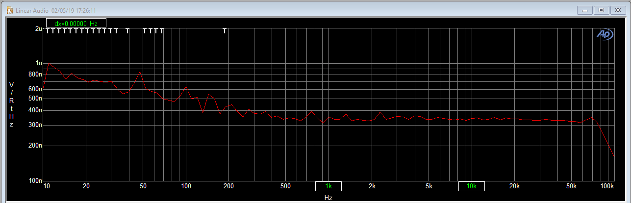

I also found my best result, 2nV/rtHz @10Hz, the noise corner frequency is about the same, between 200 and 250Hz. This one has lower noise @10Hz simply because, by pure chance, the 8xBF862 have close to ideal 1/f noise, dropping at 10dB/decade.

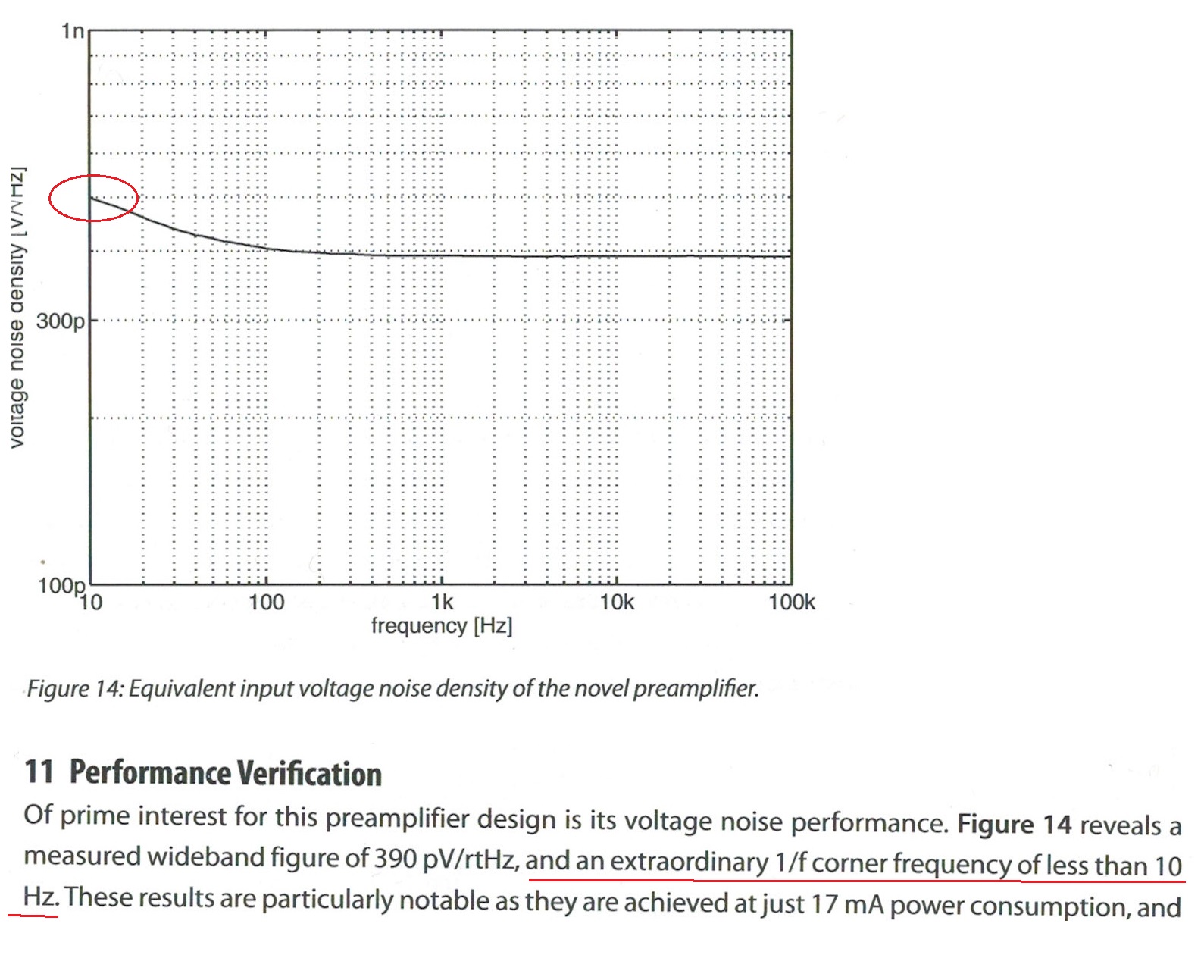

And also attached is fig. 14 of SG article in LA, his voltage noise results and comments. I hope this is considered fair use, otherwise some moderator can remove the attachment.
NXP claimed 800 pV/rtHz at 100 KHz and Idss.
I found Idss to be 12.x mA when I measured abt. 150 pcs. ; reducing this to 1 mA
per transistor would decrease gm by sqrt 12 and noise performance by sqrt sqrt 12
= 1.86. So, typical voltage noise would be 0.8nV * 1.86 = 1.49 nV/rt Hz for 1 transistor,
at 100 KHz. With 8 transistors, we would end at 527 pV/rtHz, still respectable.
Then there is the 1 Ohm source resistor that adds geometrically 129 pV/rt Hz.

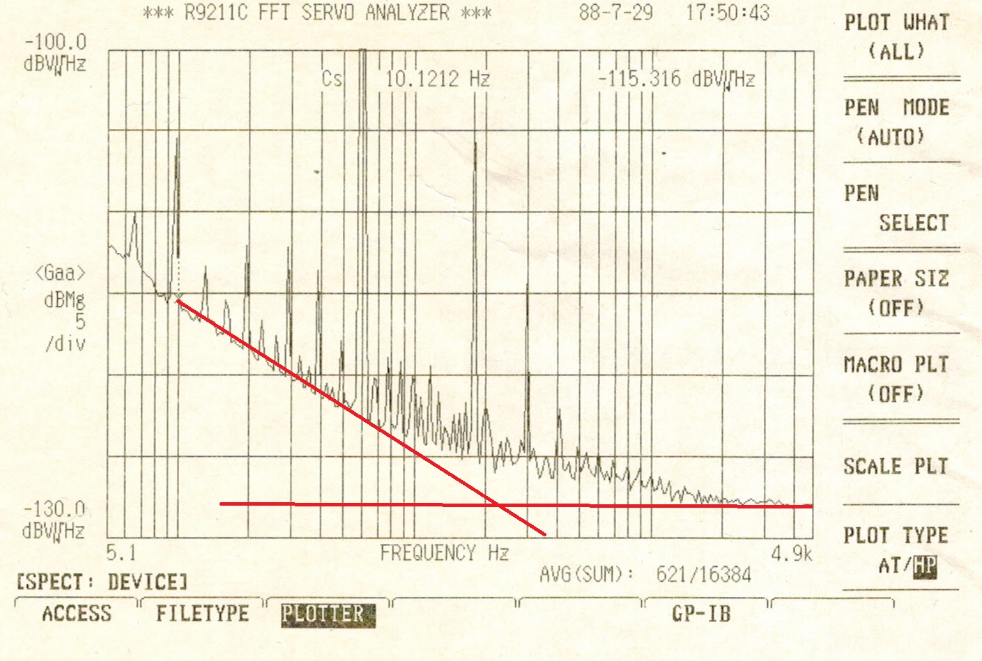

Well, yes, lowering current lowers the 1/f noise and increases the flat noise. I did both @1.5mA (the results posted above) and close to Idss, and the noise changes with much less than the current ratios at the 1/4 power. I was myself a strong believer in the 1/4 law for noise to current dependency, but found experimentally the exponent is more like 1/7...9. I cannot explain this on stationary device physics only, I'm pretty confident it is largely a thermal effect.
The 1/f noise increases significantly with the drain current; at Idss=15mA noise @10Hz is about 8-10nV/rtHz, so a x5 increase over the Id=1.5mA case above.
Thought myself about some LF gain issues, and Jan's results seem to suggest something like this (see the noise drop around 10Hz).
Fair use is OK with me. I blew up that curve I posted before, and indeed there seems to be a difference. To be fair, I should run a baseline for the AP itself as well of course.

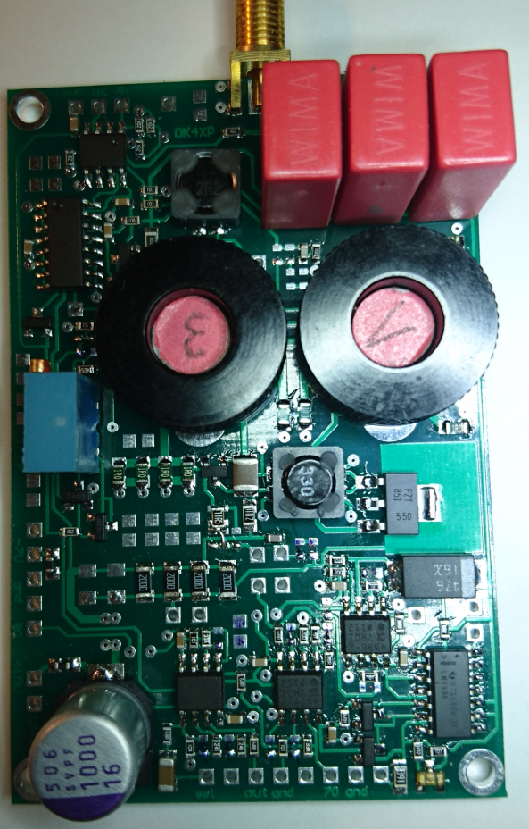

With organic polymer alu I could have shaved off a few op amps and their noise current with the same result.
Panasonic SEPF proved to be no drawback as I found out in the 70 pV amplifier from
AOE III. But to be able to say that the Panasonics are no drawback, I first must have
the wet slugs in NEW state to compare with.

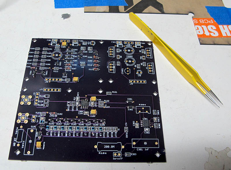

Told you I have little interest in massive bipolar paralleling, be it transistors or opamps. What input impedance can you count on this 20 x ADA? Any added resistor in parallel with the inputs will add to the input current noise, so not only are you restricted to very low source impedances, but also to very low input impedances, which in turn may load the DUT batteries with high currents. IMO a mess to manage.
My JFET input LNA uses a film 1uF in 1206, wtf, why would I invest in a $150 wet slug?
I’ll show you when I’m done a 64 x BF862 LNA. Preliminary measurements are showing it’s also around 0.25nV/rthz.
About 10K.
Plus 10K, unlike your HPS 5.1 in the simulation 10 posts above, that turns to a negative

> spending $150 or more on wet slugs, interfet devices to sort from, or opamps to parallel.
So what. One IF3601 for €18 delivers 300 pVrtHz with 30 Hz 1/f corner. Not at 5 mA
as promised, but at 12 mA. That's not far from the 250 pV you claim for your 64
BF862. I can see no financial advantage for the BF862 herd. Probably there is
even room for a IF3602 dual which would take the lead noise-wise.
