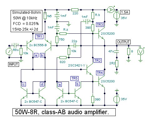

Your biasing arrangement has five more transistors than my original, without much real world advantage.
It is possible to double the output of my amplifier for the same quiescent dissipation by adding two small signal transistors as with the attached circuit. I first did this for 100W - 4 ohms in the 1970's using triple parrallel 2N3055. Actually the dissipation can be further increased, but the amplifier is then a little slow to 'warm up'.

Had some off set problems Graham, can you please
Send as soon as possible, some explanation about the circuit , the DC voltages and the calculation of RZ and RB.... almost ready to run, the 50W unit, the new one.
Some support text is beeing needed to turn off set zero.
I want to know the DC voltages, send those informs directly my Mail

Hi Carlos,
Do please note that this is a much less technically accurate circuit than pure class-A.
In a simple circuit pure class-A is much more competent, but not efficient and not good into loudspeaker impedance dips.
The extra mirror and resistor are added to pull driver current out of the output stage and thus reduce heat for a given power, but the output device currents are no longer matched and they rely upon NFB for output terminal accuracy.
This circuit also relies upon power rails coming from a single bridge, or at least identically from the same transformer winding so that the bias current and sink current approximately track each other.
Forget R.z unless you want very low output offset potential.
Leave out the additional 820 ohm resistor and first set up as a class-A amplifier with R.b between 180 and 390 ohms.
After you are satisfied that the amplifier works well in class-A insert the 820 ohm resistor so that the mirror sinks output bias, then slowly reduce the value of R.b until the quiescent current comes back up to the required value.
Hope this gets you going.

The amplifier is now running well and sounding good.
