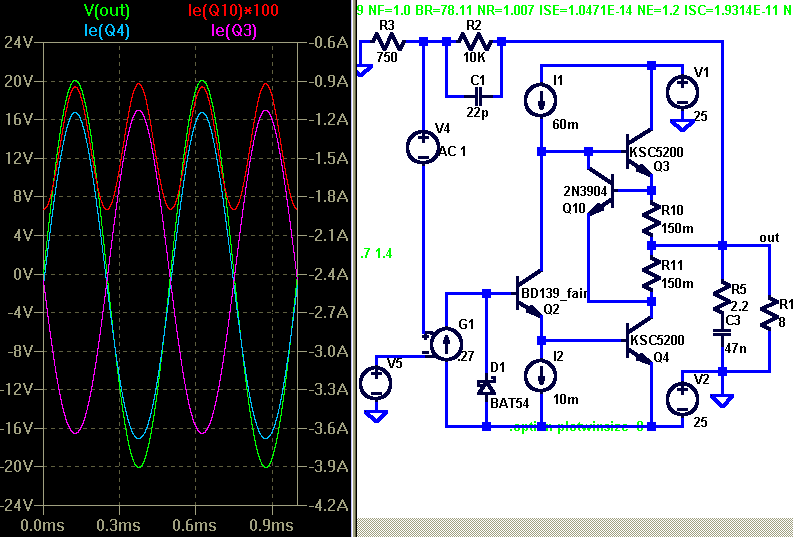

I’ve been fooling around in sim with a class A bias scheme that can enforce symmetric current division that turns out to fit easily to the jlh output
Q10, R10,11 form a classic 2 transistor feedback current source with Q3,
Iq = Vbe(Q10)/(R10+R11)
The upper bias current source is increased to provide working current for Q10 (~ 14 mA in this sim) – this has to be large enough to supply excess output Q Ib to compensate for the hfe mismatch of the output Qs over their operating range
In the sim this local current sensing bias scheme manages to match +/- Ie symmetry to 3% while setting the output Iq without repeated iterative bias adjustments
The current in Q10 is largely 2nd harmonic, but interestingly this results in raised 3rd harmonic output distortion – increased symmetric distortion can be expected to lead to increased odd harmonics
{having problems with photobucket so you have do it the "hard" way}
jcx
I've had a quick look at your proposed biasing scheme and it does indeed produce full push-pull working (maximum output current equal to twice the quiescent current and sinusoidal current waveforms in each of the output transistors).
However, in the few checks I've done so far, the overall (simulated) THD appears to increase by an order of magnitude (or more), with all harmonics being increased by a similar percentage (judging by eye from the Fourier analysis, the curve of the peaks of each harmonic remains similar).
I suspect that the increased distortion may be due to the non-sinusiodal current waveform being transferred from the output transistors to the driver (phase-splitter) transistor, but I will look into this further when time permits.
Geoff

“This arrangement introduces an output stage sub-loop that interferes with the natural driver current splitting to the JLH output stage."
Lets think about just how “unnatural” the current regulation loop operation is
Q10 base senses the voltage across R10,11 that causes it to shunt a const current from I1 that maintains the current through the output Q3 that holds the voltage constant… (ie a current regulating a feedback loop)
Now suppose the driver shunts some current from the Q3 base node and adds it to Q4 base causing a differential change in Q3,4 output current, if Q3,4 match ideally (have the same, constant hfe) there is no change in the sum current measured by the sense resistors (the output difference current flows in the load) and therefore no change in Q10 collector current – the current regulation loop does not affect the ideal jlh differential drive operation
Since ideal differential operation is invisible to the current regulation loop the added load at Q3 base is only that of Q10 output conductance – >10K Ohm for real life Q10
Changes in Q10 collector current only reflect the mismatching of Q3,4 hfe – the non-ideal operation of the output transistors, what is the point of equally splitting the drive current into output transistors operating at different, diverging hfe?
I’m no advocate of adding distortion to a stage for no reason but consider the upsides in the tradeoff – accepting Rod/Goff’s 1.3X rule for the jlh Imax to Iq the current regulator’s enforcing symmetry gives 2X Iq output current– a 50% increase in drive current at the same bias level, and the bias level setting is simpler and more stable
Looking more closely at the distortion “cost” I see 3x more 2nd and ~10x more 3rd and 4th harmonics (vs 1st cir with 2.4A Iq – both using KSC5200 model), but the overall curve still drops with harmonic order and the “high” 3rd harmonic is 100 dB below the 20 V/8 Ohm peak rated output
If the output Q’s hfe are flatter and better matched, the current regulation bias should have to shunt less current dynamically, reducing added distortion
This current regulator class A bias scheme isn’t a general purpose approach but the main limitation, that it acts as a hard current limiter in one direction isn’t that different from the normal jlh current limiting when you run out of I1 current to turn on Q3 harder – the current limiting just occurs at a (~50%) higher current with the regulated bias arrangement

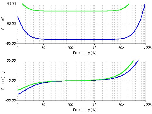

Hi jcx,
Well, it has now come to you assuming that I need to brush up on my reading !!!
Please find enclosed the simulated output impedance characteristics for my amp in blue, as well as with your bias network fitted in green. Do these characteristics match yours ?
( I ran 50mA and 5mA current sources for your arrangement. )
Your biasing network is the only difference between these two traces.
The effect of steady sinewave amplifier-loudspeaker interface amplitude distortion caused by loudspeaker induced back EMF upon amplifier output can be calculated from the numerical figure from the dB-damping figure, multiplied by the numerical Sine figure for the degrees of shift at the frequency of examination.
Illustrated are differences of between 3.5dB and zero degrees @ 200Hz, and 64.2 to 60dB and 16 to 24.5 degrees @ 20kHz. Thus your suggested biasing network increases loudspeaker induced distortion between factors of 1.5 at 200Hz and 2.4 at 20kHz, and this would contraindicate its usage where optimum treble clarity from the simple JLH output stage is required.
* This has nothing to do with forward simulated and measured sinewave distortion, nor prime frequency ratios !!! *
Can you not see that your bias control transistor works wrt the slow lower output transistor collector. In a JLH proper the bias is controlled by the much faster driver transistor. This is why the driver transistor needs to be fast, for a driver that is slow will increase phase change with a possible risk of instability as well as reduced clarity of treble reproduction. Similarly, outputs that are almost as fast as the driver could oscillate; this is why I use the lower impedance Zobel, without any need for stabilising capacitors.
If you want to observe the first cycle or steady sinewave distortions that arise due to loudspeaker loading an amplifier as loudspeaker crossover network capacitors momentarily behave like short circuits to audio transients and inductors build up their magnetic fields before passing current you need to simulate with a virtual loudspeaker load, plus fundamental null the output.
The dB damping figures for original JLH designs tend to be circa 30-40dB, and this is mirrored by the substantial improvement in high frequency reproduction clarity with my 25W design, with its increased open loop gain / NFB.
jcx, I believe you mentioned an increase in NFB for your biasing arrangement but I cannot go back to check your posts without losing this window. I find only a reduction in NFB and thus a degradation in performance.
Are you trying to make some other point that I am not aware of ?
Cheers .............. Graham.

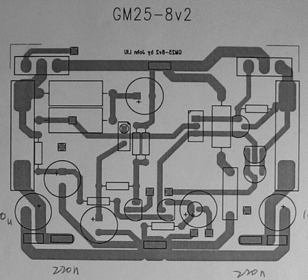

Hello Graham, and others,
Thanks for sharing the insights and proceedings of the JLHood-heritage in this thread and in the series in Electronics World.
I'm trying to unterstand this very interesting thread with my limited EE-education. It would be helpfull if someone could summerise the findings of the dialog so far; does it lead us anywhere?
Also, I'm interested in 'diy-ing' the GM-25/8 myself. I'm listening to the 1969-asymetrical JLH-version still frequently with pleasure.
I've noticed the photo's here of some-one that apparently made a pcb-design. Is this design available (or may be even a ready-pcb)? It would save lots of time for those who want to build it.
Best regards, Arjen.
Hi Arjen,
I very much prefer that individuals draw their own conclusions, rather than examine a concensus, for then there is less chance of ideological or theoretical entrapment.
The JLH amplifiers (and mine) are two stage and have a naturally good open loop af frequency response. With careful construction and device selection, stability does not need to be forced upon them by connecting tiny 'C.doms', which, with class-B output stages can lead to distorted high audio frequency dynamics when the loudspeakers generate back EMFs.
John Lui was the first to construct my 25W amplifier from scratch; he kindly forwarded me a photo of his pcb which is shown here.
He has implemented an excellent star earth, but has the Zobel components close to the input transistors. JLH type amplifiers have gain into the low short-wave frequencies, and thus output-input wiring separation is as essential as it is with a radio frequency stage; thus I would recommend that Zobel components are always spaced on the pcb.
I will forward my own hand-drawn (amateur but entirely functional) stripboard layout to anyone who requests it from me via
graham.maynard1@virgin.net
Cheers ............. Graham.

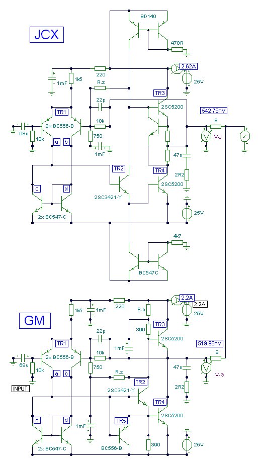

Hi John,
This is the comparison circuit I used. Your output stage has higher output current, but higher instead of lower output impedance.
Yes device gain alters output impedance, but it makes hardly any change on forward measured amplitude and frequency response etc.
Cheers ........... Graham.
