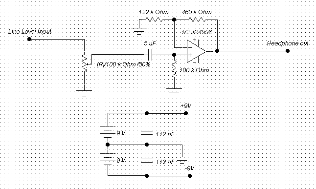

Hello,
I just made one for my 80i/MS1's. Here are the diagrams i used, i first made one on a prototype board before i found kits for sale on ebay. Have a search for RA1 kits as i won an auction for £6 which was a complete bargain as the board is very nicely made. I didn't use any of resistors/caps/vol pot supplied as i had better quality items to hand, but it was worth every penny just for the PCB. Well worth building one as it sounds very nice :hphones:
Have fun...

Hmm. I always thought the RA-1 were using an inverting topology. (But no, seems it's not.) Otherwise you wouldn't need these high resistor values for the feedback network which are needlessly increasing noise and distortion here.
The 4556 ain't a low-noise king but it is better than a 10k resistor in terms of voltage noise, and it would not be bothered at all by driving feedback resistors downsized to 1k2 + 4k7. Not to mention that an impedance imbalance of 80-100 kOhms (+ input: 0-20k, - input: ~100k) is inviting input impedance distortion.
A 10k-20k volume pot would also be preferred for noise reasons. Sources that cannot drive 10k with authority seem to be about as common as hen's teeth nowadays.
If you feel like going inverting for minimum distortion, you might try a 20k pot and 22k and 100k resistors, or a 50k with 47k and 220k, or a 10k with 10k and 47k (assuming your source is not bothered by 5 kOhms of load when the amp is cranked all the way up).
Basically, swap the 121k and 464k resistors for 1.2k and 4.7k jobs (regular 1% MF will do; you can go for 1.21k and 4.64k 0.1% if you really want, but that sort of precision is entirely unnecessary), and swap the 100k pot for something closer to 10k. Et voilà, a circuit that does exactly the same as before, except with less hiss and distortion. That's about as close to a free lunch as it gets.
I don't have good enough data on the 4556 to determine the improvement in distortion (going by the rather low input bias current for a bipolar, I'm guessing it may be less susceptible to input impedance distortion than other common opamps), but noise should go down by about 12 dB.
Unmodified noise levels are expected to be at about 27 µVrms across the audio bandwidth or -91 dBV, and would be audible on sensitive headphones and in-ears from about 120 dB SPL / 1 V up (even my old AKG K26Ps as small on-ear cans were rated 125 dB/V, though values that high are mostly reached by BA in-ears which can hit 130-135 dB/V).
Using the 4556 in inverting configuration may be most interesting when using it as a buffer and driving relatively high-impedance headphones, conditions that keep output stage distortion at bay while maximizing common-mode distortion in the non-inverting circuit (which is neatly eliminated when going inverting).

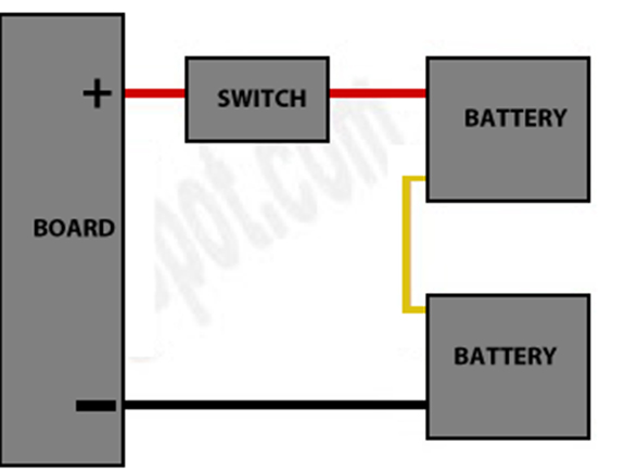

I just completed building the kit from Along. The switch that came with the kit didn't work so I have it hooked up to the battery clip directly. When I power it up it will play for about 20sec. then start distorting and cut out. If I disconnect the battery and connect it again it will do the same thing.
I have a feeling it may be a problem with the crappy pot that came with the kit. Can I just pull it off the board and run it without a pot?
It is probably just a typo, but you are referring to one singular battery. You are using both battery clips and two 9V batteries at the same time, right?
You really do need to use a switch with this because both batteries need to be connected and disconnected at essentially the same instant. If you are just disconnecting one battery but not the other you will put a DC voltage on your output (and headphones). Having only one power rail "on" but not the other has also been known to kill NJM4556A chips in the O2 amplifier.

There is something I'm not understanding about wiring the switch and 2 batteries :confused: This is how I have it now but I don't think the switch connection is right. This switch has 6 terminals which makes me wonder if one side should be for one battery and the other side of the switch for the other battery.
