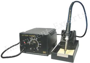

Atten have a range of solder stations... Products / Soldering Tools_atten
These use Hakko format tips that are available in a wide range of shapes and are economical.
Additional pencils are available quite cheaply also...cheap enough to permanently fit different tips and swap pencils according to need/application.
Search Ebay for "Atten"....stations, pencils, tips real cheap, and perfectly good.

Those are all Hakko 936 clones. They differ in build quality and temperature steadiness between them. Their price and Hakko tips compatibility format are their strengths.
The moment you jump over the Hakko FX category you get lighter handles and silicone cables, sleep functions, 10-20 sec heating up times, metal enclosures and trays, that kind of stuff. (The Hakko FX has a metal tray).

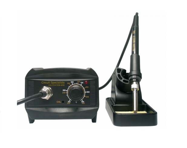

looks like the same solder iron used for some years in a BlackJack station
I don't know much about the US company Curcuit Specialists
but they appear reliable and always seem to have more or less the same stuff listed
and avilable from UK at 27GBP makes it tempting
and some of us does not solder so much complicated stuff
sure, I solder often, but mostly simpler things ;)
well, my loved gas iron is trash now ... with a handfull of new tips now useless :eek:
