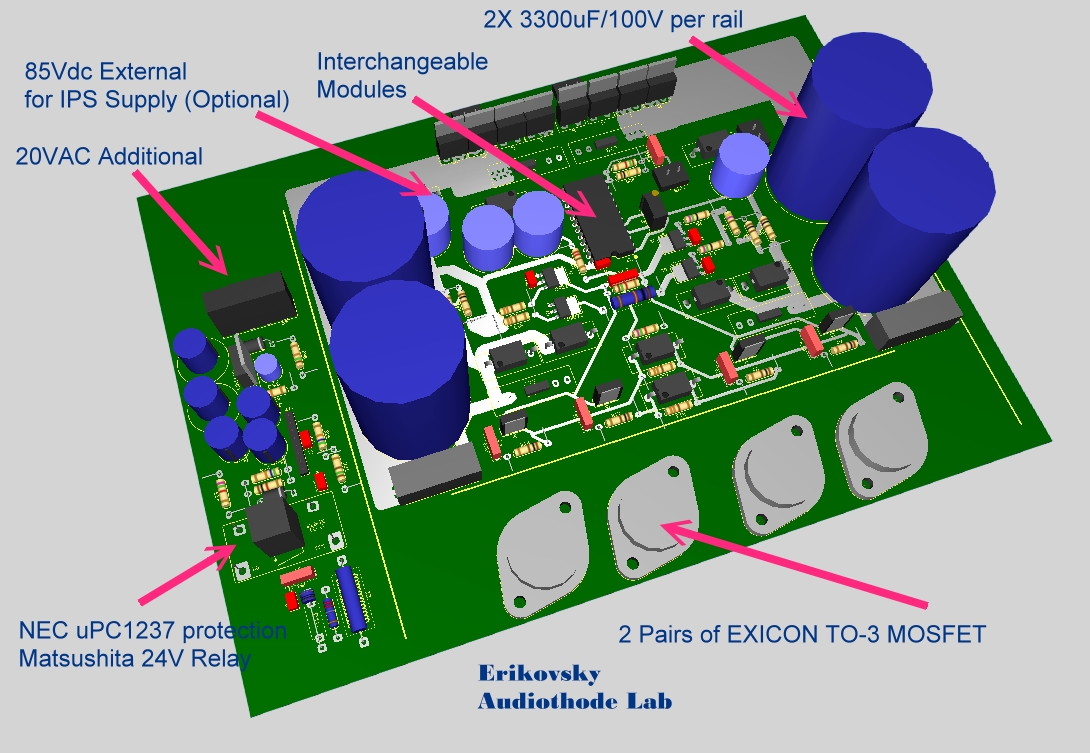

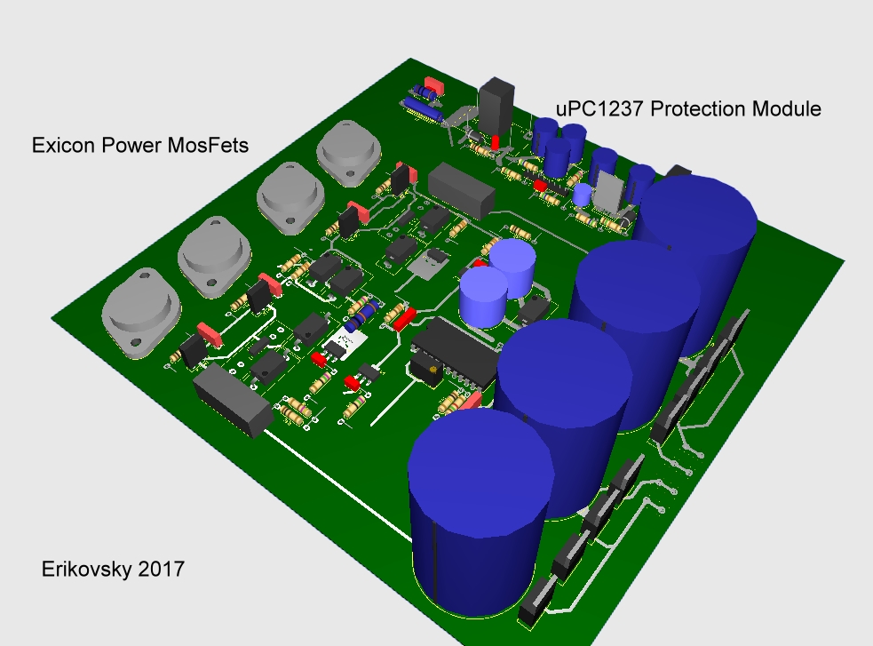

Which is the uPC1237 schematic you are using?
I have some from '90s Marantz power amps.
I use this.

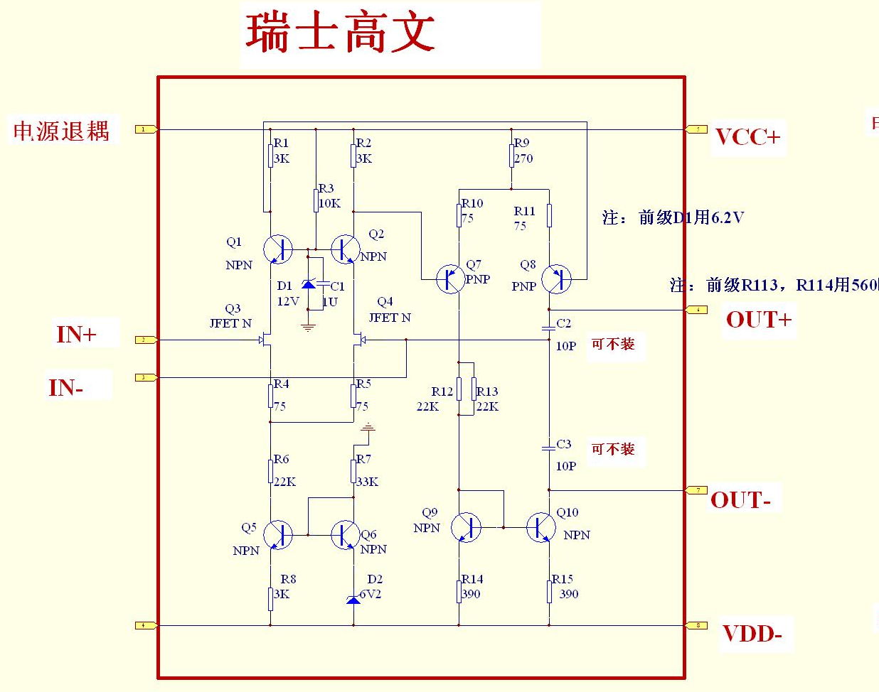

Maybe some of you know this Taobao site already.
Using their interchangable modules based amplifiers makes it easy to experiment with different input/output configurations. IE the Goldmund module as well as Accuphase, Pass and others are less than $1.

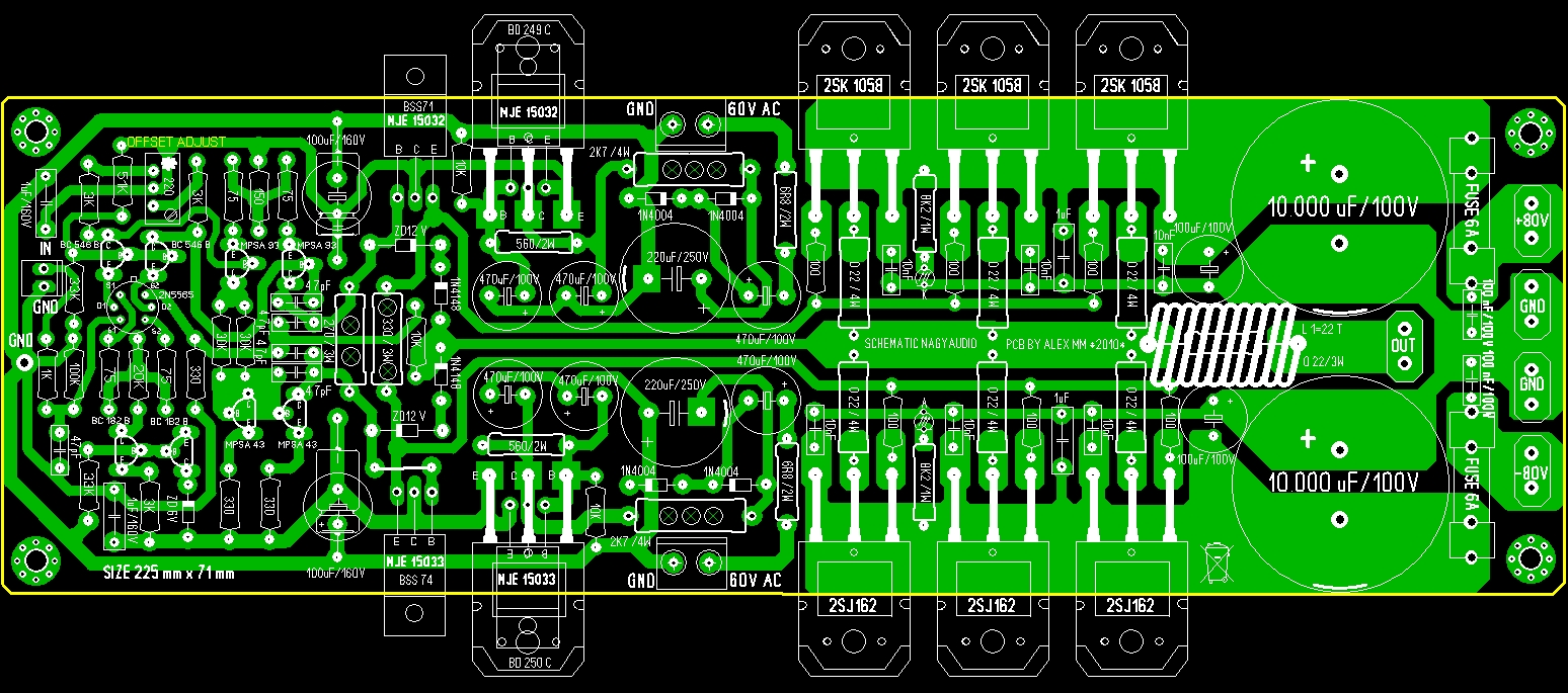

Ostriper Slewmaster and Valery-Jeff None Switching are very well documented and you can find all details here.

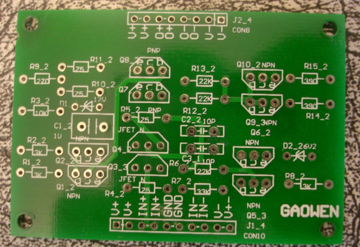

That design is really bad. I saw them before. They use IRFP for Goldmund!
Plus, the module uses disrete JFET. That's not even Goldmund!
That's the reason why I want to do a very delicate module and mother board.
There's a pcb for what they call "Goldmund bipolar", with bjt output, that is designed to be used with single or dual input fets.

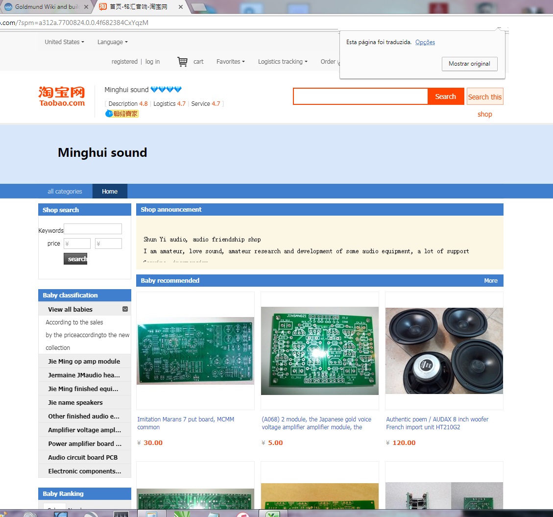

Is there any way to see that site in English? Google doesn't translate it.
Have you tried Google Chrome?
I use Google Chrome on Win 7 and Win 10, both translates well. But I do have experienced Chrome sort of being unable to translate even though it says it does. A reinstallation of Chrome solved this.
I can't find the 2N5564/5/6. So, I want modified some value of part for them matched to 2SK170 first. I'll replace them when I can see them later.
Please give me some suggestions to modify the circuit.
Thank all.
I can get 2N5564 as much as you want. Don't use 170, different sound stage, it doesn't sound like Goldmund.
