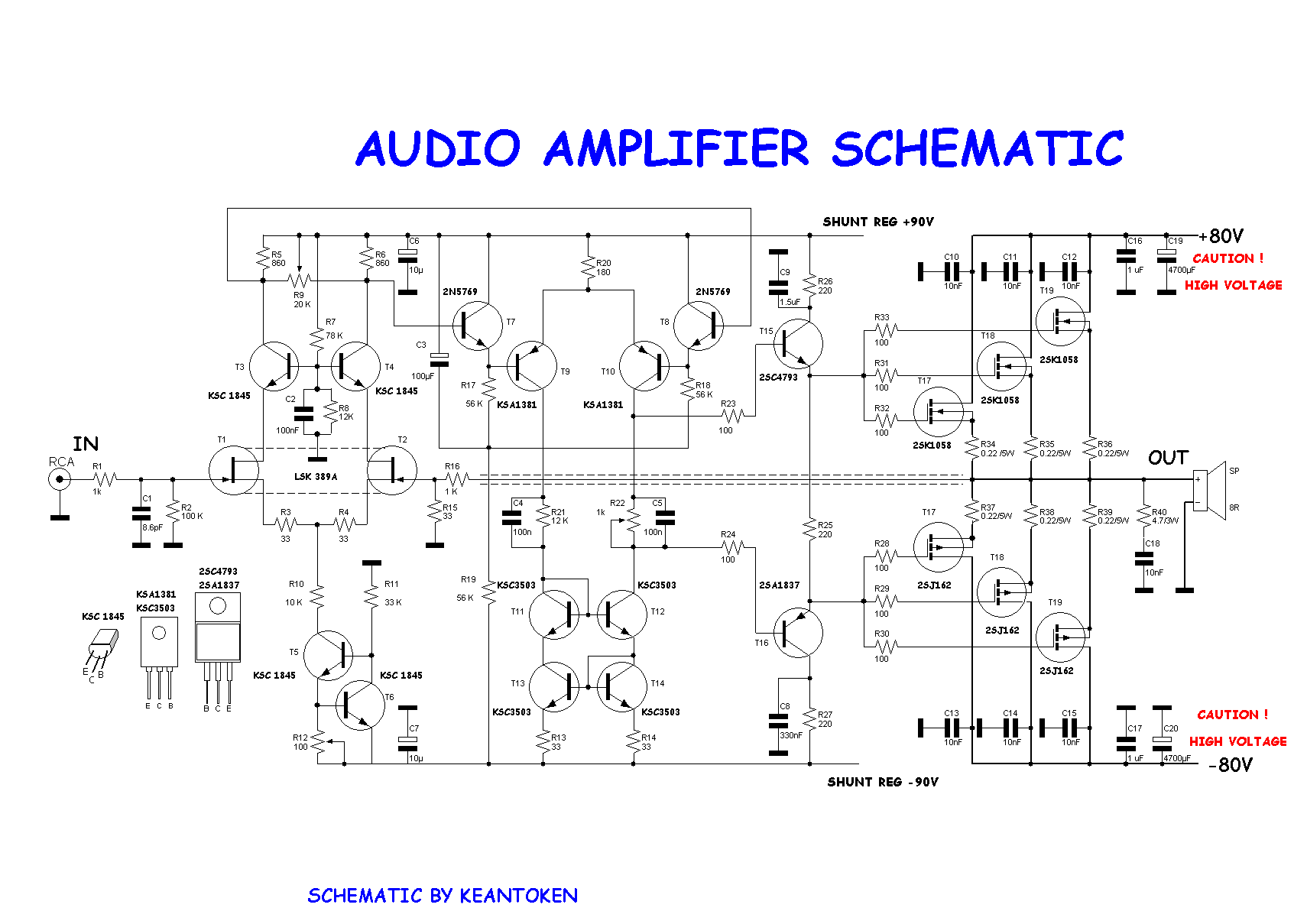

here
That schematic lacks a miller compensation cap for some reason, and will surely oscillate. Furthermore, the values are unrefined since it has never been tested. Base and gate stoppers should be optimized, as well as the output zobel, driver stage bias current, and pretty much all other operating points. Degeneration should also be optimized. This should be done by someone with a good signal generator, fast oscilloscope, and good speakers.
Also, I don't know if Digora means the schematic for my design, he may be meaning a different schematic.
I will get to this in the future, believe it or not. I still have all the stuff I've been sent.
- keantoken
