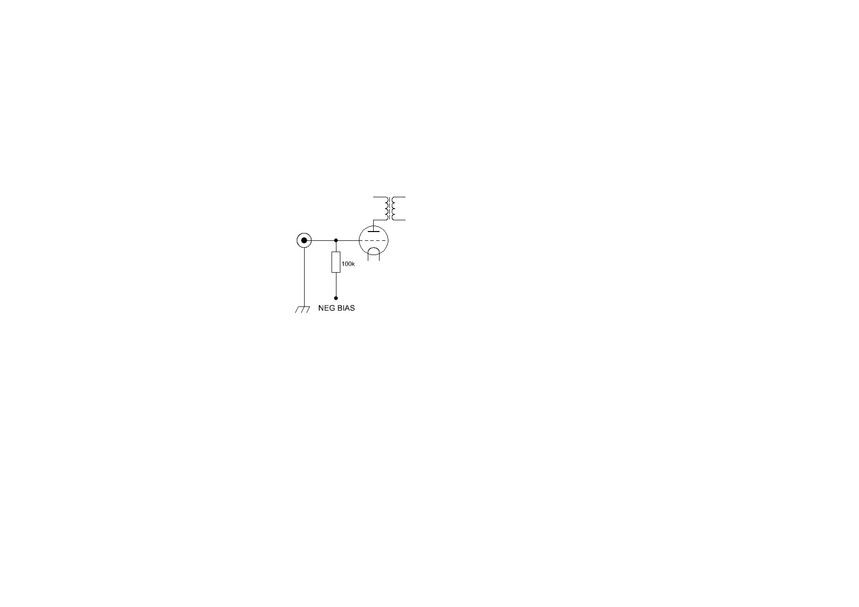

This is the schematic in the GM70 chassis.
Input resistor = 100K
Cathode resistors = 47ohm each
Any comments on the design?

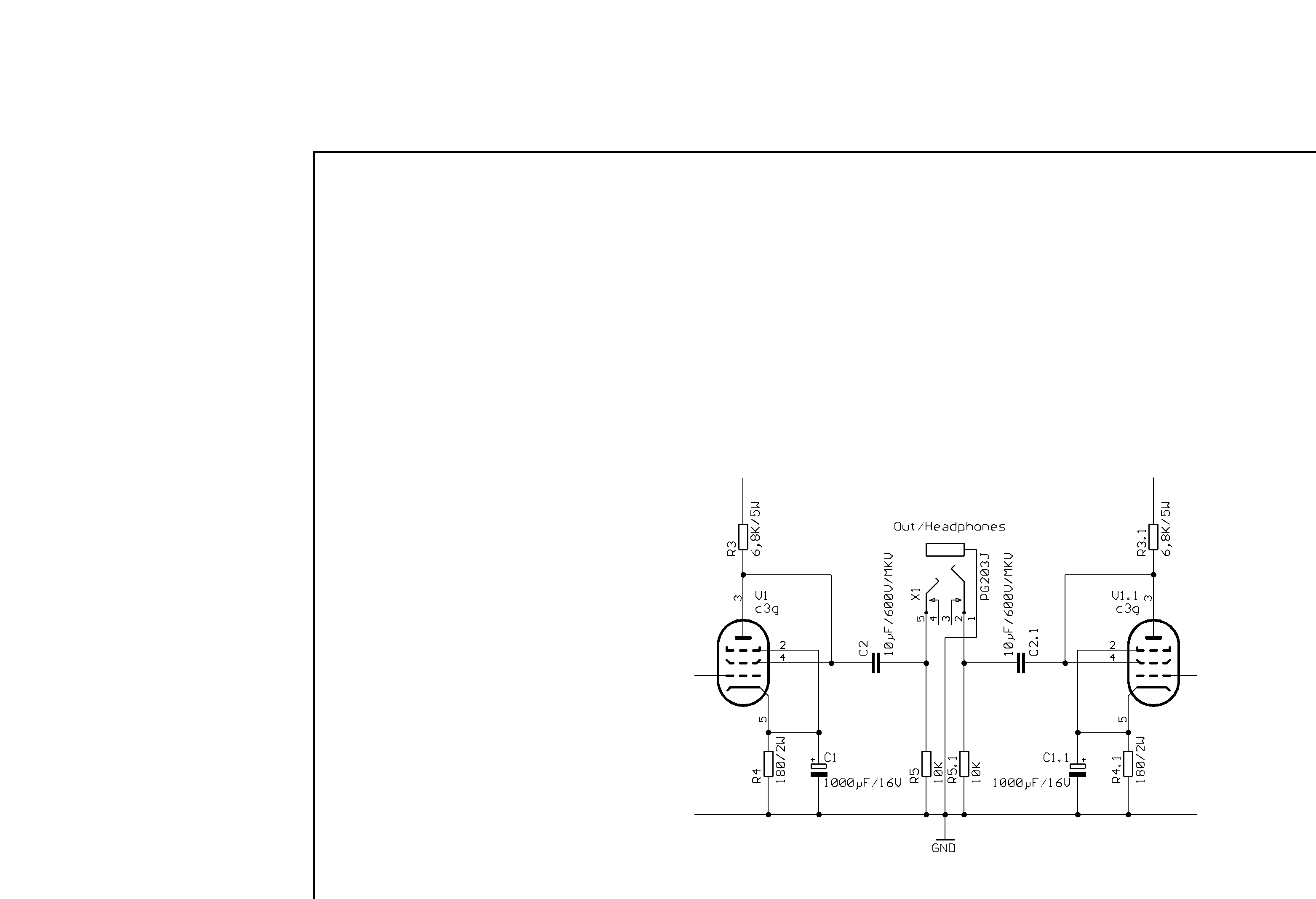

As for the C3g chassis, I have drew 3 versions.
Version 1: IT with two taps. One for headphones, the other for GM70.
Version 2: Cap coupling for headphones, IT coupling for GM70.
Version 3: IT coupling for headphones, cap coupling for GM70.
My preference is v1, follow by v2, last is v3.
Which one do you guys prefer?

I wouldn't do version 2 if I were you It won't work, try for yourself to find out why.
Whether v1 or v3 is better will be entirely up to the quality of the transformer.
Regarding the GM70 stage: The way you drew it now, the filament supply will need to be floating again. Also you need a resistor between the bias supply and the grid, otherwise you won't be able to superimpose an AC signal on it. And what is that 100K input resistor doing there??
Kenneth

This is the right schematic for the input.
Version 1 is best.
In this case the bias supply can be built into the headphone amp.
The two secondaries cannot be "combined" be making a headphone "tap" but must be separated so that the negative bias voltage can be applied to the tail of the 1:1 winding, and the tail of the headphone winding can be connected to ground.
Making this transformer is in good hands here.
Pieter

Tinitus,
The schematic is very clear: step-down for the headphone, 1:1 to drive the GM70.
Primary impedance is determined by secondary load, so for the headphone the primary impedance is 64 x 12 x 12 = 9216 ohms.
To drive the GM70 through the 1:1 the C3g will see the very high impedance of the GM70 grid, therefore the C3g is virtually "unloaded" and hence will give all of it's gain of 40 (in triode).
I am curious who recommended you to run the C3g in pentode UL, never heard of it.
You can use interstage transformers for triodes (pure triodes or UL); pentodes are not suited.
Pieter
