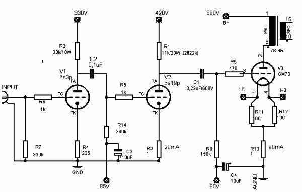

In fact, I think it looks weird too. The initial schematic was like this:
But I read somewhere that since Im using DC for filament, hum pot don't make much difference.
So I took it out and changed the schematic to this:
Then I thought since Im going to share a common ground for the filament and B+, the other side will be grounded anyway.
Thats why I linked it down to ground.
So what is the correct way of connecting it?

Both of the above schematics can be used when the filament supply is floating. In the first one, you can leave out the hum potmeter. Just join all three resistors together at that point. The function of the two upper resistors is to provide a path for the tube's current without shorting out the filament supply, if you use 100ohm for these they have a minimal effect on bias (a few volts) and the filament supply will only need to supply an extra 20V/200ohm = 100mA.
BTW, I agree with Arnulf and Kevin that fixed bias is probably better here. The GM70 sure likes a high B+ and it's a pity to waste it on cathode biasing.

Alright folks, looks like fixed bias is the way to go.

Correct me if my calculations are wrong:
preferred load for C3g = 8k~10k
headphones impedence = 64ohm
10k:64 = 12:1
The ratio to drive the headphones should be 12:1
Back to my question in the first post:
What IT ratio to drive the GM70?
How should I implement fixed bias for the GM70 without the IT in the same chassis?
Will this work?

You calculated impedance ratio. Transformer turns ratio is square root of impedance ratio (sqrt(10000/64)).
Yes on bias, but bias supply also needs to be connected to a common reference somewhere (usually this will be ground).
You don't need cathode resistors in this case (unless you want to reduce gain).
Regarding IT ratio to use: whatever suits you and sets big enough a load for the driver. If you need extra voltage swing, you can use IT to your advantage. If you don't, you can use IT to get more current (but since you're not going to leave class A1 this shouldn't be a concern for you).
You could put the bias supply in the preamp chassis, and connect it in series with the IT secondary winding.
Or you could put it in the GM70 chassis but then you would need an interlock of some sorts, to make sure that the plate voltage of the GM70 cannot be switched on if the cable to the preamp is disconnected.
oh, that means turns ratio for headphones should be 3.5:1?You calculated impedance ratio. Transformer turns ratio is square root of impedance ratio (sqrt(10000/64)).
The bias supply will be in the GM70 chassis. I intend to use schottky diodes for full wave bridging with C-R-C. Is a "clean" power important here?Yes on bias, but bias supply also needs to be connected to a common reference somewhere (usually this will be ground).
Please forgive this newbie here, am I right that I should isolate the bias supply first, ground the "positive" and connect "negative" to GM70 grid?
That means I just ground the GM70 filament supply?You don't need cathode resistors in this case (unless you want to reduce gain).
Still not sure how to find the IT ratio for the GM70. Do you mean that it doesn't really matter in my design? If 3.5:1 is the ratio for my headphones, can I just use it to drive the GM70?Regarding IT ratio to use: whatever suits you and sets big enough a load for the driver. If you need extra voltage swing, you can use IT to your advantage. If you don't, you can use IT to get more current (but since you're not going to leave class A1 this shouldn't be a concern for you).

This way, the GM70 biasing voltage will always be there even if I only use headphones!You could put the bias supply in the preamp chassis, and connect it in series with the IT secondary winding.
Im thinking on this part too. Based on my last posted schematic, what will happen if B+ comes on without bias supply? Which should turn on first? I might need to add a delay power-on circuit of some sort.Or you could put it in the GM70 chassis but then you would need an interlock of some sorts, to make sure that the plate voltage of the GM70 cannot be switched on if the cable to the preamp is disconnected.
What if the GM70 is switched on but C3g not connected? Will it kill the GM70?
There will be voltage on the input connector too... Is that ok?
- Louis
No, your calculation looked wrong but your end result was okay: divide 10000 by 64 gives you 156:1, take the square root and you get 12:1.
IF you happen to have 'too much' output power for the headphones, you can always increase this ratio a little. That will give you less power, less distortion, and a higher damping factor.
Yes, but the current drawn from this supply is VERY small, so it is easy to make a clean supply. Just throw 100uF at it and it will be okay.
Yes, connect bias supply positive to anode supply negative. Bias supply negative goes to IT secondary and the other IT secondary end goes to GM70 grid.
You should make sure that the bias supply can never die without taking down the entire amplifier. For example, if the bias supply has a separate transformer, choose a fuse with a somewhat higher current rating than necessary for that transformer.
Yes.
You need to check if the input signal times the amplification of the c3g stage is enough to provide the voltage swing needed for the GM70.
If you use high level sources (CD player) 1:1 should be fine. With older sources (tape deck, ...) maybe you won't get full output power with 1:1.
Yes, you are right. It's not a problem, though.
ALWAYS make sure that bias is switched on BEFORE B+!! Without bias supply, the tube current will runaway and hopefully the fuse blows before the output transformer blows
In amps with little tubes, it's okay to switch everything (B+, bias, heaters) at the same time. But with big tubes like this, it's better to first turn on the heater and the bias, wait 30 ... 60 seconds, only then turn on B+.
If the bias supply is on (and reaches the grid!!!), no problem.
If the bias supply is off, big problem.
Not sure what you mean?
Louis,
A multi secondary IT (1:1/0,08) is very unpractical when applying fixed bias, apart from the fact that an IT like that is not optimal. Forget it!
I think there are two possible solutions:
1. Build the headphone amp with it's dedicated 12:1 transformer.
Mount also a coupling capacitor from the anode of the C3g to an output RCA.
Input of the GM70 amp starts with a 100k resistor (from input to negative bias supply).
In this case we have full gain of the C3g because the primary of the IT acts like an anode
choke. But hmmm we have a capacitor.
Best solution is:
2. Separate headphone amp and power amp by building the C3g stage into the power amp.
When applying fixed bias a good quality 1 ohm resistor at the GM70 anode or cathode is very practical to measure the anode current.
Pieter

Pieter
Louis has trouble enough to find the right direction.
I just wanted to point out that ratios (number of turns versus impedance) are not the same, that the latter is the square of the former, I didn't mean to confuse him
12.5 is exact number for turns ratio (10K : 64R).
