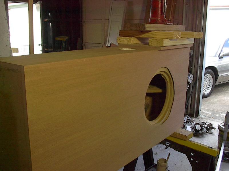

I sometimes use a 12 ton bottle jack with 2x4's as spreaders to apply pressure when laminating 2 3/4" boards. Add 1 or 2 small nails with the head clipped off almost flush to keep the boards from slipping under the presure. This litle trick lets you put too much glue and squeeze out extra so there are no voids between.
The red jack is bearing on the ceiling joist (lifting the ceiling about 1")
