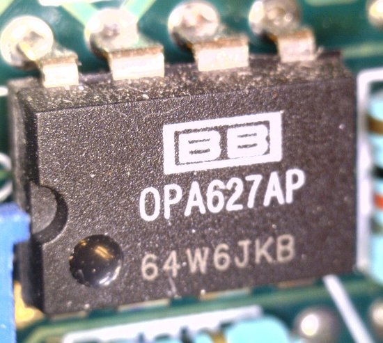

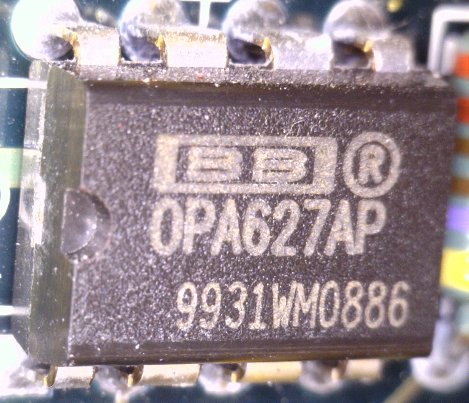

And now for some photographs of genuine OPA627APs from several vintages.
The first picture is a OPA627AP mounted on a board we use as a reference ("golden board"). This board was assembled in 2000 and the IC itself is presumably from 1999 week 31.

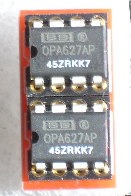

The second picture is from another golden board assembled in 2006. The LTC-scheme has changed to what is looks like nowadays and is probably the result of TI taking over BB. IC from 2006 month 4.

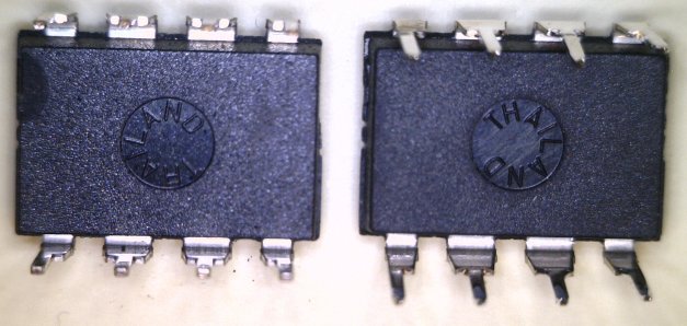

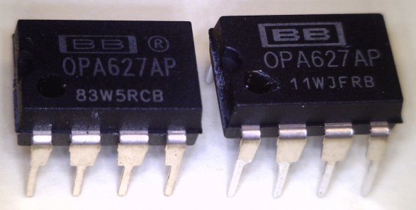

The last two pictures are from current production in Thailand. The one on the left is what the OPA627 on the left (2008 month 3) looked like until 2009. Since then, they look like the one on the right (2011 month 1). This also goes for the OPA627BP.
Buying online from eBay or other unconfirmed sources is risky with these expensive and therefore counterfeit prone components. Even if you have an opamp that looks similar to one of the pictures, that is no guarantee it is.
I posted these not only as a guideline what to look for but also as a warning not to judge genuineness by looks alone because, as you can see, looks change over time.

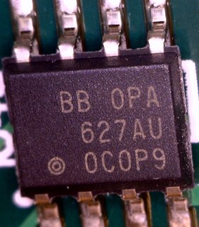

Here is a picture of a OPA627AU and soon I'll complete this thread with some OPA627AMs, a version we've also had a counterfeit batch from.

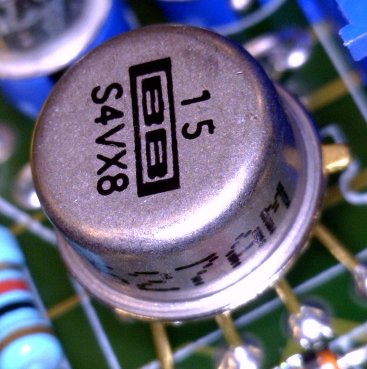

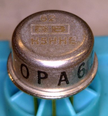

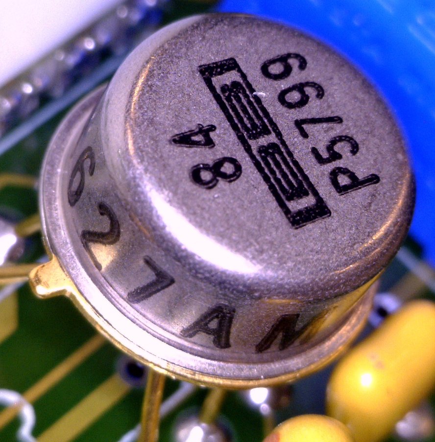

Now for some pictures of several vintages of the AM version.
Since TI/BB changed the status for this version from "Active" to "NRND" (Not Recommended for New Design) availability became an issue. They are still out there, but not always abundantly available. I guess TI/BB nowadays produces them only when demand is sufficient.
Because of this all except one of the products of our customer(s) no longer use the AM version. Despite that, I still have quite a few pictures.
The first two pictures are from a small stock I keep in my desk for repair. They're old, so the first one is probably from 2001 month 3, note that the encircled R is still present.
The second picture shows one from 2006 month 2, the encircled R is not present anymore and the printing on the side is slightly bigger.
A somewhat more recent vintage is in the third picture, this one is from 2008 month 4, etching on top has been replaced by printing.
The fourth picture is from recently bought OPA627AMs. These are from 2011 month 5. Note the change in font of the printing on the side of the metal can. Pcbs equipped with this particular datecode have not yet been tested, but since they come from an authorized distributor I assume they're genuine and won't present any problems.
Note the features of the metal can. They're not very shiny and the radius of the bend of the can is not very sharp. The leads and the pin8-tab are gold plated. Counterfeits probably lack these characteristics, the counterfeit batch we received a few years ago certainly did.

As long as I've been dealing with the OPA627AP/BP, and that's at least five years, they have without fail been from one factory in Thailand. The lot trace code since TI took over BB has been in this format: YMLLLLS.
Y = Year
M = Month (1..9 = Jan..Sep; A..C = Oct..Dec)
LLLL= lot code
S = Site of manufacture.
Each and every genuine OPA627AP/BP I've seen has W as the first letter in the lot code and B in de site code. Just look at the pictures of all AP/BPs I posted (with the exception of the first picture in post #8, that AP was made when BB wasn't owned by TI yet).
This leads me te believe that the factory in Thailand is the only factory in the world that has been producing the OPA627AP/BP for the past five years or longer. Now I'm not 100% sure of this, but after having seen at least 3000 OPA627BPs, I have yet to see another sitecode than "B" on new OPA627AP/BPs.
