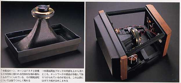

here is impulse response measurement of the horn of the "better looking" auto-correlation measurement
what can be said about it? is it good/bad/mediocre?
is it significantly worse than in case of Summa?
best,
graaf
Its not a good picture, but it looks to be an above average impulse response. What's up with the secret test data? Try and stump the expert?

oh no :)
rather try and get the expert interested :)
those pictures are taken from that 1984 Japanese "joke" (in the words of Mr Hansen)
I am not sure but I am probably violating copyrights by reproducing them here ;)
below is the image of the measured device
this was their first try, later "Scepter 2002" ( photo reproduced somewhere above) had different waveguide
best,
graaf

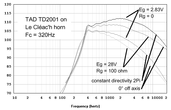

Hello David,
You are right for most part of your reply. The 0° "off axis response" is quite well predicted by Hornresp.
But on your simulation at 0° we can see a difference of level reaching 15dB between 2kHz and 20kHz when in my measurements it is generally no more than 6dB.
Give a look to the responses and waterfall obtained by Jzagaja on the pulse responses I obtained using a current source and a voltage source :
http://www.diyaudio.com/forums/attachment.php?s=&postid=1531292&stamp=1212610725
The original pulse responses can be found in text format attached to messages:
http://www.diyaudio.com/forums/showthread.php?postid=1527765#post1527765
this is with a current source (well in fact a 100ohms series resistor
and
http://www.diyaudio.com/forums/showthread.php?postid=1528568#post1528568
with a voltage source.
You'll find also, attached to that message, a graph resulting from simulations under Hornresp for the constant directivity response and the 0° "off axis" response for both the current source and the voltage source cases.
As we see linearity is increased at low frequency using a current source as we can see also on the measurement.
At high frequency linearity is also increased but the difference between the level at 2kHz and 20kHz is still 2 times larger than on the measurement.
May be that's a question on how the pressure is distributed at high frequency at the output of the phase plug. May be the high frequency favor the inner slots and thus the equivalent diameter of the source at that frequency is smaller.
Another explanation is that, unlike waveguides and largely open horns at the throat, HOM are benefitial to the Le Cléac'h horn. It helps in linearizing the on axis response at high frequency.
This will be somewhat of an irony ... the Le Cleac'h horn HOM friendly...
(But I know someone who'll disagree...)

David McBean said:
Hi Jean-Michel,
Many thanks for the information. I would have thought that the attached on-axis response prediction was reasonably close to the measured response as shown in your Post #922, assuming that the “hole” at 1600 hertz is disregarded.
Am I missing something in the interpretation of your measured results, perhaps?
Kind regards,
David
Hi Jean-Michel,
Many thanks for the additional data. The measured on-axis SPL response of the 320Hz Le Cléac'h horn certainly does seem to hold up very well at high frequencies. Unfortunately there is not much that I can do about it, as far as the Hornresp directivity model is concerned :).
In the attachment to your Post #523 it is interesting that the simulated directivity polar patterns are generally considerably narrower than the measured patterns, which I would have thought would have boosted the predicted on-axis response above that of the measured response at 20000Hz, but apparently this is not the case.
http://www.diyaudio.com/forums/showthread.php?postid=1528921#post1528921
Thanks again for the great info.
Kind regards,
David
Hello David,
Concerning the attached file:
http://www.diyaudio.com/forums/attachment.php?s=&postid=1528921&stamp=1212595234
I did a mistake when regrouping the different individual graphs on a single one (unfortunately, Diyaudio allows only 30 minutes of edition for the messages after it appears on the forum).
As correctly written, the measured directivty curves were obtained by me on a Le CLéac'h horn having a cut-off of 320Hz.
The mistake concerns the 2 sets of curves obtained using Hornresp which are, in fact, related to a Le Cléac'h horn having a cut-off of 160Hz (here the AH160 is simulated). The directivity curves for the waveguide are obtained on a simulation of a OS waveguide having the same length, throat diameter and mouth diameter as the 160Hz Le Cléac'h horn.
As the 160Hz is considerably longer than the 320Hz when using the same 1 inch driver it is not surprising that its directivity is more pronounced in the high frequency.
I should modify the file...
Best regards from Paris, France
Jean-Michel Le Cléac'h
