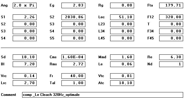

Hello,
Sorry, I was not in Paris during several days.
You'll find in attached file a screenshot from Hornresp to simulate a TD2001 on a Le Cléac'h horn having a Fc = 320Hz.
Also you cab give a look to the message:
http://www.audioasylum.com/forums/hug/messages/12/128658.html
Best regards from Paris, France
Jean-Michel Le Cléac'h

JLH said:Jean-Michel,
A little off-topic here, but could you post the input parameters you use to model the TAD driver in Hornresp? Thank you.
Rgs, JLH
Hello,
The start for the modelisation of the TAD TD2001 driver is obviously Kinoshita and Locanthi's paper in JAES.
JAES convention 1978
preprint N0 1422 (M2)
"The influence of parasitic resonances on comrpession driver loudspeaker preformance".
Then I used a good measurement I did myself of the impedance curve of the TD2001 compression driver on a high quality horn that can be easily simulated (in Hornresp by example) .
In this context high quality horn means first : with very few refelcted waves from mouth to throat as this will be mirrored on the impedance curve.
Then, as you said, an iterative process will lead to the determination of the missing parameters.

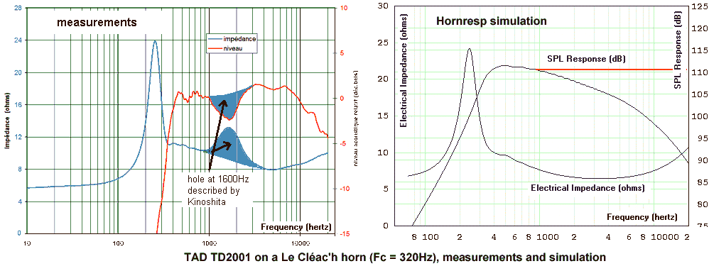

You'll find in attached file, a comparison between the measured impedance curve (and response curve) with the simulated one under Hornresp.

gedlee said:
Getting an accurate set of parameters for a compression driver can be tricky business because virtually no manufacturer supplies enough information to get a good model. You have to do some tests for yourself. The way I do it has worked well for me. ...
Then you can take the back off and run the impedance again. This will give you a better idea of what the parameters are by fitting this - this usually gives you a good idea of wht the rear volume compliance and resistance are.

Jmmlc said:You'll find in attached file, a comparison between the measured impedance curve (and response curve) with the simulated one under Hornresp.
Hi Jean-Michel,
Just out of interest, how close is the 0 degrees off-axis directivity response prediction to the measured SPL response result shown in your attachment? (From the shape of the curve I am guessing that your attachment gives the predicted constant directivity or power response).
Thanks in anticipation.
Kind regards,
David
