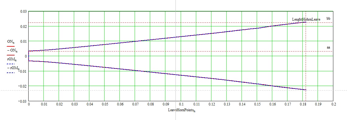

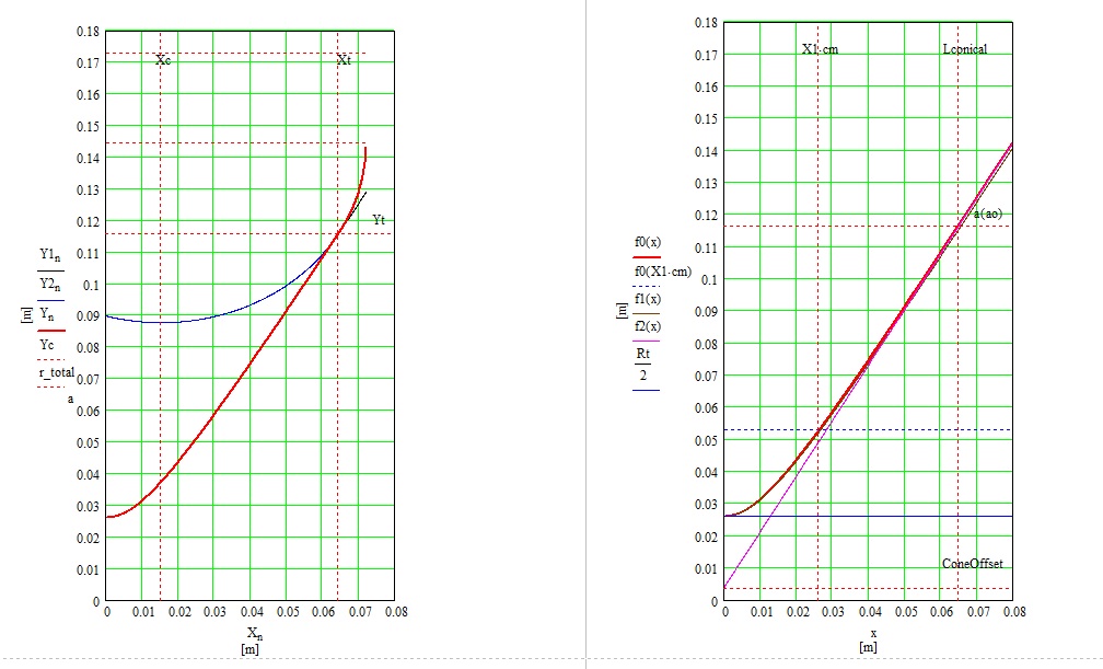

As far I can have some results with shape of the horn
as we discussed here past 2-3 pages...
This is with corrected parameters, suggested by GL and for ka=fib. num(1.6xxx), r rounded is lambda/8, etc etc...
just like example of shape.
I will later extract "leave" for cutting clishe.
And off course post here the math and results

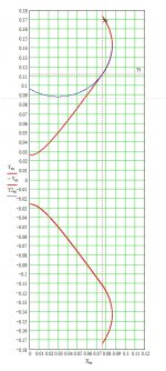

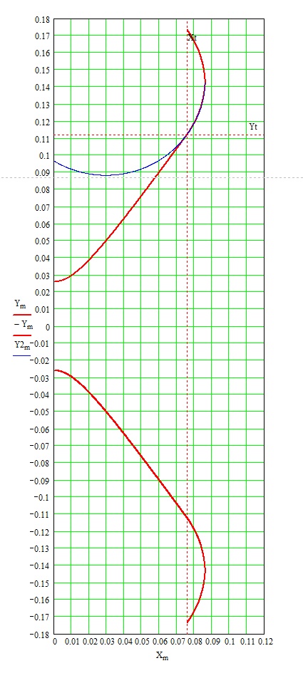

Hi this is example of horn
in zip file is mcd MathCad sheet.
with notes...

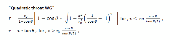

Hi Zoran,
I only wonder myself, when using such "fast flaring" horn (here expectable dispersion angle about 60 deg off-axis) especially when applied to 2" driver that has internally built-in "slow flaring" short horn what kind of diffraction would happen around horn throat.
May be a kind of QT-WG (Peavey Electronics Corporation) 'circular' curve in the throat would produce 'softer' horn-to horn transition.
More details in the US Patent: US6059069
Regards
ivica

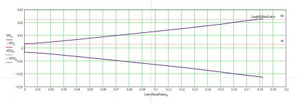

Thankss for the info
I dont use compression unit for this horn
and it is not rectangular rather circular because of forming shape from 24 pieces of "leaves", like old gramophones style...
(pretty much tend to circle...)
on the second pic is one piece of leaves, glued together will give the shape from the pic 1

Hi Zoran,
I think the shape is not important, as Your form is almost circular.
Not using compression driver but something else ( as an example D54), You have to be aware that the "cone" (or dome) must have enough stiffness concerning the horn loading.....but i believe that You have good experience with the driver You decide to use.

Hi Zoran,
A wider waveguide will have HOMs at a much lower frequency, which are in essence the higher amount of diffraction at the throat. The QT would be worse in this regard than an OS. The QT was "invented" simply because at the time Charley Hughes could not draw an OS contour in his drawing package so he just used a "fillet". Basically it is a compromise to the OS and the OS should always be used if at all possible.
Hi Gedlee,
Does that mean that it would not be good to "insist on" the wider horn dispersion over say 30 ~ 45 deg off-axis dispersion?
That is an opposite way then nowadays leading flag in the "small horn" wide frequency JBL M2 horn suggest. Does that mean that at the JBL, while designing M2 horn the payed less their attention on the HOMs in order to allow 60 deg off-axis dispersion at very high frequency (over 15kHz)?
Interestingly for me is that OSWG is based on the quite different philosophy then JMMLC design suggestion. Does that mean that such design ( I can call it almost constant angular increment of the horn walls) would emphasize HOMs and diffraction?
Regards
Ivica
Maybe "insist" is too strong a word, but prefer is certainly the case. From my work 45 degrees seems to be the sweet spot. Wider has more HOM but narrower becomes too long and hard to package.
I cannot comment on what JBL engineers are doing. I don't do things the same way. My reasons are clearly stated by me and supported with measurements. I have not seen comparable measurements of the M2 horn.
The OSWG and the JMMLC are indeed quite different. The OSWG will have the lowest HOMs of any shape. The JMMLC is also not a constant directivity device. Its designer claimed that wasn't important. We obviously had different goals in mind.
