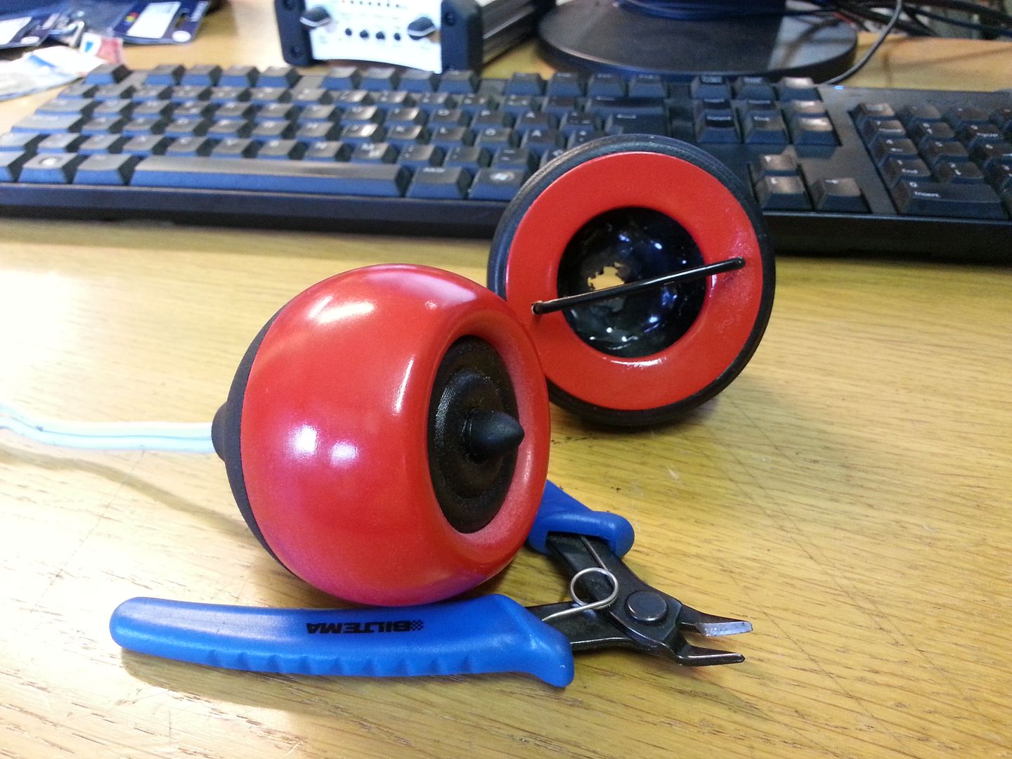

But if adding a sphere shape around your "pipes" would "straighten out" the frequency response it would be worth the trouble, right?
I know it was just a proof of concept, but maybe another test with a Styrofoam sphere around the pipes would be worth testing? Just to see if the frequency response would level out...
You have to realize that in order for the concept of the large radiating surface on a relatively small baffle to work, the baffle really can't be too big. The ideal would be a piston in free air, but without the back-front cancellation.
Adding a radius would make the baffle as a whole larger. The larger you make the circular baffle, the more the system resembles a single point source on a circular baffle, which is pretty much a worst case scenario. Therefore you have to ask yourself, what can be gained by adding the radius? The radius would have to be pretty large to be effective below 2k1 (where I put the crossover in my system). For that reason I think a radius might do more harm than good in this particular case.
So what exactly is worst case on the sphere I suggested?
But you don't have to try of coarse . A ~ 10 cm sphere would be enough for your tweeter, how hard is that?
