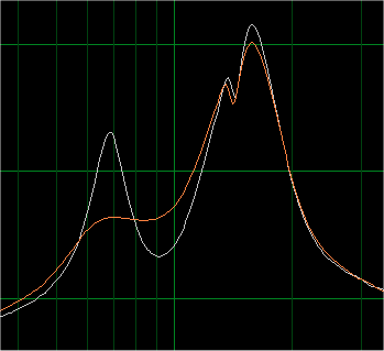

I am trying to do something about throat reactance, trying to damp it by stuffing the throat with dacron. I am not sure whether I'll like it, but this impedance plot seems to indicate something useful.

The dacron extended part way towards the mouth but with a higher density in the throat region. Upon listening, all sounded ok. My attention was turned toward the upper bass, and I assumed the CD was now revealing a new level of woofer issues.
However after an hours listening and experimental EQing, I became stuck on the lower midrange and it seemed to become apparent that the dacron is improving performance in the area of HOM reduction, maybe indicating that my previous foam was not of an adequate density. At the same time the horn seems to be congested (mistuned?) near its bottom end.
I may be misguided but when I think about the effect of not annulling the reactance on a regular horn, and the fact that my waveguides are not perfect and I have little control over the rear chamber I thought that turning the throat resistive would be worth trying. I wish I had a deeper mathematical understanding.
I am assuming that with the ideal OS, the point is moot. For myself, I have three issues of concern with my early contour....but I am now thinking I should let it all happen and then deal separately with the HOM.
