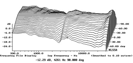

IMHO, the main advantage of a waveguide driven by a ribbon is great CSD, and potentially better extension. In other words, a compression driver will get louder, and it will handle more power, but the compression driver doesn't have that awesome CSD that you get with a ribbon, and the simplicity of a ribbon can sometimes lead to very well behaved output in the top octave.
Or to put it simply, "ribbons are clean."

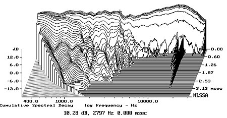

Here's the CSD and directivity of the Aeriel 20T V2. It costs thirty two thousand dollars and uses a waveguide-loaded ribbon. Note how clean the CSD is, and how the on and off-axis energy is consistent.
For comparison's sake, here's the B&C DE250 on a horn, which is a very good compression driver. See how the CSD takes about fives times as long to decay? Those ribbons are fragile, but they are very very light, so the motor of the ribbon exerts tremendous control over them. And you see that in the CSD.
(When you compare the two measurements, note that Brandon's scale is twice as tall as John Atkinson's.)

And John, I simply don't see the huge difference is CSD that you see except for a couple of resonances which I suspect are not the driver. I don't do CSD because I don't see them as all that relavent, but suspect that your Summas have a CSD much like that of the ribbons, but with much better directivity, much higher power and efficiency and all at a much lower cost.

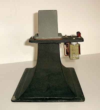

early seventies stuf.FWIW, I think ribbons in waveguides is a great idea. The only downside with my Neopro5i ribbons is the vertical drop even 10deg off axis. To have better control of their directivity is a bonus. IMO there isnt a CD that sounds as good for me has my ribbon designs in the 2KHz to 20KHz range. I have tried to find one including TAD CDs but still for critical music listening Ribbons rule.
Ribbon Tweeter Horn Loudspeaker: Decca London/Stanley Kelly - Efficiency, Size, Filter and Frequency Response.
