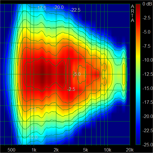

I'd like a little help on doing some polars.
The background story is that I suspected waveguide problems below 1kHz and I changed the crossover to 1,100Hz and from first order to second order electrical.
The result is greater coherence just below 1kHz but worse matching now and the tweeter stands out with a slightly harsh quality. I am still playing with listening axis phase.
I have two goals for taking the polars. One is to verify the polar matching of the separate crossed drivers which I intend to do by going horizontally. The other goal is to verify that power response is not compromised by phase anomalies which I intend to do by measuring vertically.

Hi AllenB
Don't swing the mic, rotate the speaker. Setup the speaker to mic situation to best utilize the space - usually across the diagonal. Use the greatest speaker to mic distance possible while maximizing the time delay to the first reflection. Of course the speaker has to be on a stand, so you may as well have the top plate rotate and mark the angles on it. I would go to 90 degrees. Horizontal is most important, so get that right. Vertical is less important, you just need to know that the forward lobe is centered - so out to maybe 30 degrees vertical is fine. Horizontal should be symmetric so you only need to do one side. Vertical will not be symmetrical.

3/is this (below) a matter of mouth termination? (I normalised this otherwise it wasn't obvious.)

If you have a "true" impulse response - from Holm or anything else - then you have the phase as well. It is part of the impulse response and nothing else need be calculated (beyond doing an FFT). By "true" I mean an impulse that is created by convolution and not from a magnitude only frequency response. I do not know what ARTA does, but I know that Holm is "true".
Since your data plot is normalized, there is no way to tell for sure, thats why I never normalize. I would guess at "yes", but I would need to see the data unormalized to be sure. I simply do not understand why people normalize the data because it makes it less useful, not more.

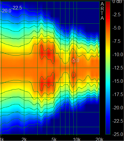

In my case because it looked similar to something I'd seen before. Here is the straight sonogram.

It doesn't require two channels if you somehow know the input waveform. Holm does not require two channels and it does phase. Thats because it knows exactly the signal that it sent out, so it can do the deconvolution with a reconstruction of this signal.
The 1.5 kHz is a resonance, probably in the driver. The narrowing at 2 kHz is probably because the waveguide is too small. The stuff above 2-3 kHz is typical mouth diffraction aberations.

Earl, I have short term plans to increase the roundover radius and maybe incorporate a 'supra baffle' as planet10 calls them. I suspect the other problems will EQ out (largely, anyhow).
