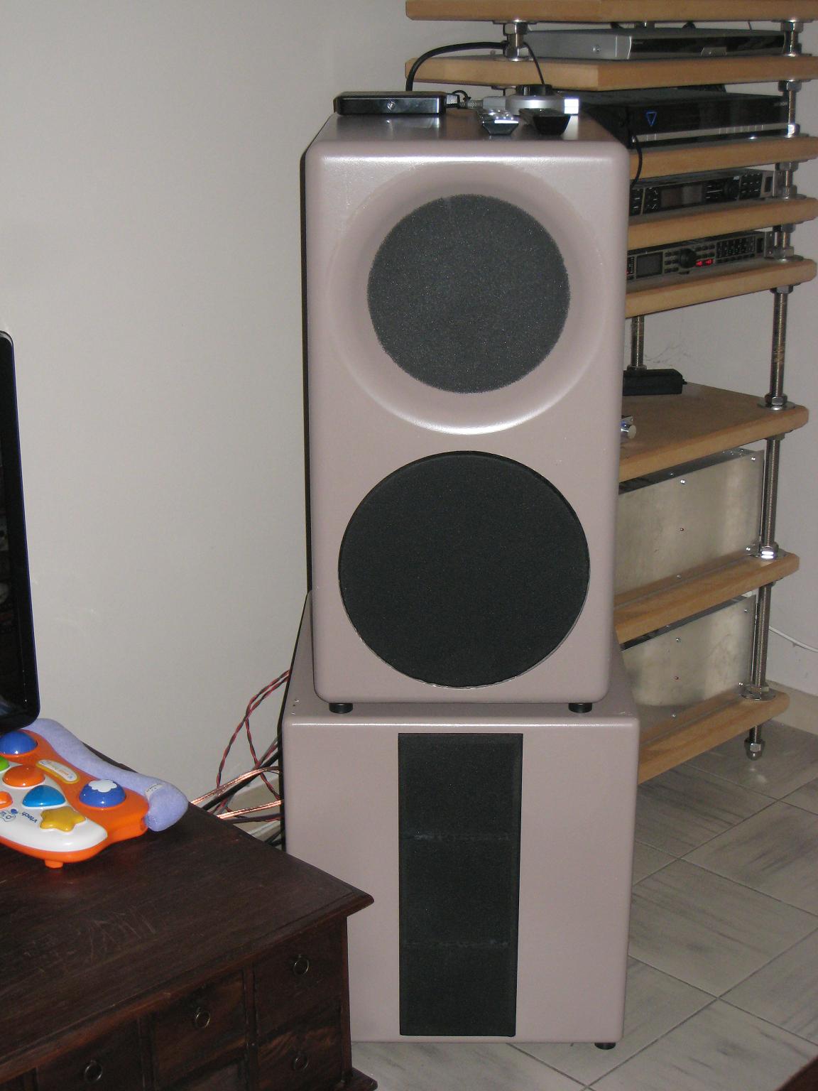

Hello Marcel,
Verynice speakers! The design looks familiar J
I am also using a 12” waveguide with foam plug, but I bought my waveguides from Earl. So far I have been very satisfied by these (now listening to these speakers almost 8 months).
I did not experiment without foam, I immediately glued the foam plug in (it is already time consuming to optimize the cross-over for 1 configuration, I did not want to do it twice…)
So far these have been the best speakers I have ever had, and there is still room for improvement in my cross-over. Currently I am building an automated rotary table to make the polar plots less time-consuming.
I am aware the subs are not in the ideal location (especially because I have only 2 subs), but they are so big there is no other suitable location in the room (both subs contain 2 x 18” speakers in a W-baffle) In the future I will probably build some additional small subs, but for now I am already very satisfied with the results.
At this point I also want to thank Earl for all his time he spent trying to educate us, even if some students just do not want to listen… I hope he can keep up this good work and make lots of new developments (I am still hoping for a CD with an optimized phase plug for the waveguide…)

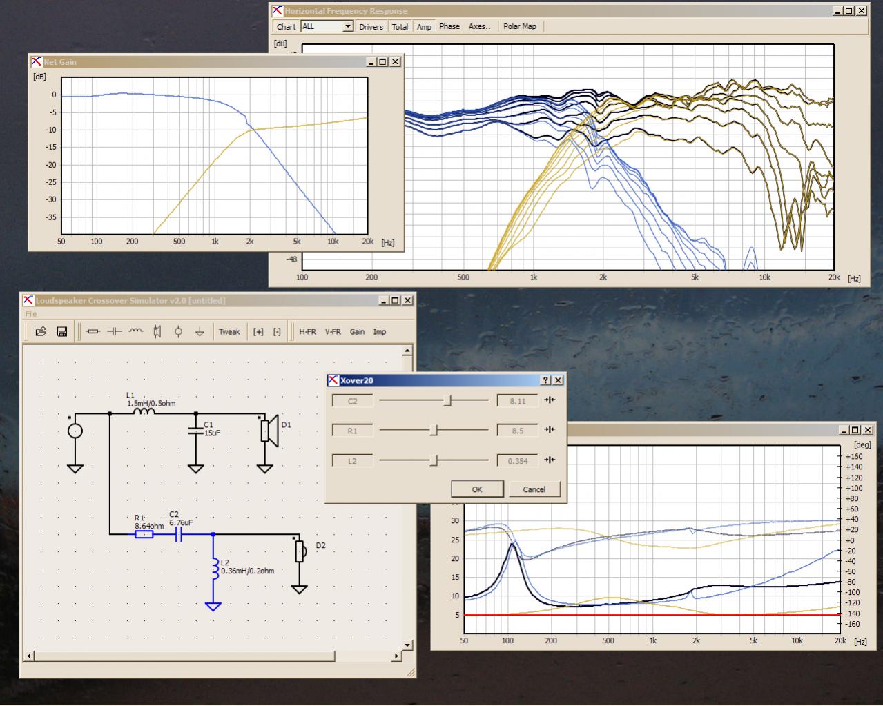

Hi Wim,
once you have data measured, you can easily simulate crossovers for all the polars at once - just use my software. You can even display real-time polar map as you manually shift components values - see my web for free download. I'm currently working on much upgraded and more user-friendly version supporting biquads directly for advanced plugins for miniDSP platform, for example (which is what I have), power response, etc. If anyone is interested, please let me know, I will send you some basic user guide for this (old) version. It can't be much simpler than that once you know what you are doing. Now I can't imagine designing crossover for this kind of loudspeaker without such a tool.
Marcel

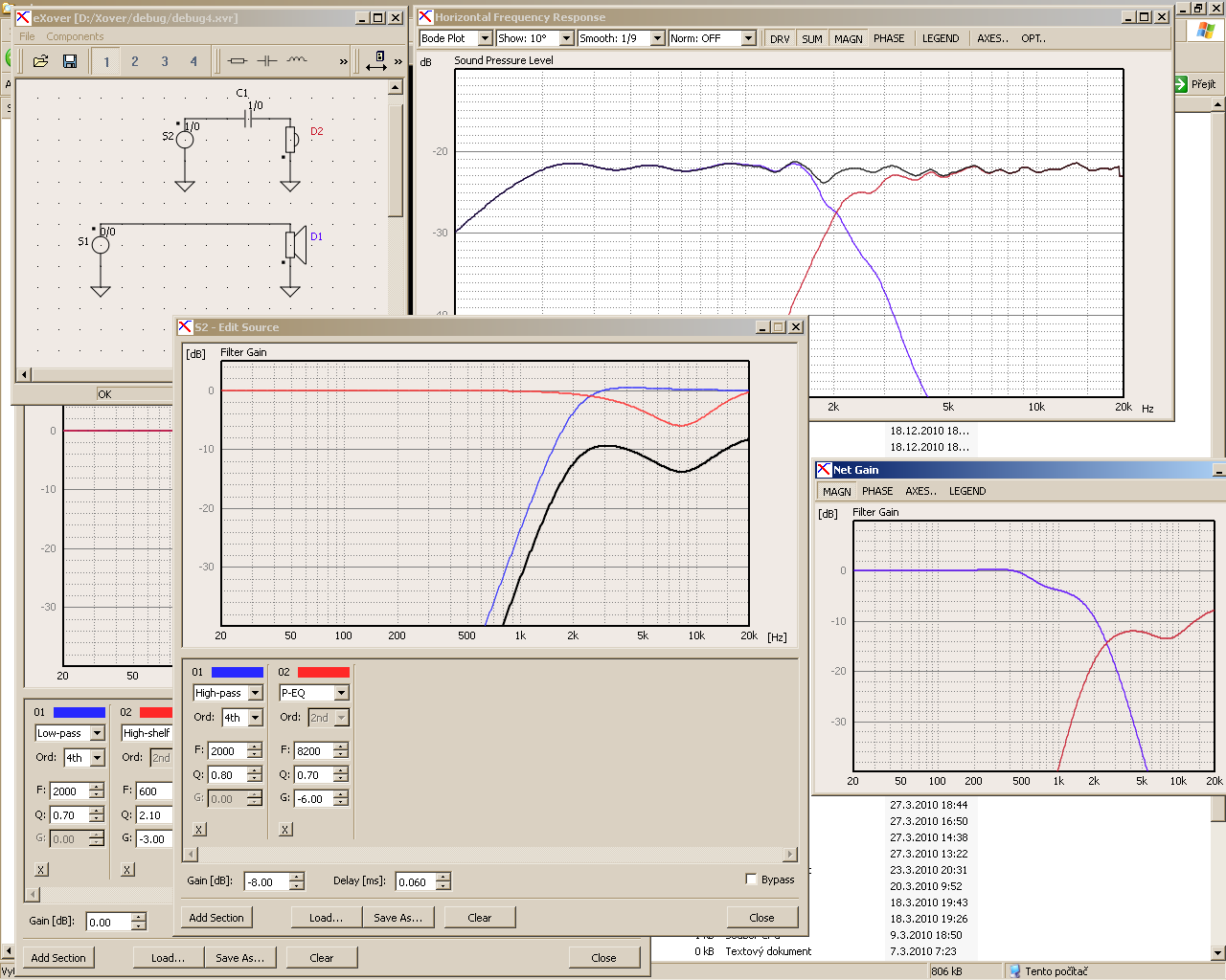

Gentlemen,
I don't feel comfortable discussing this in Earl's thread, just wanted to let know that it is available when Wim wrote about his crossover. Please feel free to register at LoudspeakerSoft Forum where I've prepared dedicated sections to support my software and some related topics. The truth is that I didn't mean to promote this so soon. I still have to complete the new version, documentation, web, etc. It will have much more features and be more stable I hope. Anyway this version can be used freely by whoever wants to.
Power response, or something similar from the data provided, will be calculated in a new version (it won't be free). It won't be miniDSP plugin - just the biquad coeficients that can be entered directly to the standard ("Advanced") miniDSP plugin - in expected text format.
That's all about my stuff for now. Please continue about it at loudspeakers.com. More to come...
Thanks,
Marcel

Hey, its far more interesting and relavent than the nonesense about "CMP".
But if it is going to be commercial software then it probably is not appropriate here.
I have been writting software that is virtually identical to what you have. Mine does everything that yours appears to do except the real time change of the polar plots with a change in value of a component. I just have not gotten arround to that as yet.
Mine does do a polar model to the data which allows me to look at the extreme nearfield as well as the far field from data at any field distance. The extreme nearfield can be used to diagnose where problems are occuring at the source such as diffraction. Its a pretty slick technique, but massively computationally intensive.
What language is the software written in?

Marcel - nice work!
Some of the capabilities you are offering for free are very similar to what Fine X-Over offers for those that can afford it - please check Loudsoft.com
(Webinar: Audio Test and Measurement Webinars page)
I will keep on checking your site to follow the development of such nice and useful tool.
