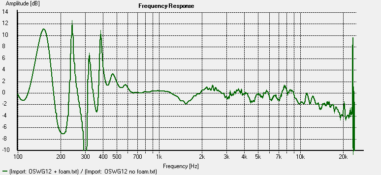

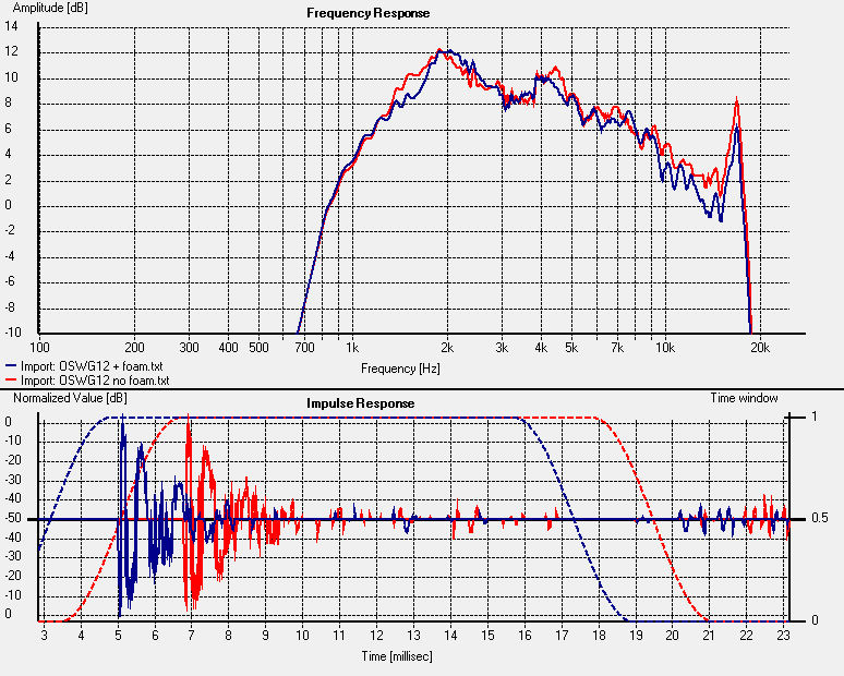

Hi jzagaja,
In your post #5126 you said the following;
“OS 12" with and without foam plug (Bulpren S28190). It seems foam attenuates uniformly.”
And you gave two wavelet graphs, one showing the response without foam and the other with foam.
I’m not 100% sure what you meant by “attenuates uniformly”, but I assumed you meant that the attenuation in SPL due to the addition of the foam plug at 18KHz (relative to say 2KHz) was the same as without the foam plug. Please correct me if my understanding is incorrect.
This seemed strange to me since it is in contradiction with the data that Dr. Geddes has published in the past.
Since I’m not an avid supporter of wavelet graphs showing this type of data, I decided to import the files (from Jmmlc’s post #5132) into HOLMImpulse software as shown below. In order to see the difference between these two responses, I divided the “with foam” response by the “without foam”, also shown below. In this graph, it seems very clear to me that the response is about 4dB down at 18KHz compared to the level at 700Hz.
For the response variations below 700Hz, I would imagine that they are probably due to noise, and the smaller ripples in the response above this frequency may be due to diffraction. Regardless of this, I think the results show the trend of attenuation versus frequency much more clearly than the wavelet graphs you posted.
One more thing of interest was that the start of the impulse for the “no foam” response is 2mS longer than that for the “with foam” response, and the level of the “with foam” response is higher than “without foam” over the frequency range of 700Hz to about 1.3KHz. This suggests that the distance between the microphone and waveguide was not the same for the two responses. For the responses shown in the graph below, I set them to the same level at 700Hz. IMO, attention to discrepancies like this can only add credence to the accuracy of the results.
Regards
Peter
