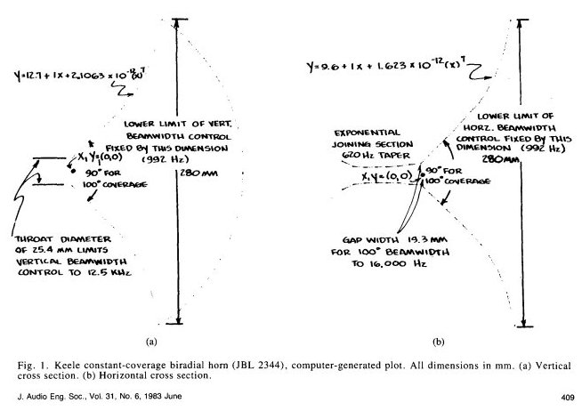

David, in a 2344 or other biradial horns, where would you put foam? I though the diffraction slot would be a good spot.
Dampening of sound radiation is a "time distributed effect" - hence some traveling distance is needed - simply put, you cant place some magic dampening material at a precise position.
besides that - at any spot in space where diffraction happens - meaning where the boundary changes angle along the propagation direction of the wave front - there would be a need to place some magic dampening material *if* you would like to suppress those second sources (according to what you have in mind)- but - those diffraction spots in space are there for a reason - and - if you even got such magic dampening material, it would be of no help as even a transition point into "acoustic non-existence" would create diffraction!
So - to repeat - diffraction can not be avoided - also - its always the same amount of diffraction thats actually happening from any piston sources (or whatever) radiating into 2Pi or 4PI (or whatever).
What *can* be selected though - is the *alignment* of those diffraction points in space - which is nothing else than selecting a different "horn / wave guide / diffraction alignment device" contour.
I'm not experienced with adding foam to horns, so I'm not a good one to ask. It seemed that the curves a few posts back showed that using foam that was open enough to minimize the HF attenuations gave fairly minimal effect on the classic horn problems. As to the effect on HOMs, I'm still new to that subject too.
I can speak a little about the biradial designs. Most of the shape is defined by the beamwidth targets. You specify a vertical coverage and that defines the initial slope of the top and bottom sides. You specify what frequency you want the hroizontal coverage to be good to and that defines the diffraction slot width. At the diffraction slot you apply a lateral cross section based on your target for the horizontal beamwidth.
From the starting point of either contour, Don defined a short power series that created the end flaring, so the starting angle and the end flaring defined both cross sections completely. The only thing left, and the only aspect that is exponential, is from the diffraction slot back, or from compression driver exit up to the slot. Since the back area is fixed (compression driver throat area) and the front area defined by a width you set to determine upper horizontal beamwidth frequency, you have two areas and a length of horn between them. You can define it as exponential but the cuttoff frequency is preordained by your other choices.
So there is a clear tradoff between polar curves and response smoothness. Choose a narrow slot for wide (horizontal) bandwidth and your horn cutoff frequency drops or may even go negative. A low flare rate with insufficient mouth area is a recipe for choppy response.
In the end the art is in finding the right balance of tradeoffs.
(Try the foam in the diffraction slot and send us before and after curves.)

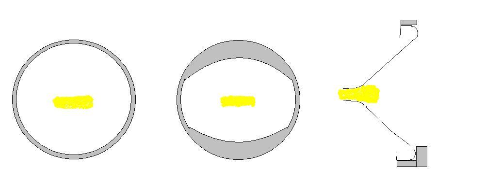

I use a small piece of reticulated foam in the throat that proceeds to the early portion of the conical, in my OSWGs. This is very much like the CD-slot section, and I'd expect you'll have good results in that location (going until just a little bit past the slot).
One of the problems with "stuffing the throat" is that it is not a good idea to compress the foam in place. This makes it denser in unpredictable ways. My plugs are not compressed in any way, they just sit in the opening - glued in. Shaping the foam for a to fit like this in the throat would be a problem to cut since there is a lot of currvature there. Thats another reason why I avoid the throat.
