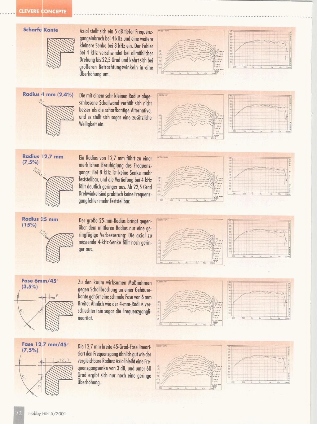

Do you have any analysis data to show? Or is this just a "gut feeling" type of design?When we get decent compression driver (Monacor MRD-160 or STX DT800Ti) we will post performance. That is correct we cut MDF flange for particular driver. We will also provide waveguide integrated with a box like this one (under development).
"Well this baffle must be nice rather than diffraction friendly."
It could be both if the radii were different, assuming the sharp edge were radiused.
Hi jzagaja,
I agree with noah. Not so much change is needed, and you keep the good looks (which I agree is also very important).
I still can't figure out, is diffraction really audible? If it is, then how is it perceived? what should I listen for in a sound? Some people say it affects imaging, I have not found it to be the case. Free air small waveguide images the same as one flush mounted in a baffle.
Everything in my experience indicates that diffraction is audible. Your experiences are not the same as my experiences, but maybe that's because your test used "small" waveguides. I would describe it as blurring the image and making the speakers themselves not "disappear". With low diffraction the image is very solid and the speakers simply disappear.
Be aware that some other effects might mask diffraction audibility. However, it is measurable.I still can't figure out, is diffraction really audible? If it is, then how is it perceived? what should I listen for in a sound? Some people say it affects imaging, I have not found it to be the case. Free air small waveguide images the same as one flush mounted in a baffle.
