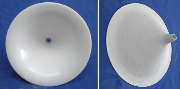

12" OS waveguide is waiting for DIY enthusiasts.
Ex-Moderator R.I.P.
Joined 2005
Well, it is about waveguides, right
You may say its about OS waveguides in general
Throath looks strange and different from OS
But tell us how much it cost
Would be relevant to judge what kind of thing this is
But when you say "nearest supplier" indicates a stricktly commercial product made fore profit
If so it belong in vendors

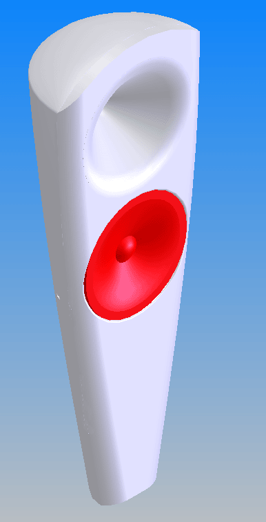

Hello jzagaja,
The top of your cabinet does not look the best choice to me:
- there seems to be a sharp edge => diffraction
- distance between wavequide and this edge remains contant for the top part => effect concentrated at 1 specific frequency (kinda like mounting a round speaker in the center of a round baffle)
In what material will the cabinet be constructed?
