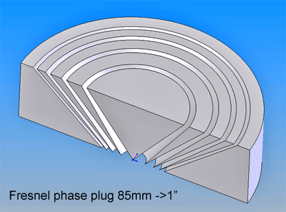

Ok. Mr. Geddes I think I understand. This is how it looks for 85mm flat driver and 1" throat. I'm not sure if unequal paths will work.
Well I'm not gonna comment right or wrong, but the path lengths do need to be of equal length that is certainly true.
Looks like an interesting concept. Anyone doing sims on this? Looks like it could change the power response.Ok. Mr. Geddes I think I understand. This is how it looks for 85mm flat driver and 1" throat. I'm not sure if unequal paths will work.
