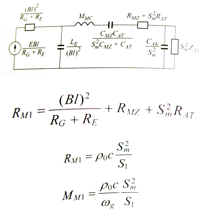

Ok we modeled Gaussian waveguides and with 1 meter mouth we've got 900Hz. Pretty high. Another equation for optimal throat area:
Code:
S = ((Rg+Re)*(ro*c*Sm^2))/(Bl)^2
Rg - source resistance
Re - vc resistance
ro - air density (?)
Sm - membrane area
Bl - force factor
This means that membrane, suspension and rear chamber resonance must be at the middle of a horn bandwidth and Qtc low so that load resistance and (Bl)^2/(Rg+Re) as high as possible. That's old teaching right?

I think thats based on optimal impedance matching for maximum power transfer. Thats not how I would define "optimum".
