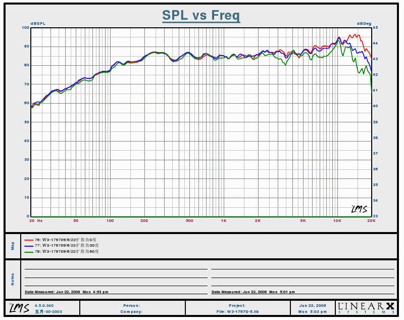

This combo is for my bass guitar
I just bought another pair of horns for the fun of it, and because they were cheap
I will most likely look at better drivers for further experiments with my stereo setup
And no, I have no intention of trying to compete with you
This thing will never be perfect
I diidnt expect other than "piezo-sound", but was very surpriced that it sound much better than expected
All in all, its just about having fun

The waveguide is plain plastic, but it appears to be quite tough
Ofcourse I intend to strengthen it with foam and additional wood
Theres even an aluminium thread insert for the screw mount driver, which I didnt expect at this price
But the design around the troath is far from good
Strange that they dont seem to care much about it
Its a cast design, and it would have been easy to make it more smooth
Its obviously a skilled man who made the proto
But the people who made the mold for casting had no clew at all
So, the throath is pretty much messed up
As said, it will be easy to cut away the screw mount, and mount a plate instead
Maybe a 1.4" will have a better fit
