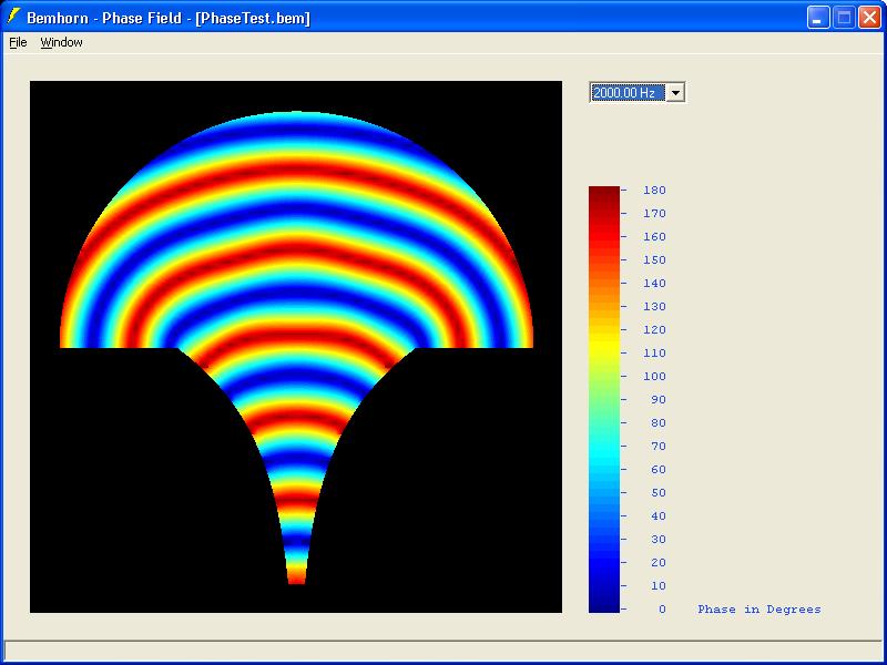

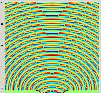

This looks very wierd. However, it is an interesting perspective.
The coarseness of the mesh is causing some serious aliasing, thats why it looks wierd. Its a useless plot because of this coarse mesh.

If you restrict the range to 0-.1 you can get some useful data from the phase plot.
If for instance you use a flat 40mm. Piston then all of the phase wavefronts up to 10kHz. Are circular in form.
This represents the Hermetian limit of solutions to the paraxial wave equation for a flat piston of this diameter, and the wavefronts become non circular above this.

I beleive there is a bug in the way this phase contour is displayed. It's been reported.
Hi soongsc,

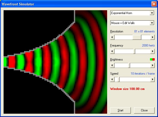

I think you are probably right about there being a bug in the software. I would expect phase contour plots to look more like the following attached exponential horn examples.

I don;t think that this equation is applicable to the problem at hand.
Pure phase plot is going to be different from running a wave. One indicates only phase angle, but the other shows amplitude. Problem with AxiDriver seems to be how it swaps between +/-180 deg, and also display at various scales. The wave lengths and contour just changes. The higher the frequency, the funnier it looks.Hi soongsc,

I agree that the mentioned equation is not directly relavent to the current problem, but I just mentioned it because I found it useful to check that the software is delivering accurate data.
I found the phase plot accurate as far as wavefront goes appart from the ragged looking bits.
These might well be Thom effect artefacts.
